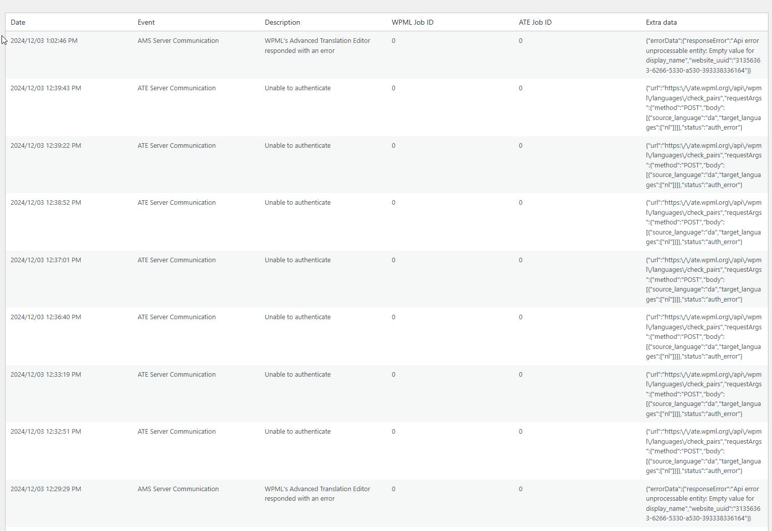

Could you please navigate to WPML -> Support -> Advanced Translation Editor -> Error Logs, and share a screenshot of that page?
Additionally, I noticed that your WP memory limit is set to 40M, while the recommended value is 124M. I suggest increasing the memory limit to see if it resolves the issue.

I have already set WP memory to 128mb, but has not helped. You also get a screenshot of the log here.

Thank you for sharing the screenshot from the Error Log page. There is an error message pointing to an issue with the API response, specifically an "unprocessable entity" error. This occurs because the `display_name` field, which is a required field, is either missing or has been left empty in the data sent to the API. Please try the following steps and check if they helps in solving the issue.
