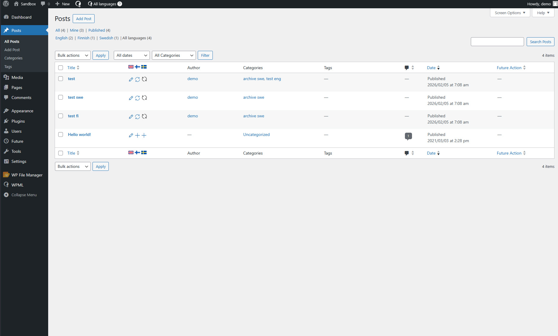

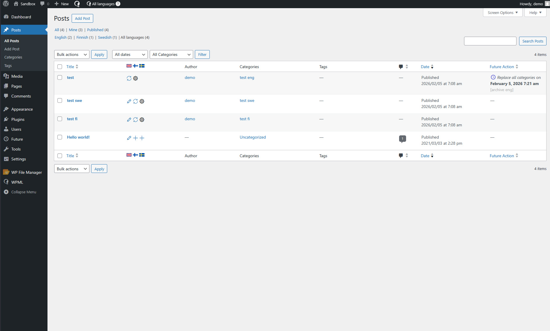

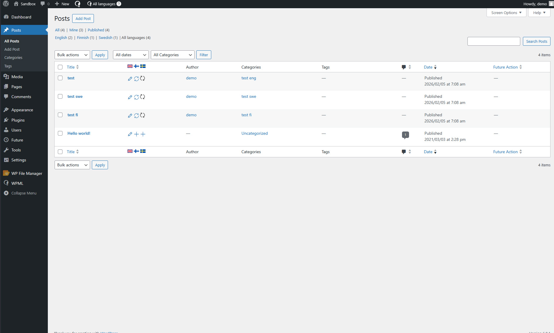

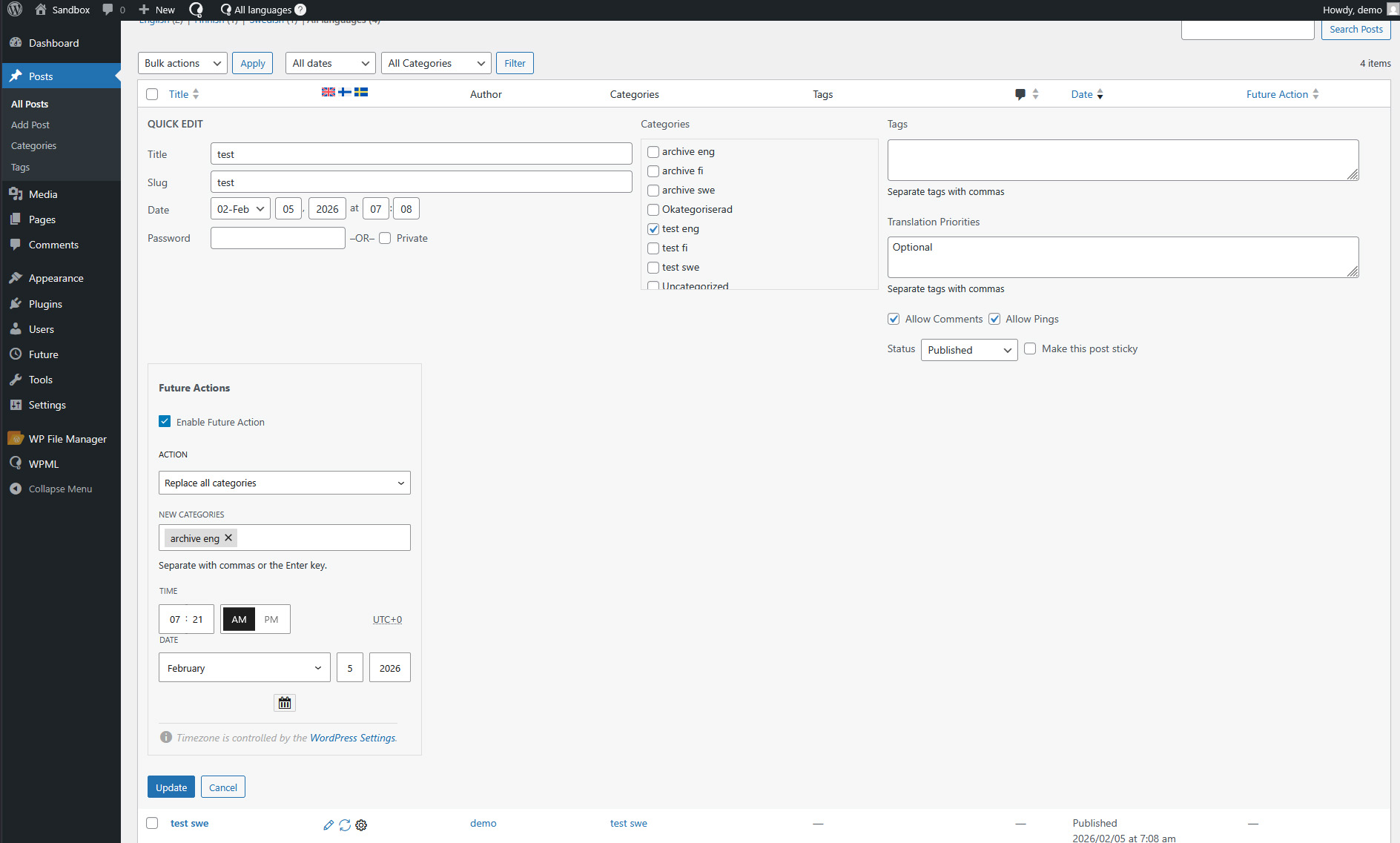

seppoL
Hello!
Thank you for the sandbox.
I don't know if I'm doing this right, but the problem I'm facing still exists in this sandbox. The categories are not saved right with the Future action -plugin.
As you can see, the categories behave oddly. When I activate the delay with future actions, the category is not only wrong, but there exists one extra category (futureaction4.jpg -> "archive swe" AND "test eng")..
Bonus question -> When using Quick edit, the wordpress dashboard needs a refresh when switching categories? The changes are not visible until refresh (shift + F5)
-Seppo

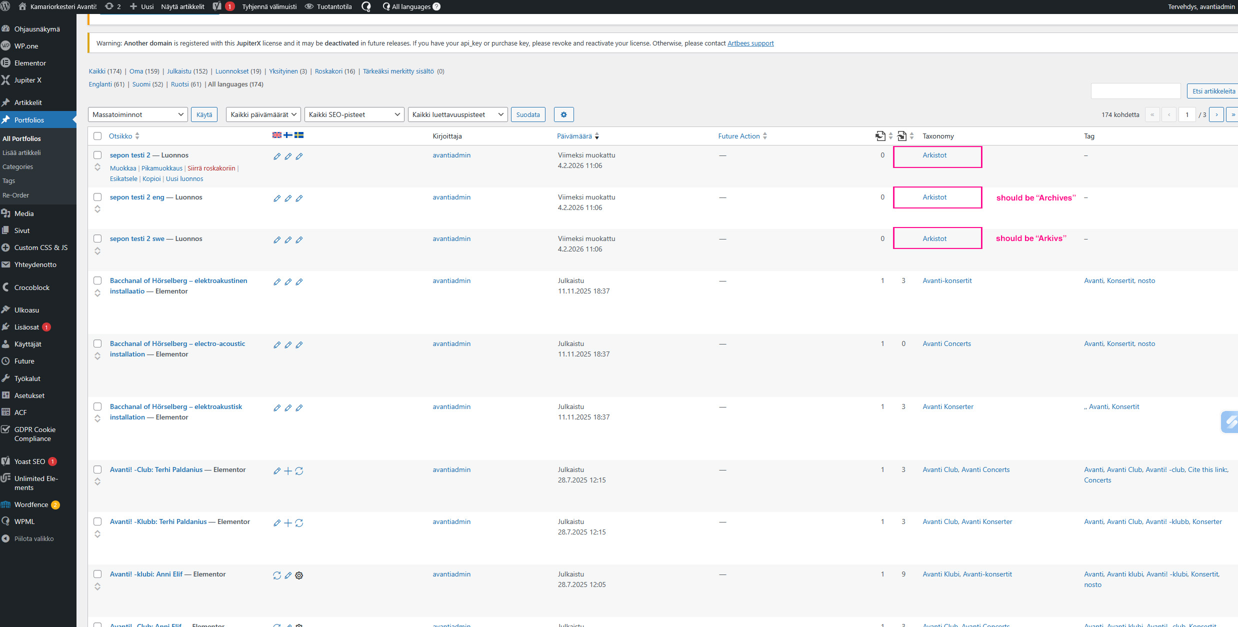

seppoL
Any news from the support team?
For your information (The screenshot)...
-Seppo

Osama Mersal
Thanks for sharing the reply from the Future plugin. Our compatibility team has found a workaround, but we are still testing it. Here is the workaround:
1- Edit ...\wp-content\plugins\post-expirator\src\Framework\WordPress\Models\PostModel.php
2- Find the appendTerms() function and replace it with:
    public function appendTerms($termIDs, $taxonomy)
        $postId = $this->getPostId();
        if ( ! defined('ICL_SITEPRESS_VERSION') ) {
            return wp_set_object_terms($postId , $termIDs, $taxonomy, true);
        $lang = apply_filters('wpml_post_language_details', null, $postId);
        $langCode = $lang['language_code'];
        $termIDs = (array) $termIDs;
        add_filter('wpml_disable_term_adjust_id', '__return_true');
        try {
            $translatedIds = [];
            foreach ($termIDs as $termID) {
                $translatedId = apply_filters('wpml_object_id', (int) $termID, $taxonomy, false, $langCode);
                if ($translatedId) {
                    $translatedIds[] = (int) $translatedId;
            $termIDs = array_values(array_unique($translatedIds));
            return wp_set_object_terms($postId, $termIDs, $taxonomy, true);
        } finally {
            remove_filter('wpml_disable_term_adjust_id', '__return_true');
3- Same thing with the setTerms() function
    public function setTerms($termIDs, $taxonomy)
            return wp_set_object_terms($postId , $termIDs, $taxonomy, false);
        try {
            return wp_set_object_terms($postId, $termIDs, $taxonomy, false);
        } finally {
Osama
