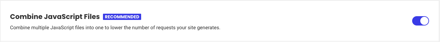

This code in Snippets, how is it different than just disabling the setting "Combine JavaScript Files"?
Right now this "Combine JavaScript Files" setting is turned on, but does it do anything since I now have this code in Snippets?
Regards.

February 20, 2026 at 1:03 pm #17838414
George Botsev
Hello, I am George from second tier support.
My colleague here asked me to respond to your subsequent question.
The problem - at least as I see it - was with the concatenation and minification of inline scripts (in the page contents and not separate files)
The other scripts (which are separate files) will still be minified and concatenated (depends on whether or not you have enabled those settings of course) and the functionality should not be impacted in any other way.
I followed the SiteGround documentation over here: hidden link where they explain that the inline JavaScripts can be excluded in this way.
The plugin does not offer a graphical way of doing this for the scripts added to the contents.
For more information, perhaps you should consult with SiteGround about the inner workings of this code.
