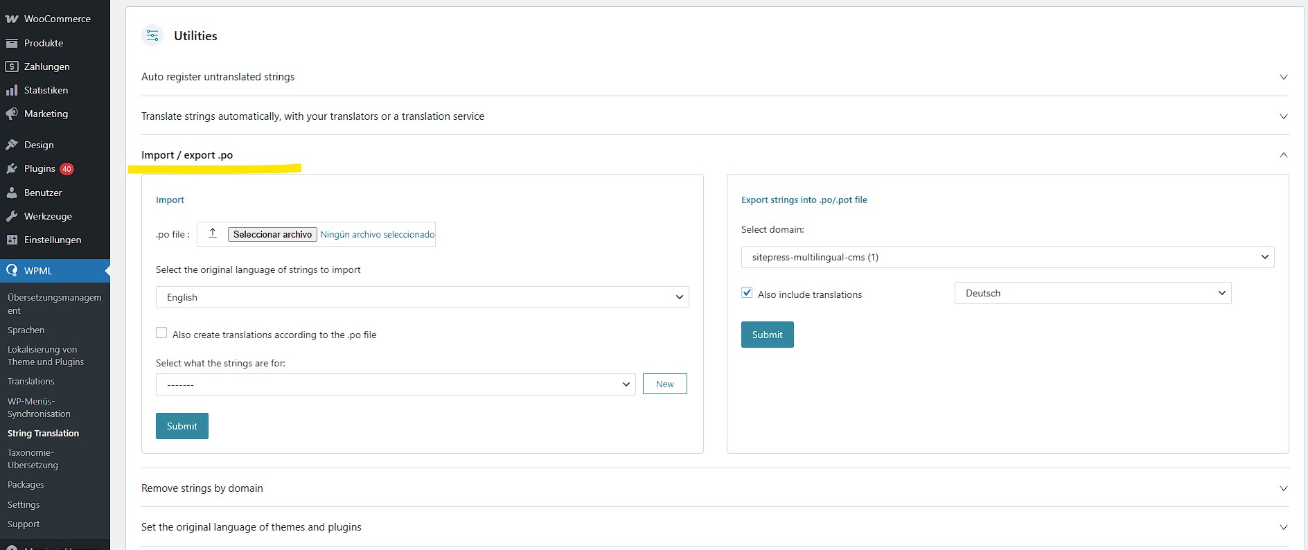

The client is experiencing an issue where WPML's translations are overriding the translations made with Loco Translate for the default language, Norwegian, on their WooCommerce site.
We recommend not using WPML and Loco Translate simultaneously as they perform similar functions and can conflict. To resolve the issue, you can import the .po files created with Loco Translate into WPML. Here's how you can do it:
1. Navigate to WPML > String Translation > Utilities > Import/export .po.
2. Ensure you select the correct original language for the import.
3. If necessary, specify which languages you want to create translations for before proceeding with the import.

May 30, 2025 at 12:02 am #17090151
WPML String Translation does kind of the same thing like Loco Translate which is why it is not recommended to use both plugins at the same time.
You can use the .po files that you created with LocoTranslated and import them into WPML String Translation by going to WPML > String Translation > Utilities > Import /export .po.
Make sure to select the correct original language and if you want to create translations for specific languages before creating the import.

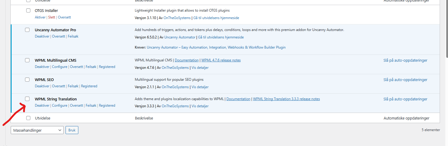

Just to get a deeper understanding:
To transition effectivly from Loco translate to WPML, what is the process?
Any documentation on this, i dont want to do any mistakes here.
Is it to download po from loco then import to wpml,
For all my plugins and themes?
Let me know your recommendations and best practices?
Do you offer any paid migration solution to get this done error-free?

May 30, 2025 at 2:37 pm #17092621
Correct, you can use the language files that you created with LocoTranslated and import them into WPML > String Translation.
Please give this a try.
