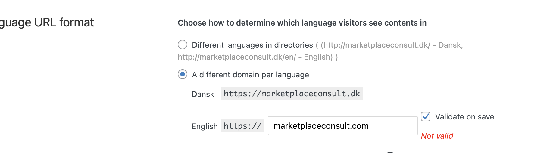

I'm trying to do so that the english language is on our marketplaceconsult.com domain but maybe the DNS is setup right. what do you think? see screenshot
January 24, 2025 at 2:23 pm #16631737
No worries, we understand 🙂
Could you please disable the checkbox for validating the URL and then save the option again?
If this will solve the issue, then please ignore the "Not valid" message. If this does not solve the issue, then there might be an issue with the DNS Settings.
The second domain needs to point to the main site domain.

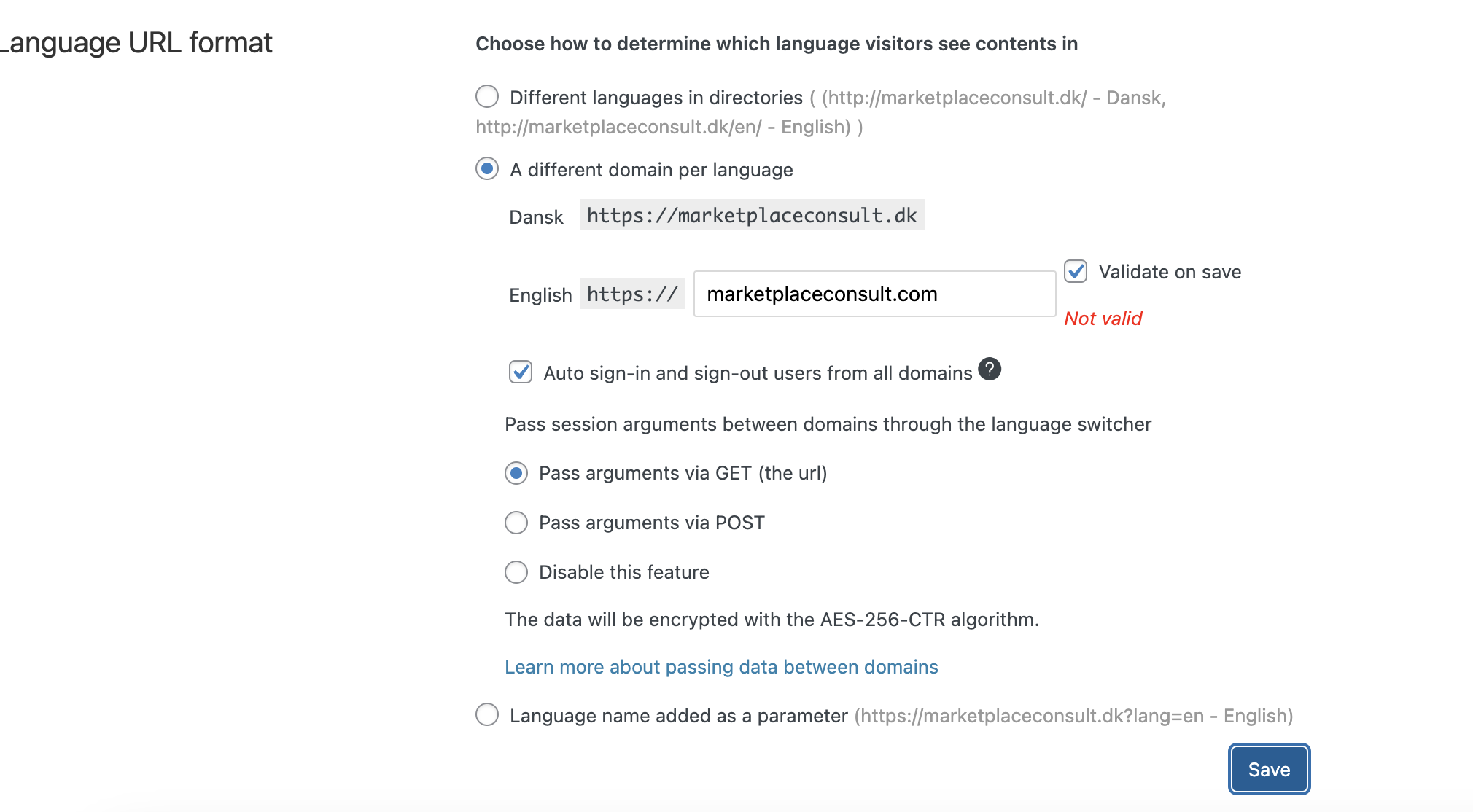

When I try to set up the things in the Language settings, it won't allow me to choose "Different domain per language". I press save and it goes back to "Different languages in directories".
Could you check or what should I do?
January 28, 2025 at 9:17 am #16640460
Disable "Validate on save" and then save the setting.
If this does not solve the issue, please let me know.
January 28, 2025 at 1:23 pm #16641923
tsarinS
It worked now , thanks !
