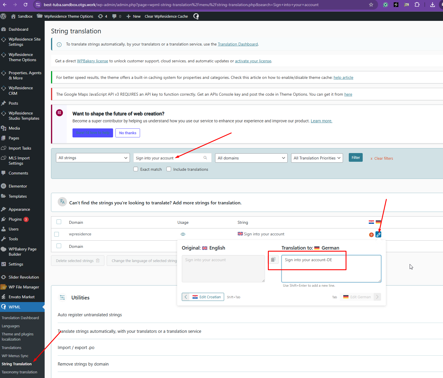

I’ve installed and activated the theme and translated the necessary strings for it to work:
The footer categories issue mentioned at the beginning is also visible here, so the issue has been successfully replicated.

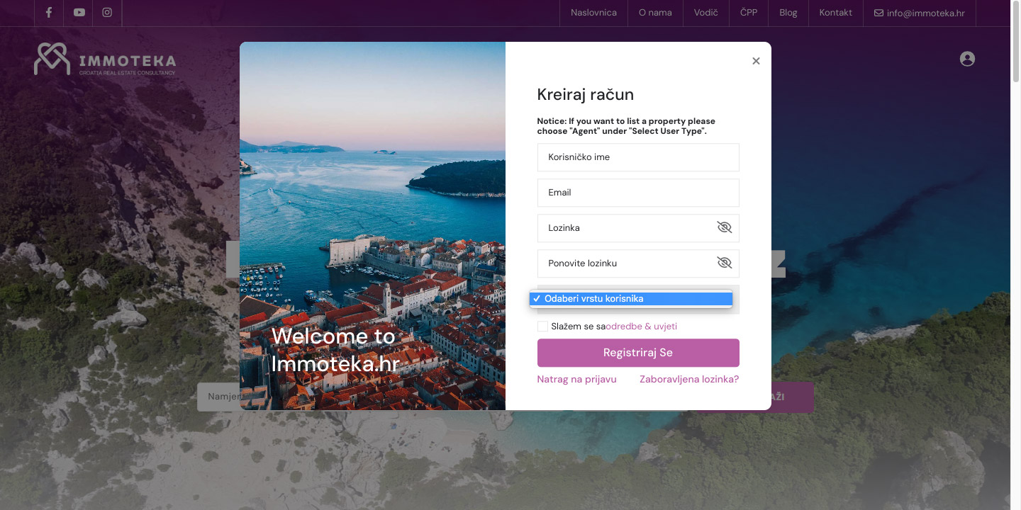

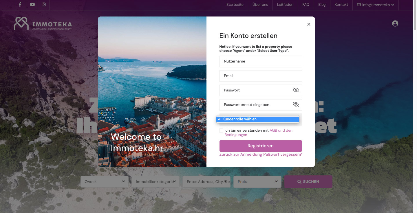

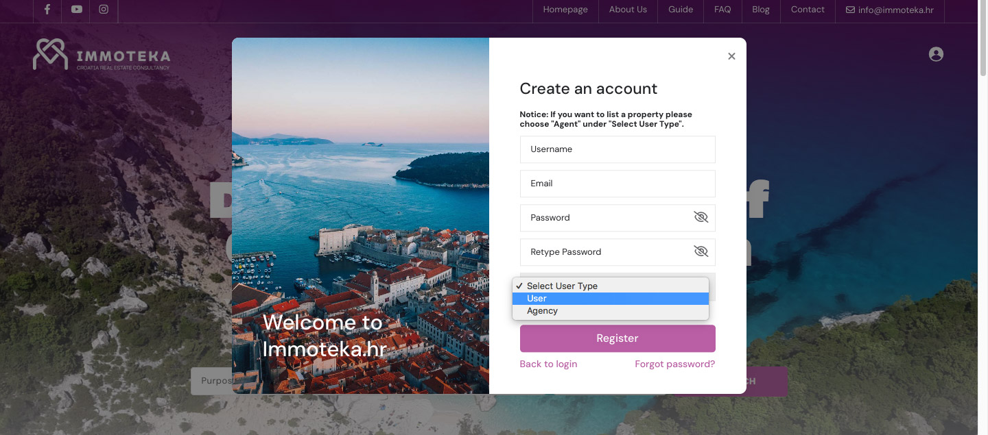

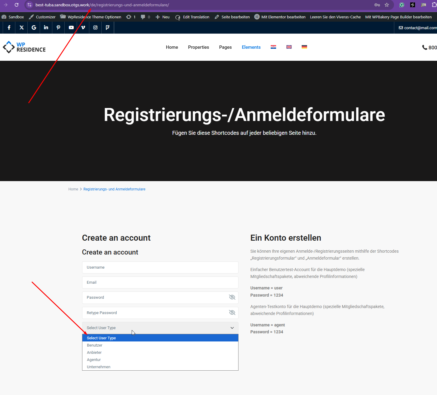

Well, that’s not the issue - the actual issue is with the user types selection in the dropdown menu that I can choose from on the register part of "Login" - Link"Register here".
They don’t appear in any language other than the default one.
This used to work when we delivered the site to the client, but some update or something seems to have reset it.
I’ve attached a few screenshots:
1. Homepage – English – with selectable user types
2. Homepage – Croatian – no visible selectable user types
3. Homepage – German – no visible selectable user types

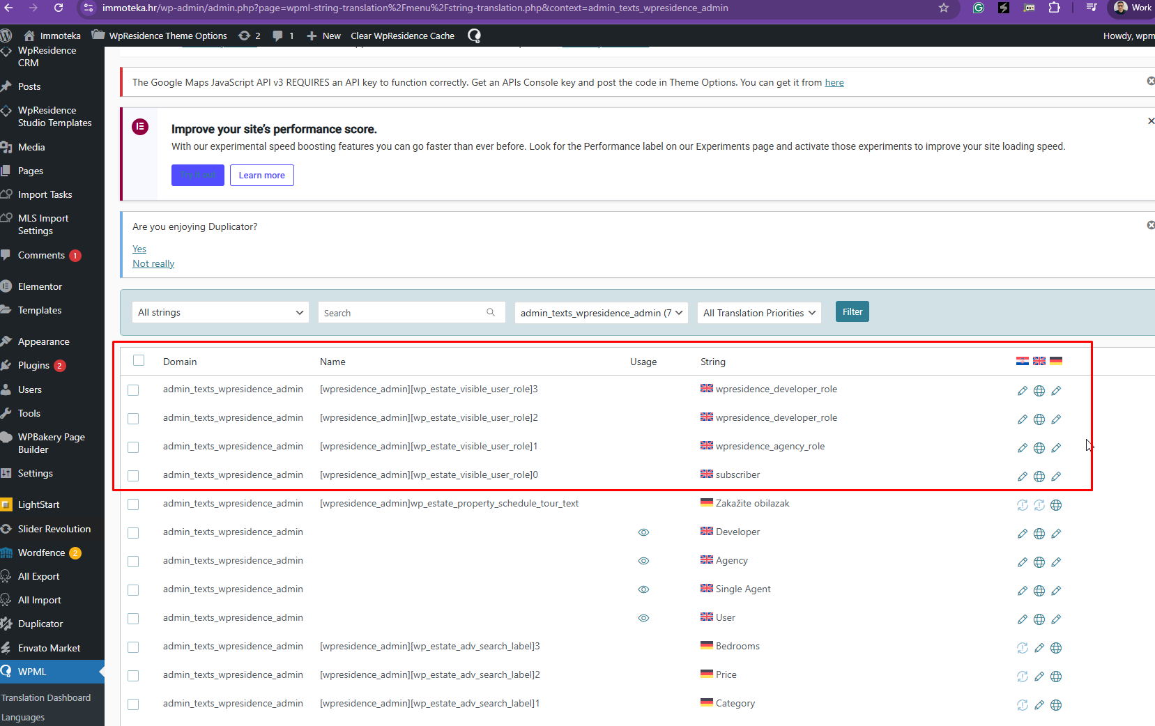

4. Backend – string translation for user types – same setup was used on the sandbox site
November 6, 2025 at 10:03 am #17552869
WPML Supporter since 08/2022
Thanks for your reply. Could you check the sandbox site and let me know if it's working there? I can see the user type selection when I switched to the German language, as shown in the attached screenshot. hidden link

Thanks for your patience. Our 2nd Tier Support has reviewed the issue, and to resolve it, the translations for the admin options shown in the attached screenshot will need to be restored. These options are not meant to be translated.
November 19, 2025 at 8:09 am #17590306
ivanL-30
Great, restoring the strings worked! Thank you!
