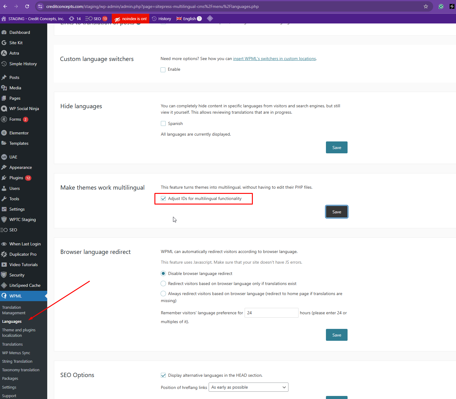

Thanks for your patience. I've enabled the "Adjust IDs for multilingual functionality" option in WPML > Languages and then, cleared cache. Now it shows the correct menu now on the translated page. Could you check?
