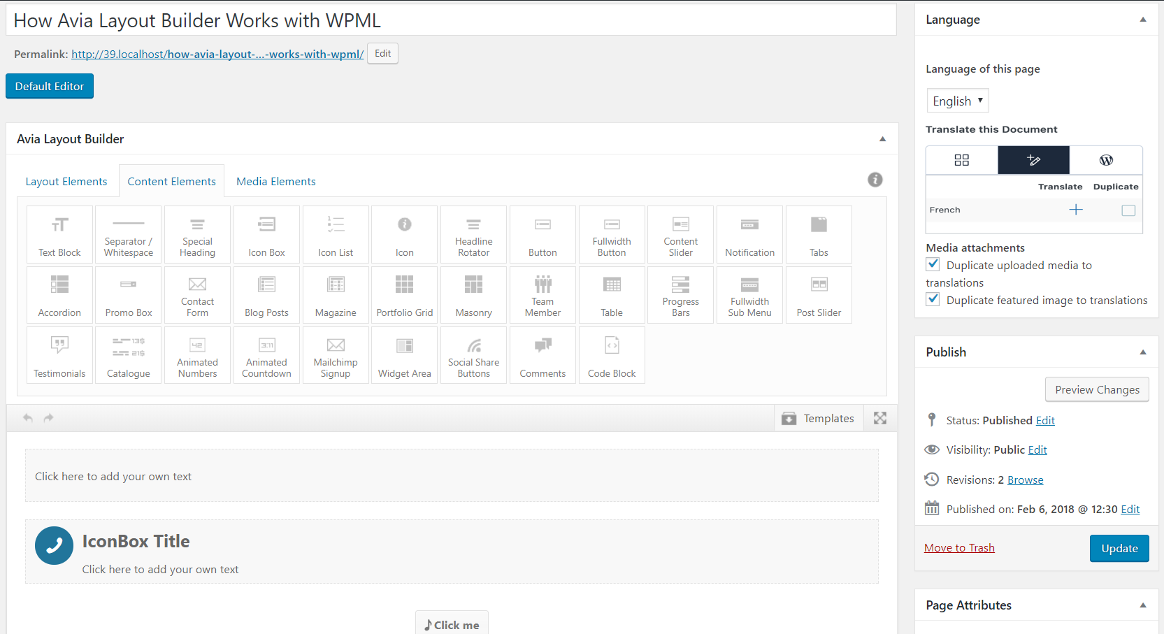

To understand how the Avia Layout Builder works with WPML, let us start by creating a simple page using the Avia Layout Builder. We will include a few modules, such as a Text Block, an Icon Box, and a Button.
A simple page created using the Avia Layout Builder

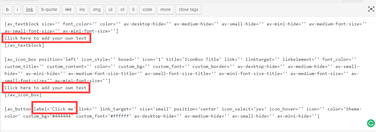

These modules wrap the content in shortcodes:
The shortcodes wrapping the text
To translate the page we created, click on the plus icon found in the language meta-box in the sidebar.
Click on the plus icon to translate a page

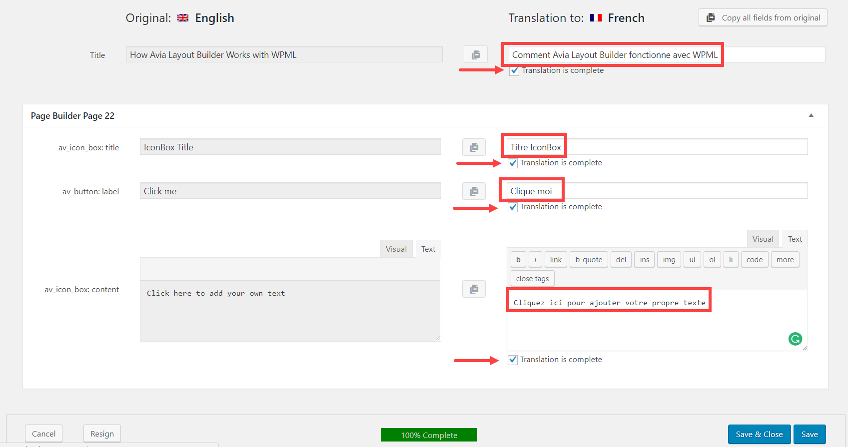

This opens the page in the Advanced Translation Editor where you can translate your page. Add your translations and click Save and Complete.
Translating the page from the Translation Editor screen

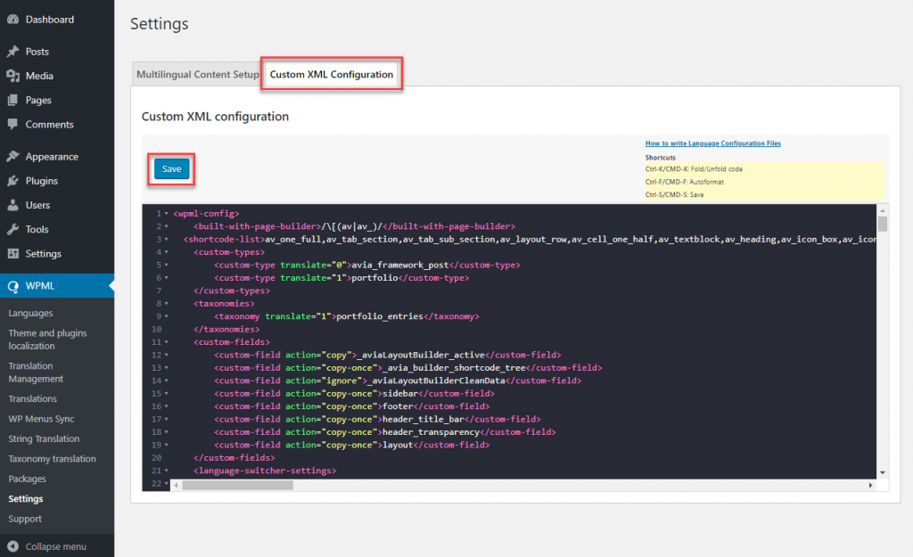

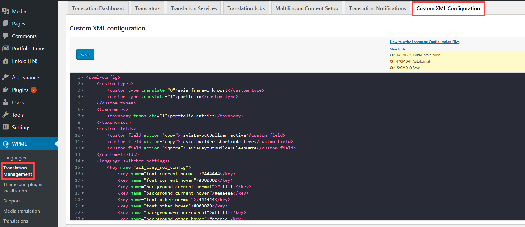

  2. You need to override the remote language configuration file with the updated one. To do this, navigate to WPMLSettings page and click the Custom XML Configuration tab. Copy the content of your updated language configuration file to the editor and click Save.
Overriding the remote language configuration file with the updated one

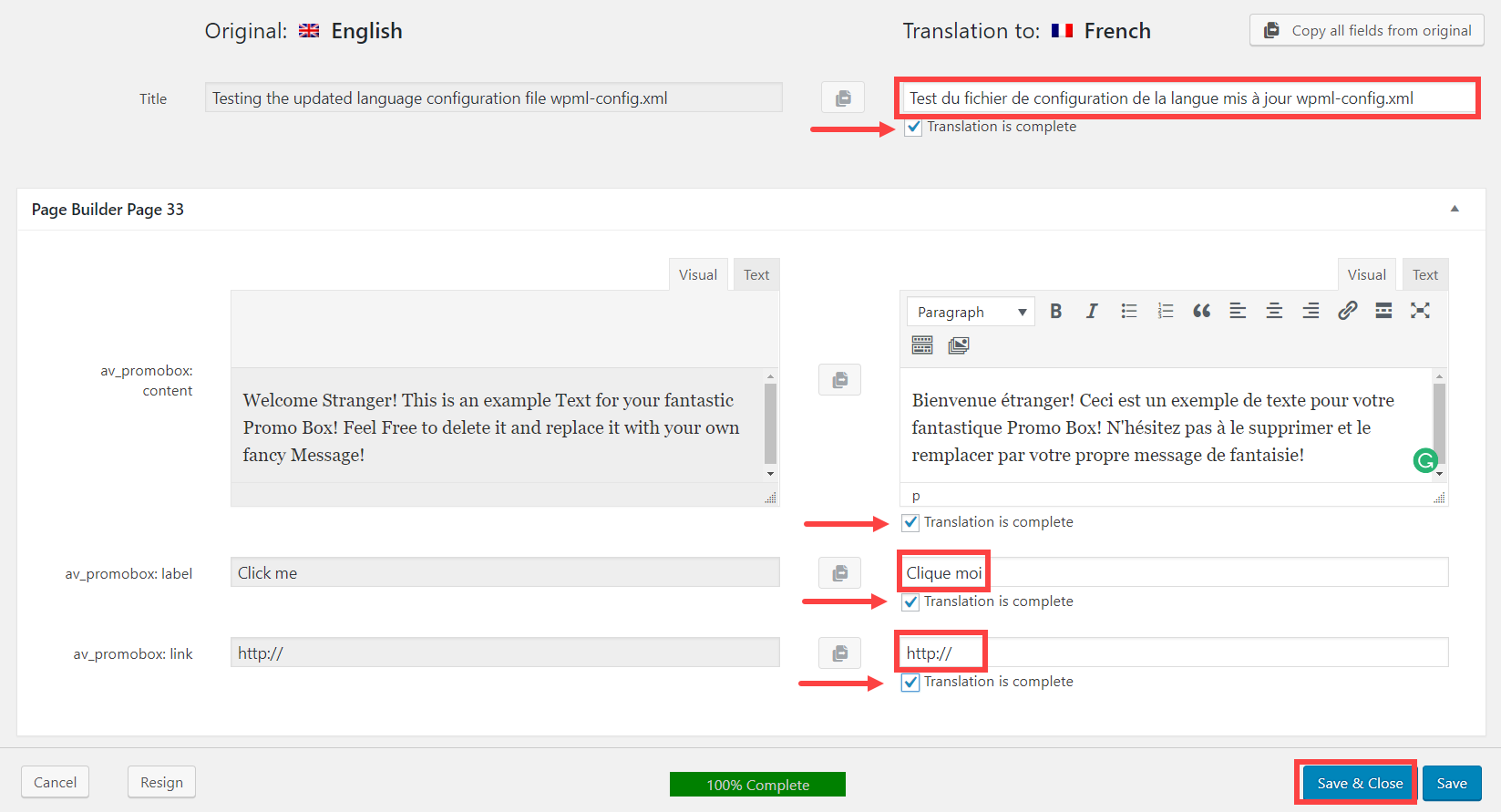

  1. Click on the plus icon to translate the page. This takes you to the Advanced Translation Editor screen.
  2. Ensure that the module’s text is displayed in the Advanced Translation Editor.
  3. Add your translations, then click Save and Complete to save and apply the translations.
Translating text elements as part of testing the updated language file configuration
