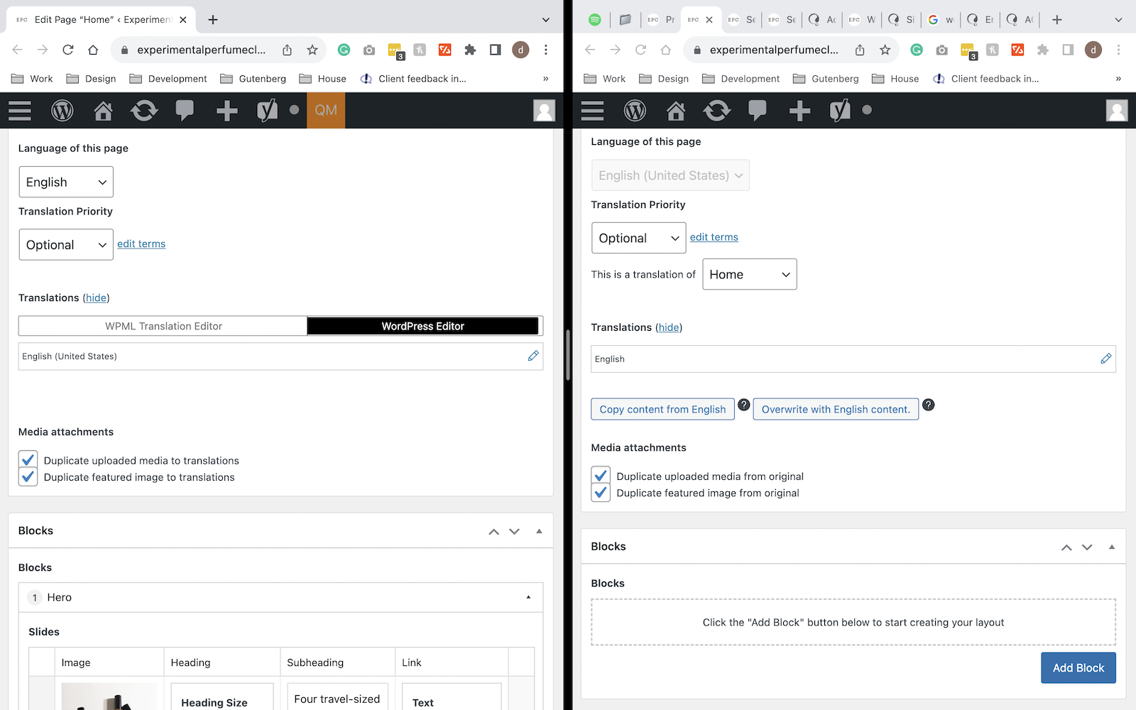

We've setup WPML with the ACF add-on.
When we duplicate a page, the ACF field content isn't duplicated with it. We've also tried clicking the 'Copy content from english' option but this isn't copying the ACF fields either.
The 1st language is English (GB) and the 2nd language is English (US), so we need all pages to copy the content exactly using the duplicate button.
Can you point us in the right direction?

The fields are set to "Copy" but are still not copying. This is the case when a page is duplicated to another language and when I click "Copy content from English".
