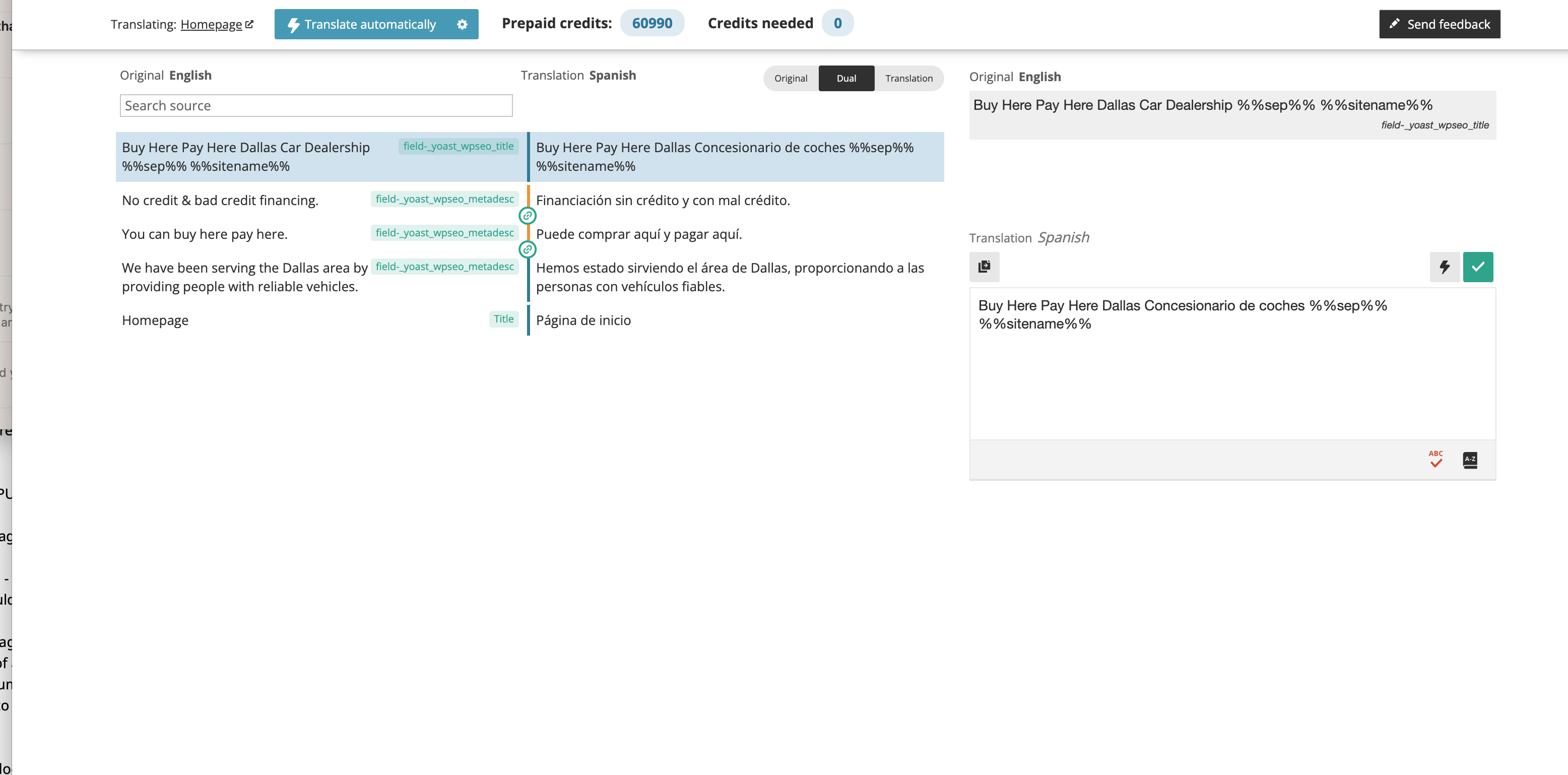

I have the ACF multilingual and string translation add-ons installed on the website and have run auto translations as well as all the string translations for ACF fields.
Yet none of the acf fields are being translated. When I am viewing the translation edit screen for an individual page on my website, I am not seeing the ACF fields being identified (attached.)
Field Groups in WPML settings is set to Not translatable.
I installeed the same set up on a different website - vamosauto.us - and did not run into this issue. All ACF fields were translated their. Not sure what the difference here is.
Please assist.

For example this page hidden link
I make a small change to the page title > Update > Update the translation > Complete then the translation content displayed in the frontend as well. Please check this screenshot
Can you please confirm it works on your end?

I need to edit each and every page for the translation to work?
Yes, it looks like the ACF field value is not translated via Advanced Translation Editor before. I'm not sure how the ACF field group to page content was setup before but you can create a new page with the same blocks in the content and translate it again to see how it works.
Or you can go to WPML > Translation Management > Send the pages to Automatic Translation and override the current translation, please check this screenshot hidden link

For this page hidden link
I've just tested translating some texts into Spanish to see how it works, other texts I copied from the original, please check this screenshot hidden link
You can re-translate the page to display the translation in the frontend.
