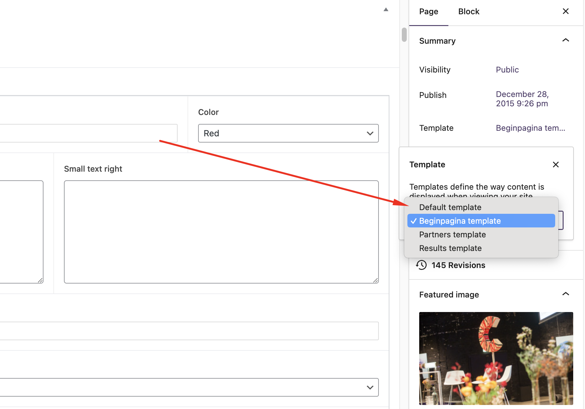

I noticed that only the image will show. You could try this out when changing the page to default.
its name: Beginpagina template Page Template
(page-frontpage.php)
Its not clear to my why this would not make it translatable. Templates should be set to not translateably right?

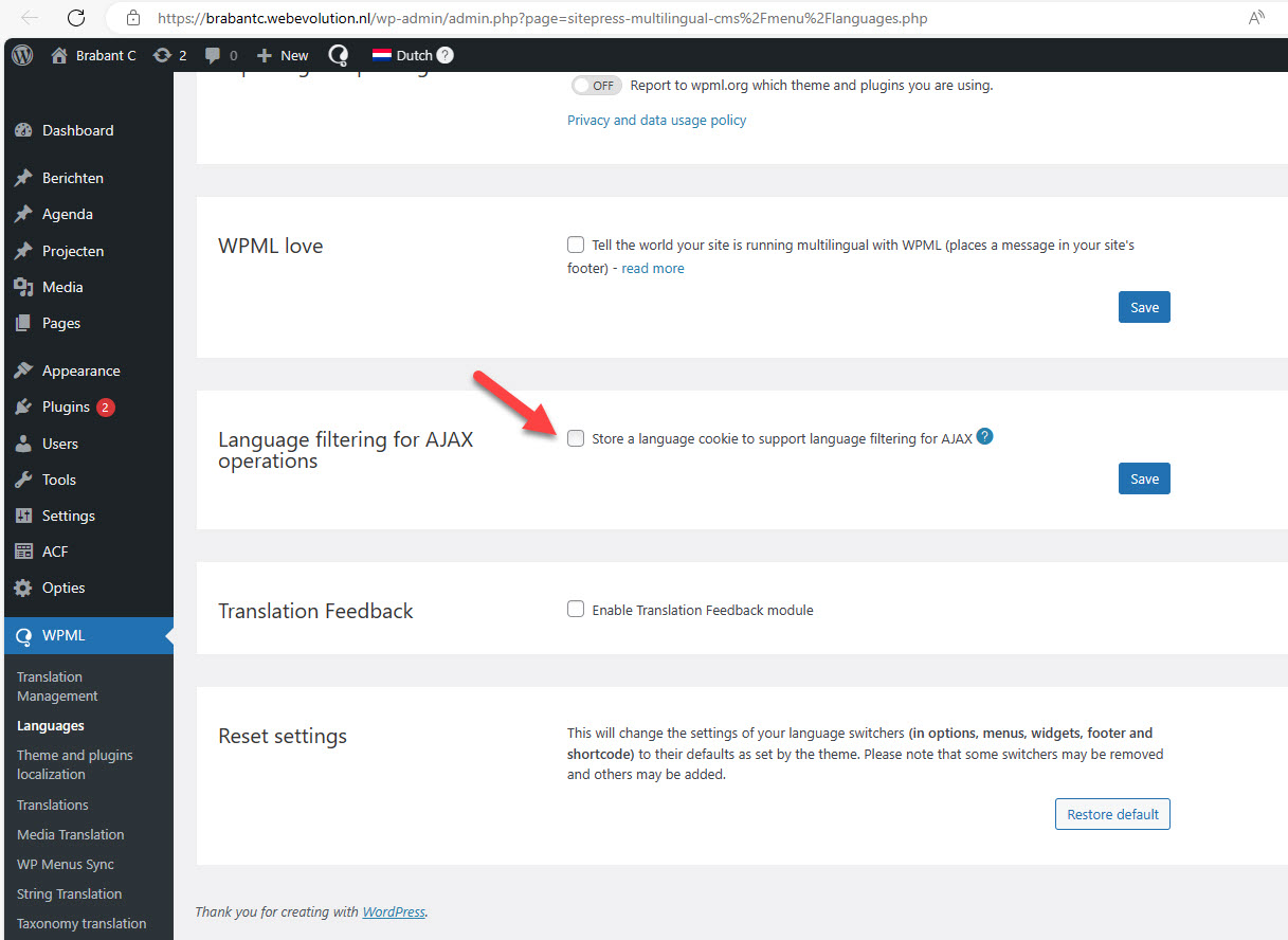

In WPML -> Languages, I saw that the 'Language filtering for AJAX operations' option is inactive. Please see the attached screenshot. So, I activated it, but unfortunately, it didn't help.
I'm sorry, but I still don't understand how things are constructed on your site. I'll do my best to continue to help you, but it seems that you have a lot of custom code, and this might be out of the scope of our support forum.

Thanks for your help already. The only custom code is the ACF Builder, unfortunataly the customer hired me to only translate the site to english. Perhaps that WPML is not the write solution then, im not sure why the text is translating but the images are not showing. Im quite sure that is because of the setting. But im not sure anymore if I configured it correctly.
That is the reason why I reached out to support on the first place.
To answer your question about the template page. I have attached a screenshot.

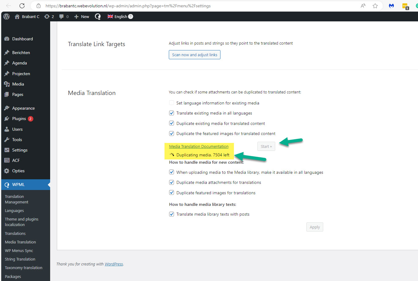

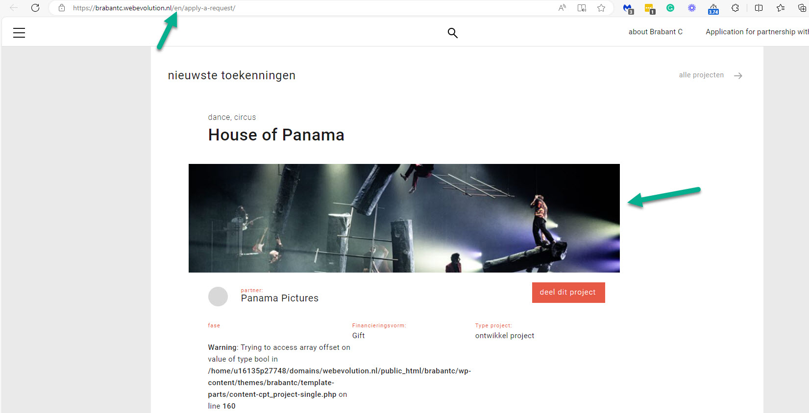

In WPML -> Settings -> Media translation, I pressed the 'Start' button to duplicate the media to the translated content. There were many images to duplicate, so I needed to wait a few minutes for the process to finish. Please see the attached screenshot. But I think it worked. At least some of the images are shown on the translated page and posts. Please see the attached screenshot.
Is the images' issue solved now?
If not, can you please be specific about which images are missing? (Please include screenshots.)

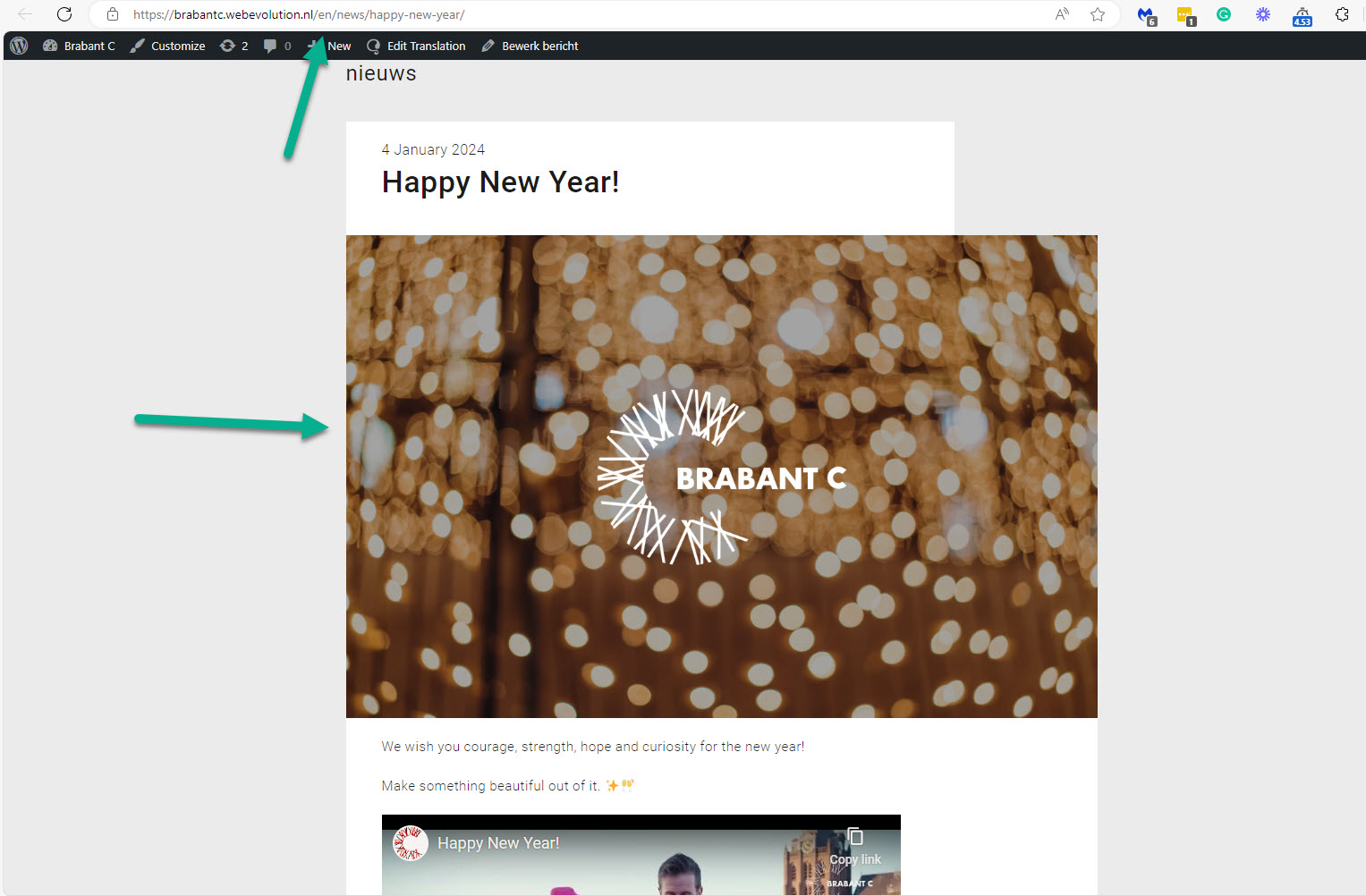

As far as I can tell, the "news" posts are working fine. I can see the images are shown on the English-translated news posts. In my last reply, I shared a screenshot from a news post. Here are two examples.

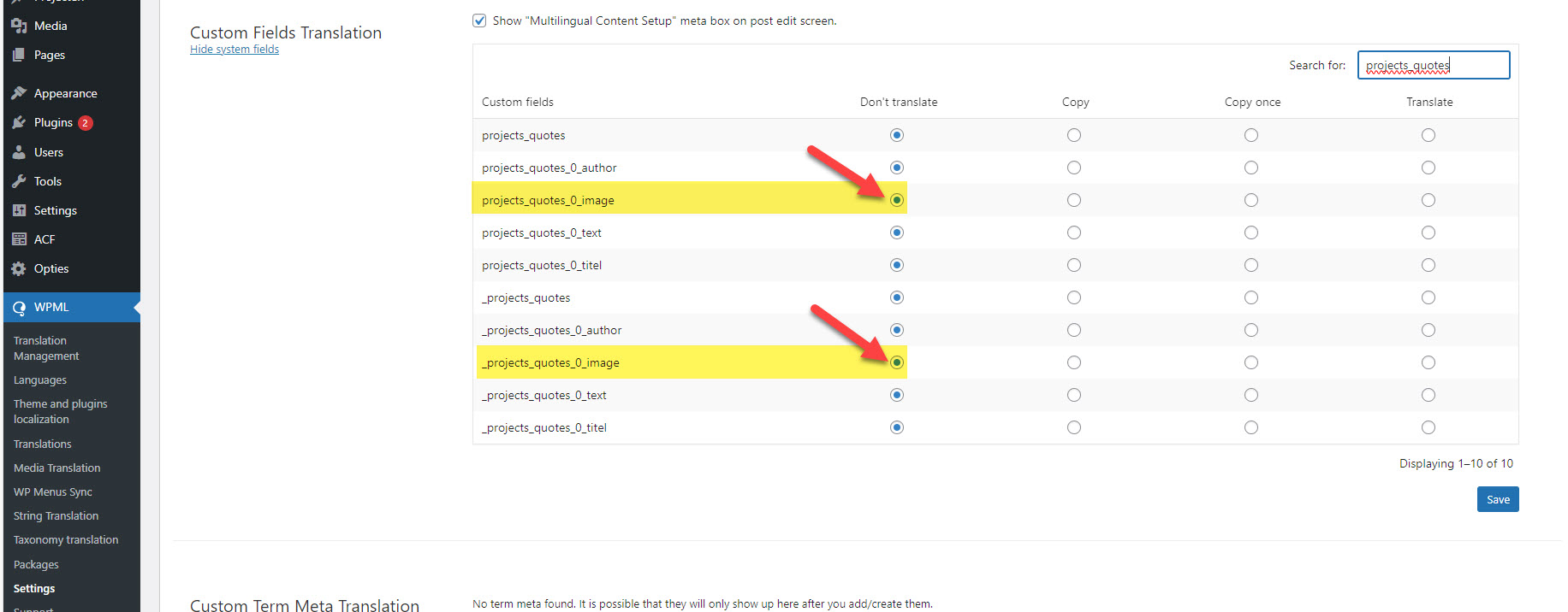

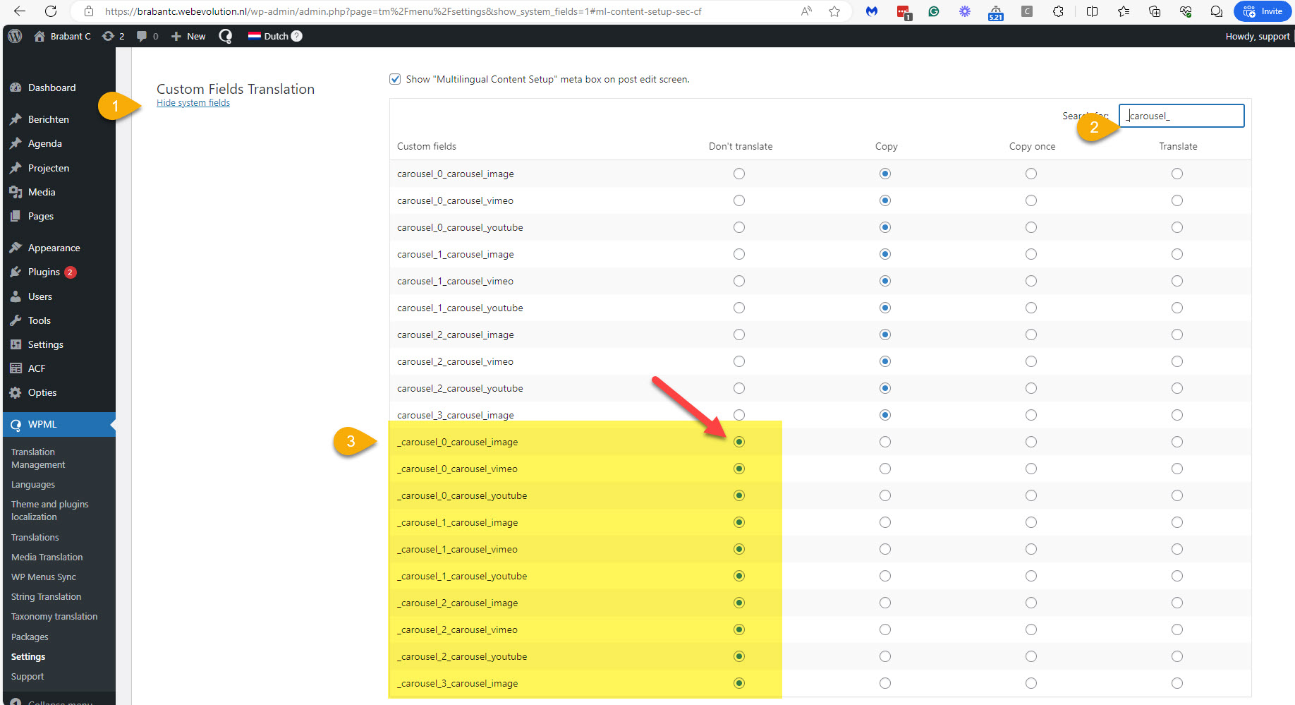

In WPML -> Settings -> Custom Fields Translation, you must ensure that all the fields are set correctly. For example, I can see a few fields related to images and carousels that are marked as "Don't translate." This also includes system fields. Please see the attached screenshot system-fields-not-trans.jpg and projects_quotes.jpg. Those are just examples, as you might have more fields set to "Don't translate." The settings should be according to the following guide.
https://wpml.org/documentation/related-projects/translate-sites-built-with-acf/recommended-custom-fields-translation-preferences-for-acf-and-wpml/
Itamar.

I did change the system fields as requested. Now very thing is gone. Perhaps the settings are still incorrect, but I dont know it. Can you please check?
For example the homepage showed the projects with images, but even that is gone
February 7, 2024 at 2:40 pm #15277189
Itamar
WPML Supporter since 02/2016
I'm sorry if I didn't mention it, but changing the settings will not solve the problem by itslef; you must also update the translations.
Itamar.
