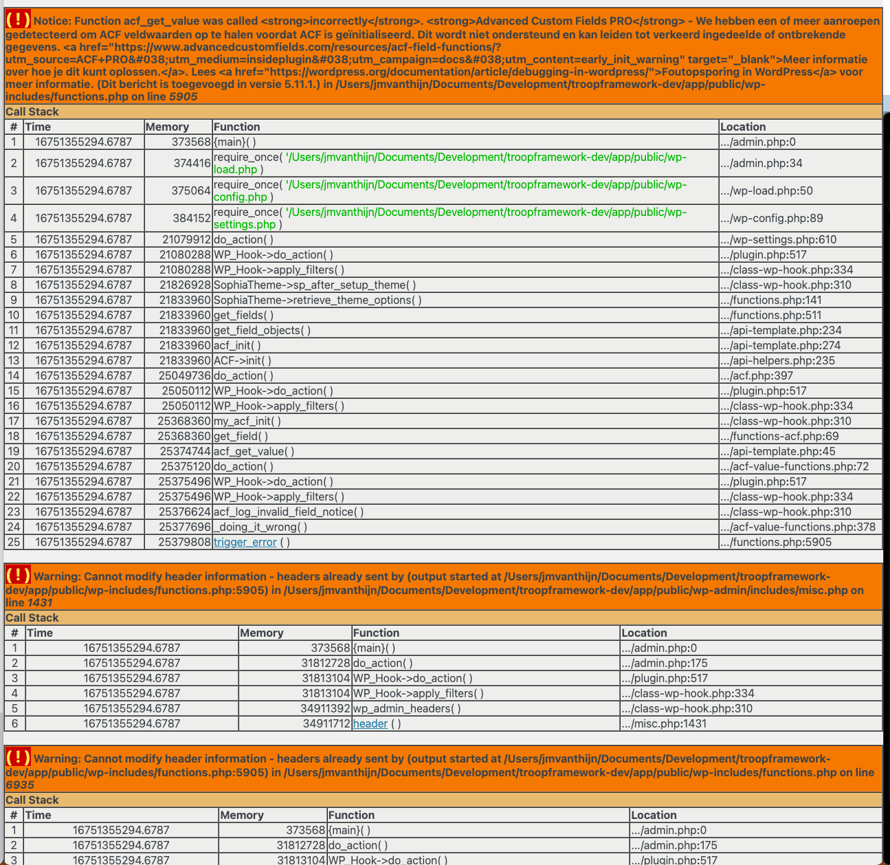

I'm trying to use WPML in conjunction with Advanced Custom Fields (ACF) on my website. Everything works fine when viewing content in our primary language, Dutch. However, when I switch to our secondary language, I encounter an error related to the acf_get_value function.
I've reviewed the WPML documentation related to ACF integration and followed the recommended setup steps. I've also consulted the ACF documentation and online forums to ensure that I'm using the plugin correctly.
The error message I receive is as follows:
( ! ) Notice: Function acf_get_value was called incorrectly. Advanced Custom Fields PRO - We detected one or more calls to fetch ACF field values before ACF has been initialized. This is not supported and can result in incorrectly formatted or missing data.
This error only appears when viewing the site in our secondary language.

It was een issue with my theme, where I get the acf options but before ACF was rendered. So i've fixed it! Thanks!
