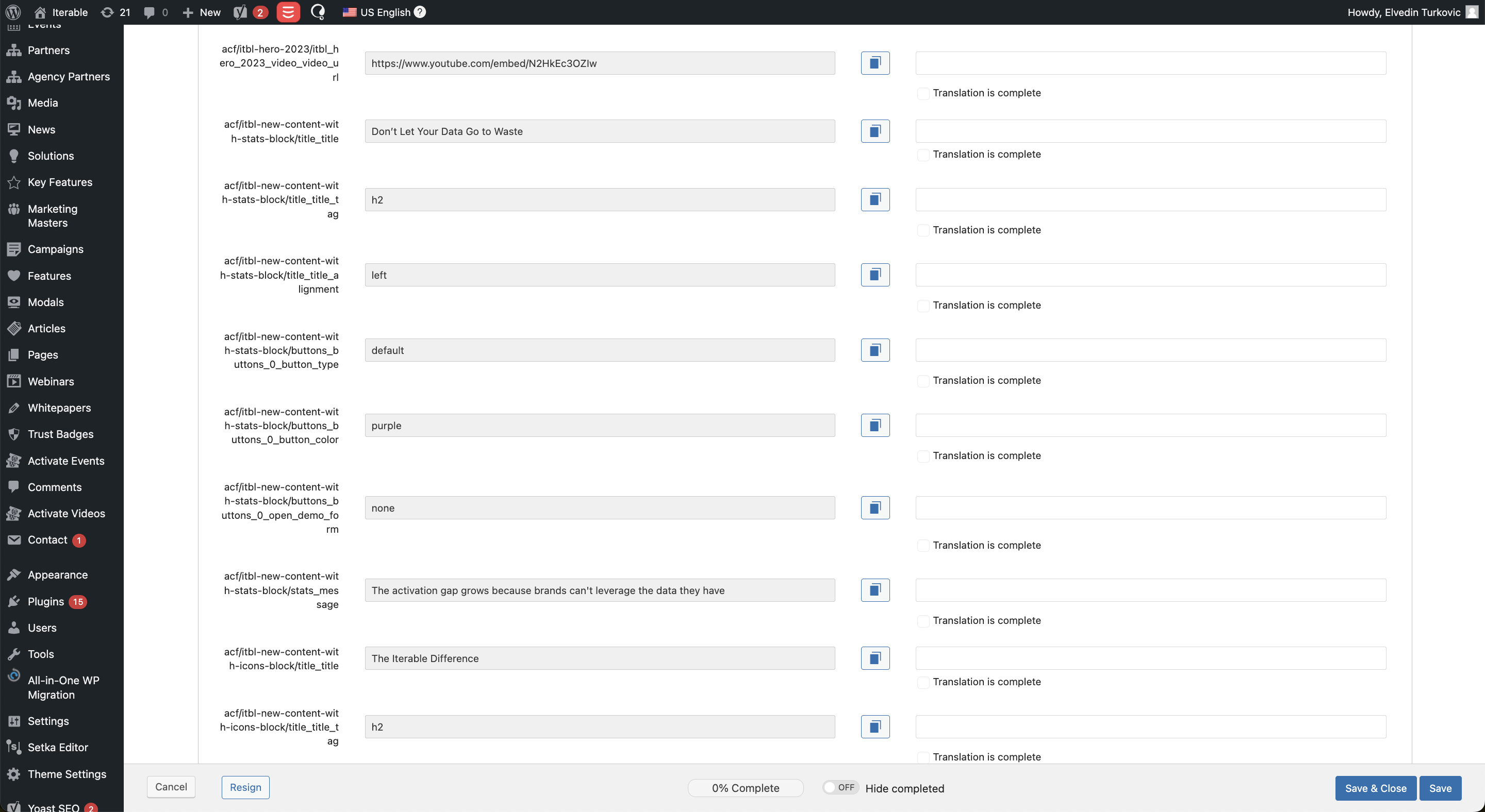

Hi, in the past 2 days we have made sure to try out everything before getting back to this question. We have now update the plugins to the following versions:
Advanced Custom Fields Multilingual 2.1.3
WPML Multilingual CMS 4.6.11
WPML SEO 2.1.0
WPML String Translation 3.2.12
We are also using the following setup with ACF fields:

What we expect to happen is that the fields inside this block appear as they are configured. Meaning: If the field has wpml_cf_preferences: 1, it should not appear in the translation export or the editor because it is marked as "Copy" and we want the fields that are set as wpml_cf_preferences: 2 to appear in the translations. For some fields this works and we can change their translation status, but some other fields, regardless of what we set as the configuration, do not appear in the translation or cannot be disabled in the translation. Example of a field that we are currently testing is the field "field_64132aa6c4b56" above in the JSON. We have these configurations in our staging environment, but the field does not appear in the editor. We will attach the translation editor screenshot.

Thank you very much for the help. If you pay close attention in the JSONs you will see that both ACFs have `"acfml_field_group_mode": "advanced"`. Shouldn't this mean that the expert button was clicked?
We have tried clicking the button directly in the dashboard on our local development machines. But we have not clicked any buttons in the staging environment. Instead, we have just uploaded the ACF JSONs to staging. (We are versioning the ACF files as JSONs they cannot be found in the database, because we don't sync them once we upload them. They are purely saved in the ACFs.) We would also like to keep it that way if possible.
June 19, 2024 at 3:41 am #15751994
Prosenjit Barman
WPML Supporter since 03/2023
Hi There,
Thank you for the update.
I understand your requirements. If the key acfml_field_group_mode is included in the JSON, the translation mode for the field group should adjust accordingly. However, instead of setting the mode to 'advanced' in the JSON file, could you please set it to translation and check if this changes the result? You may need to make a small change in the default contents and then recreate the XLIFF file.
You also mentioned that in the local development environment, you changed the translation mode for the field group from the ACF Dashboard. Could you let me know if that made any difference in the result?
Please let me know the update. I will be happy to help if you need further assistance in this matter.
Prosenjit
June 19, 2024 at 11:31 pm #15758956
joeyT-4
We have tried this. It did not work. The results are still the same. Some fields just don't appear in the translation whatever we try.
June 20, 2024 at 8:34 am #15762099
Prosenjit Barman
Hi There,
Thank you for trying out the suggestions.
As the issue persists, I kindly request you try replicating the issue in our sandbox environment. This will help us easily isolate the problem in this minimal setup. In this way, we can also easily escalate the issue to our developers if required. The autologin link to our sandbox is provided below.
- hidden link
WPML and its add-ons are already installed in the sandbox. Please install ACF and any other plugins needed to recreate the issue. Set up the plugins as they are on your site and try to replicate the issue. If you need to access the files(to store ACF JSON files), you can use the "File Manager" plugin installed in the sandbox.
Please let me know if you're able to replicate the issue in the sandbox. I will take a closer look and be happy to assist you further.
Thank you for your kind cooperation in this matter.
Prosenjit
