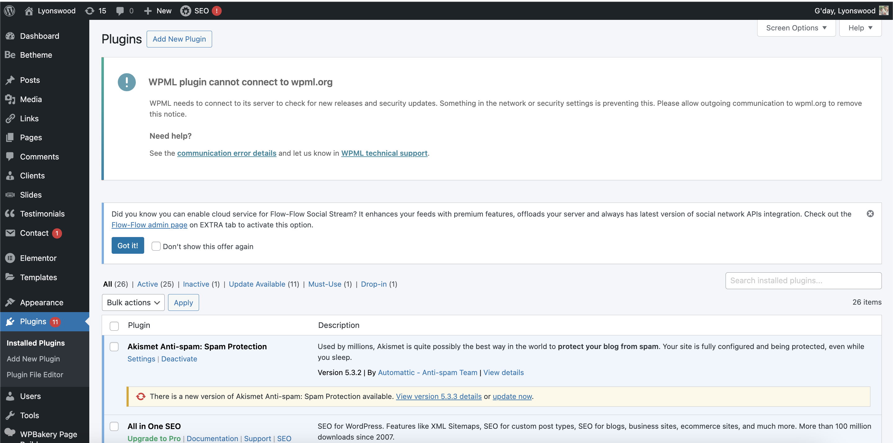

When I navigate to Plugins > Add new > Commercial, I see the following message:
"WPML - The WordPress Multilingual Plugin
You are using an expired account of WPML.
It means you will not receive updates. This can lead to stability and even security issues.
Extend Subscription
Unregister WPML from this site
Have you already renewed your license? Refresh account status
This page lets you install plugins and update existing plugins. To remove any of these plugins, go to the plugins page and if you have the permission to remove plugins you should be able to do this."
I have attached an image for your reference.
We appreciate any further assistance you can provide to resolve these issues.
screencapture-investigators-net-au-wp-admin-plugin-install-php-2024-07-21-15_37_34.png

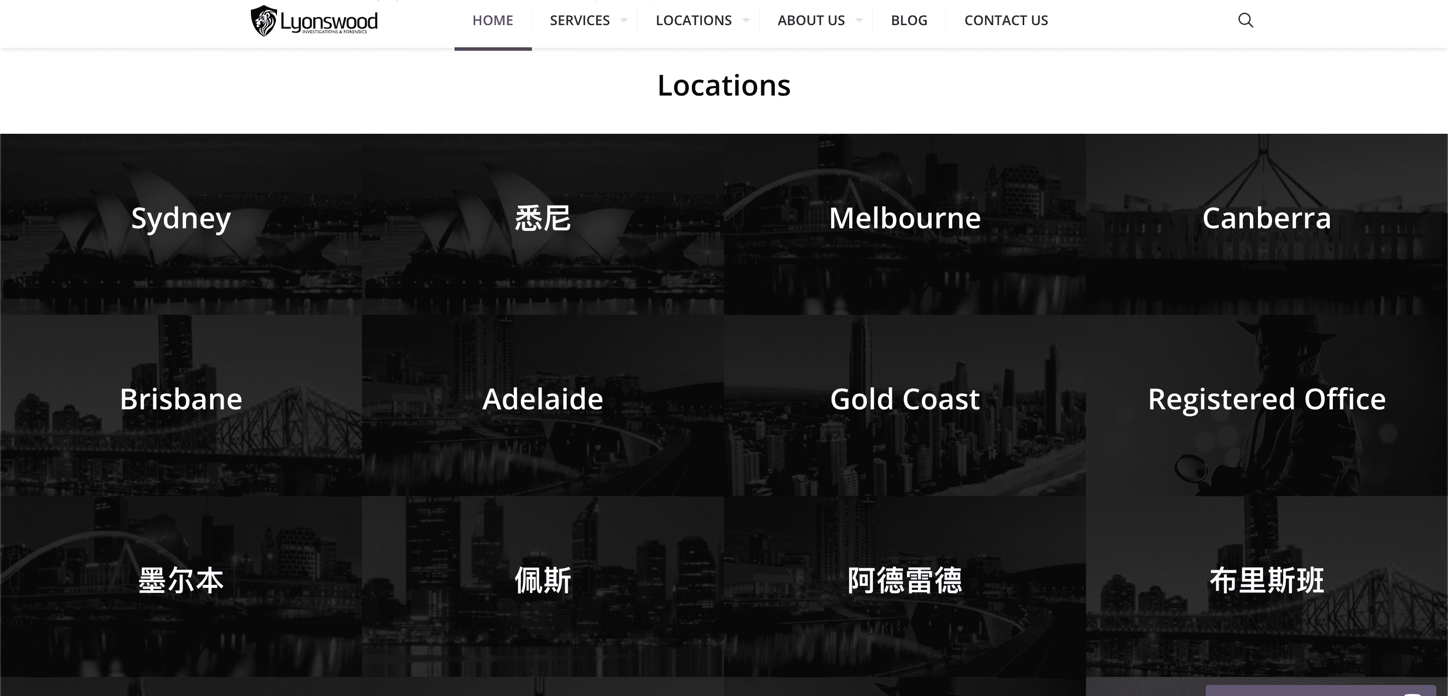

I still need some assistance with the WPML plugin. As I understand it (From the resource you shared earlier), I need to activate the plugin to remove a language. However, I am currently unable to activate it. Is there a way to delete the mixed content from my homepage and remove the plugin without activating it first?
My priority is to ensure the English version of the website is working correctly without any mixed content. Once that is resolved, I plan to re-enable WPML and translate the website from scratch.
Could you please guide me on how to remove the plugin and delete the mixed content? Should I try activating the plugin first (if so, how can I do that) and then remove the files, or can I proceed directly with removing the plugin?
I need to have the mixed content removed from the website within the next 3-4 hours.
Thank you so much for your help.

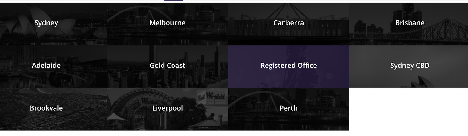

(I have attached the section that is rendering the mixed content and fixing that is a priority)

I was not understanding very well what do you mean by mixed content but I was able to understand things better by looking at the attached screenshot that you added above.
I am not sure why and how there would be mixed content taking into consideration that WPML was not even installed and we only had the OTGS Installer.
OTGS Installer is just an installer-helper type of plugin and you can read more about what it can do here:
https://wpml.org/faq/uploading-wpml-error-message/#upload-wpml-to-your-site-using-the-otgs-installer-plugin
So, as long as WPML is not enabled and not even configured, it would be impossible to be content that gets translated so I'm not sure why those parts of content were showing up.
Currently, I see that WPML is active on the site and I also see that the section you mentioned doesn't include those parts anymore (I'm attaching a screenshot of what I see now).
So I am not sure what was done on the site to remove those parts.

The website was functioning properly with WPML before the migration. After migrating, we encountered mixed content issues, and the toggle to change the language disappeared. Since then, we have been unable to activate the plugin. To resolve this, I have two options:
1). Activate the plugin and enable the Chinese language in the dropdown as before.
2). Remove the language, but I cannot activate the plugin to do this.
My top priority is to ensure that the English pages do not have any mixed content.
Can you please assist me in finding the quickest resolution?
I need to fix English website in next 2 Hours
If you have any questions, please let me know.
