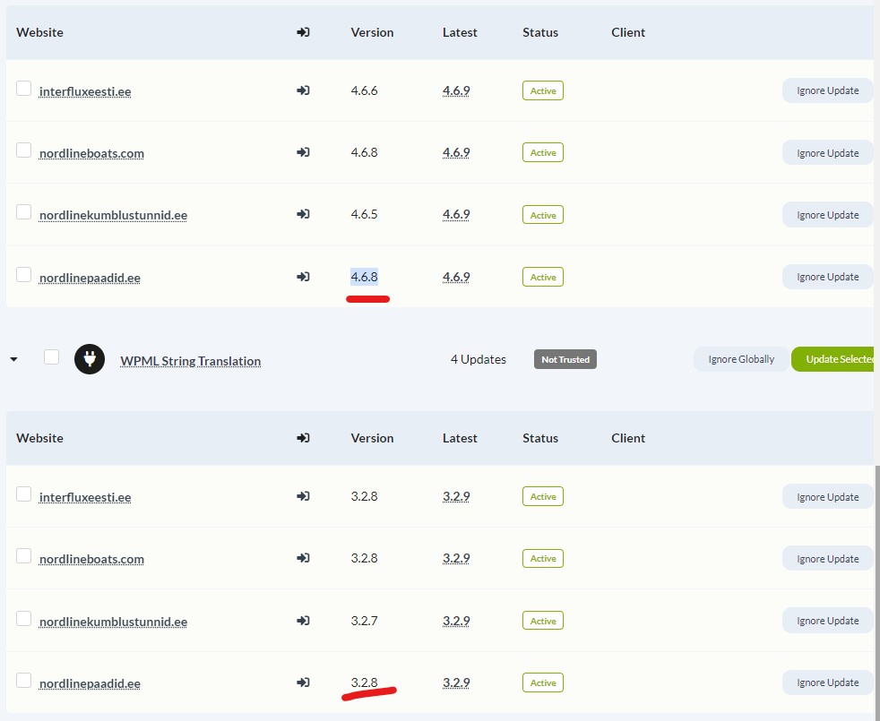

I am trying to: update WPL plugin
Link to a page where the issue can be seen: its a live site, I restored the page
I expected to see: I was hoping to see that the plugin update would not cause a problem
Instead, I got: doubled language directories in urls! See in pic
NB! Site restored and debug info for restored site!

January 23, 2024 at 7:15 am #15214182
priitP-4
Hey!
Looks like now working correctly! Did you guys fix something on your plugin?
Also in that site im not installed latest version 4.6.9 of WPML- how that is possible? Did you guys force to update that?
In attached images are the plugin versions as I wrote to you..
The most important thing is öooks like it works now and the url is correct
All Best,
Priit
January 23, 2024 at 2:04 pm #15217430
Prosenjit Barman
WPML Supporter since 03/2023
Hi Priit,
I hope you're doing well.
Glad to hear that everything is working fine now.
Based on the WPML Debug Info, it appears that WPML version 4.6.9 is installed on your site. Automatic updates may be enabled on your site, which could explain why WPML updated to its latest version automatically and the problem was resolved.
Further investigation on this issue revealed that the issue might also arise if the Site URL and WordPress URL in "Settings > General" include a trailing slash (/) at the end of the URL. In such cases, you can try the workaround mentioned in the errata below which was effective in solving the issue, also in the single site.
- https://wpml.org/errata/wpml-redirection-issue-in-multisite-network-with-sub-folder-installation/
Feel free to let me know if there is anything else you need help with. I'll be happy to help.

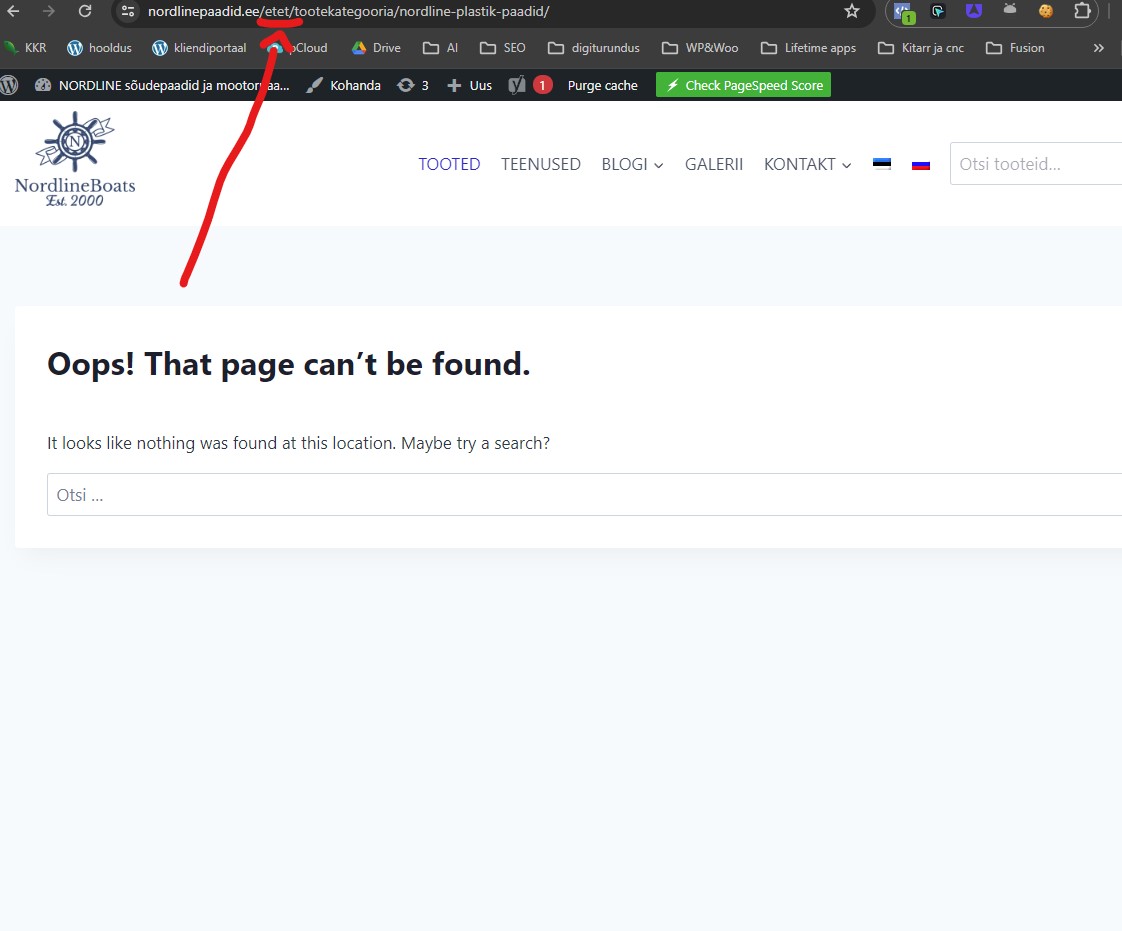

January 25, 2024 at 11:34 am #15225822
priitP-4
Hey!
now I have other site same issue: hidden link
Doubled et language code in url!
How to fix?
All Best,
Priit

January 29, 2024 at 8:36 am #15236516
priitP-4
Hey!
Thanks for replay!
Beta not fixed that. If I have url with language code, then it still double that language code inside url. Take a look url and see result in browser:
RESUOLT IN BROWSER:
All Best,
Priit

January 30, 2024 at 7:54 am #15241745
priitP-4
Hi!
Now it really seems that the url is fine and there is no double language code..
Wonder what caused this problem temporarily?
