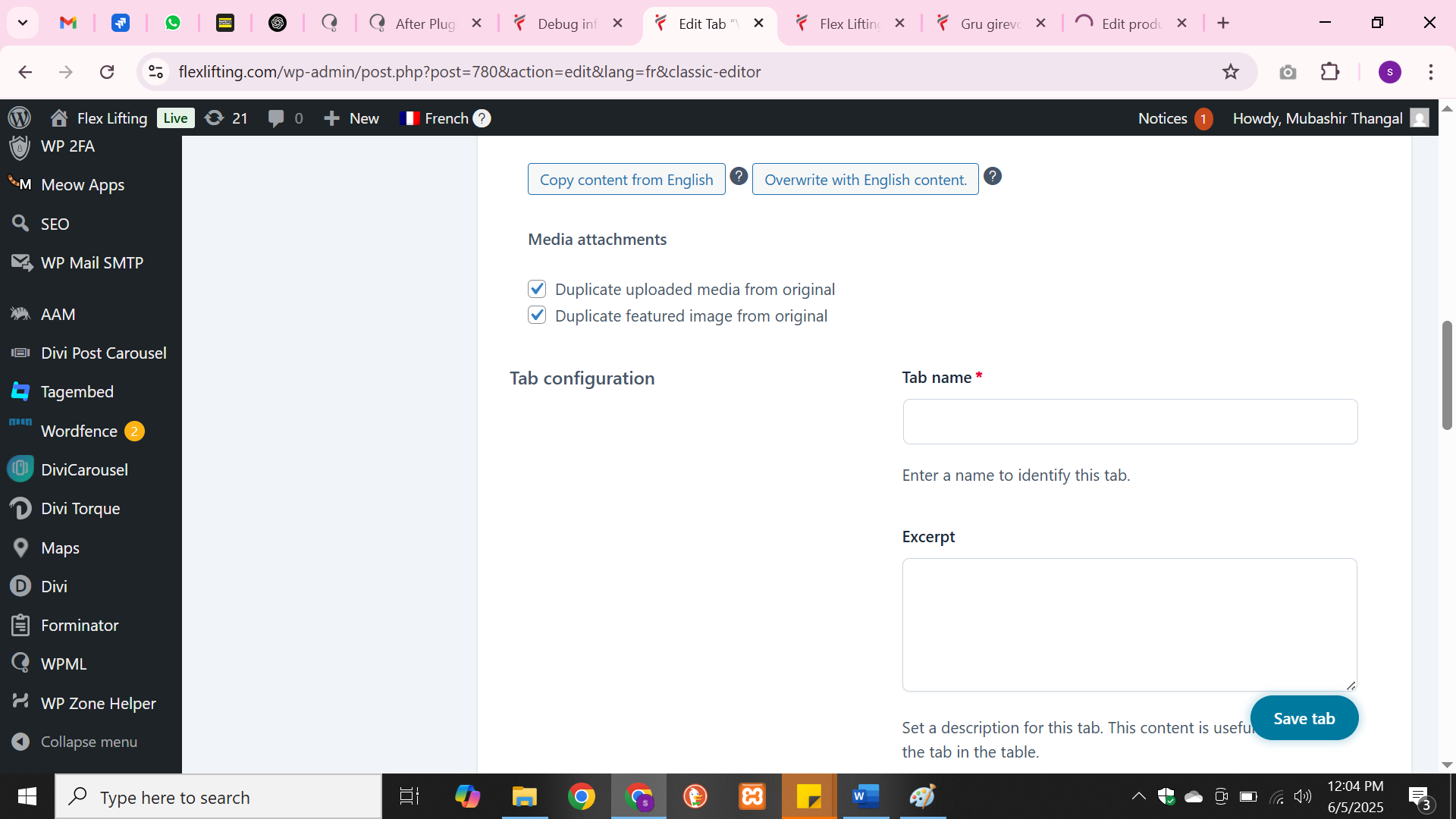

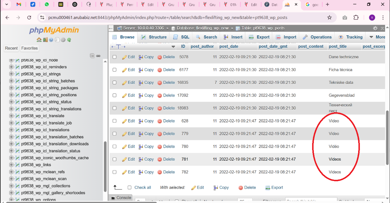

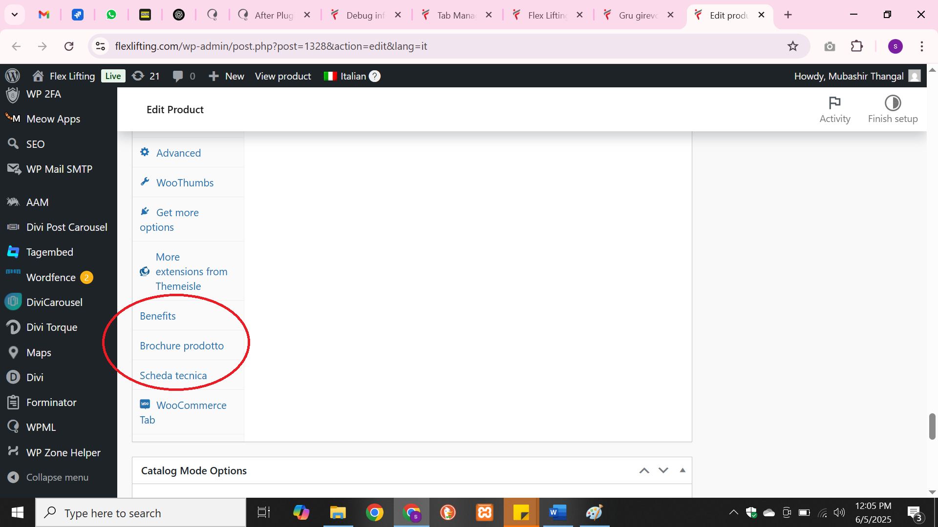

June 5, 2025 at 6:44 am #17108619
marcoT-36
i have 4 tabs , two are working fine, in the case of remaining 2 video and Scheda tecnica, video is completely missing in product edit page, and Scheda tecnica is present ther in product edit page, but no content. i have attached screenshots. when i edit from yith -tab manager, the vidoe tab has no tab name, but it is presnt in db when i check post type ywtm_tab with post tile video is there for multiple langauages, then why it is missing in tab name ?
