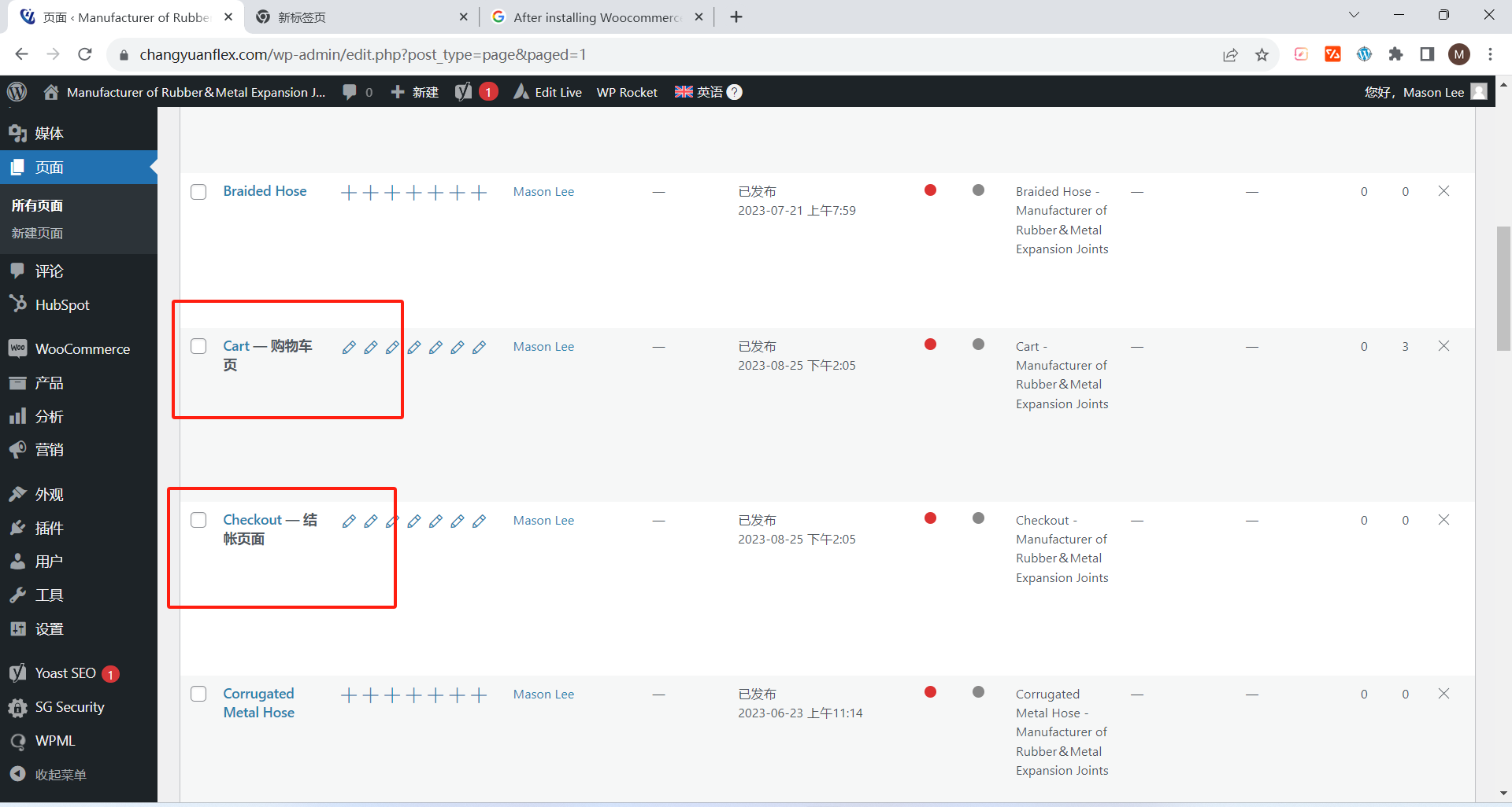

I don't know why, there were suddenly many duplicate pages on my WordPress. I checked and found that most of them were automatically generated pages related to Shop, My Account, and WooCommerce. Why did so many pages suddenly appear? This happened after I closed the wpml plugin and then reopened it. Could you please help me check if there is something wrong with the wpml plugin?

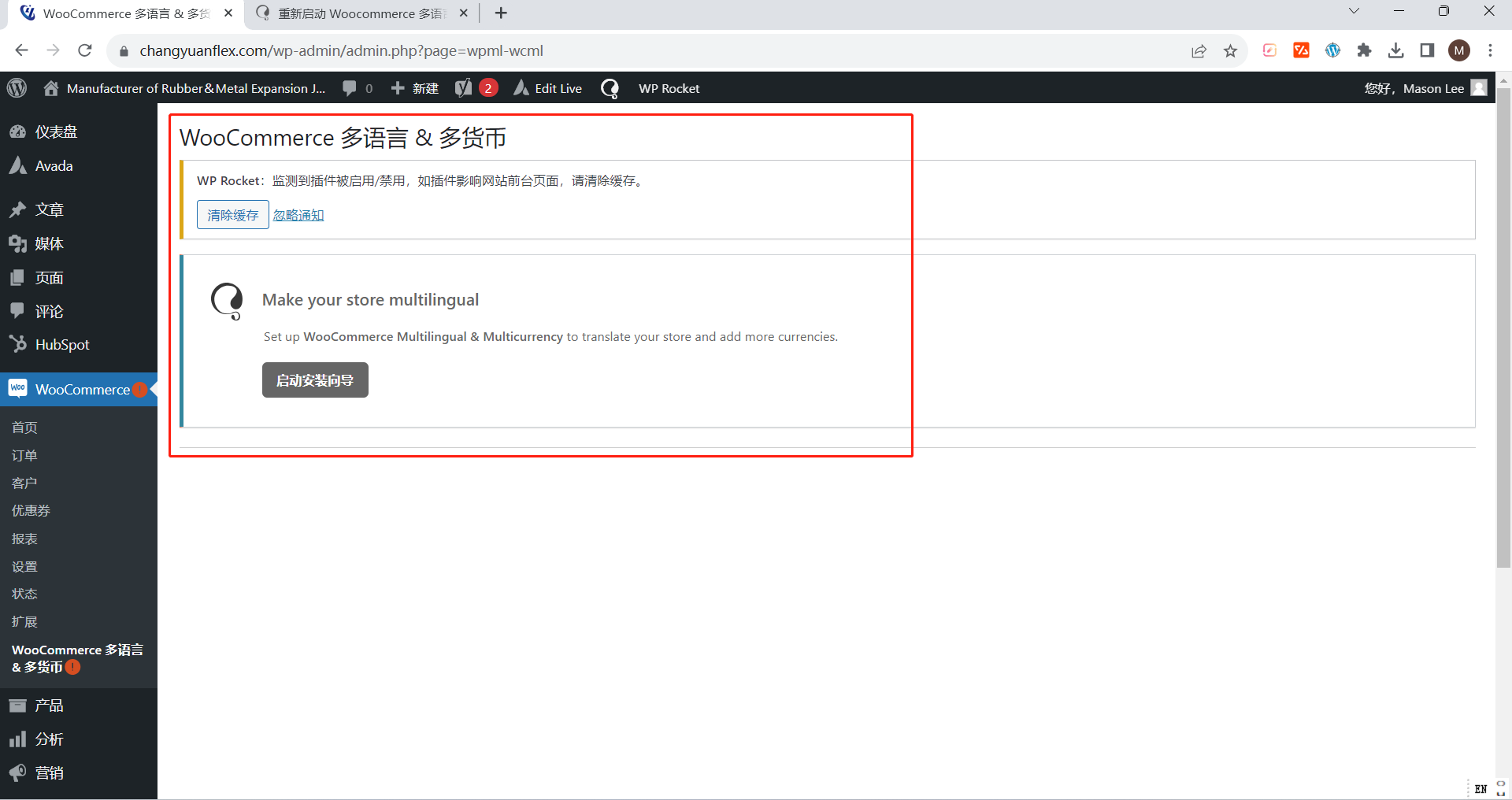

Answer 1: Yes, I have installed the WooCommerce multilingual version of WPML
Answer 2: I haven't set up the Woocommerce multilingual plugin yet

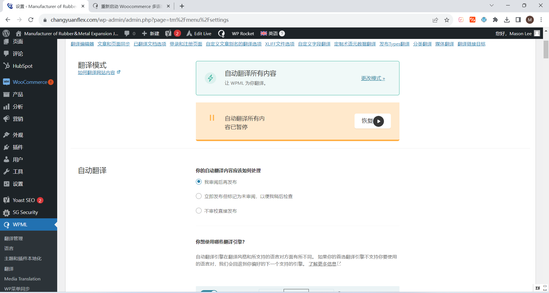

Answer 3: Yes, I activated automatic translation for all content in WPML ->Settings. As shown in the attached image.

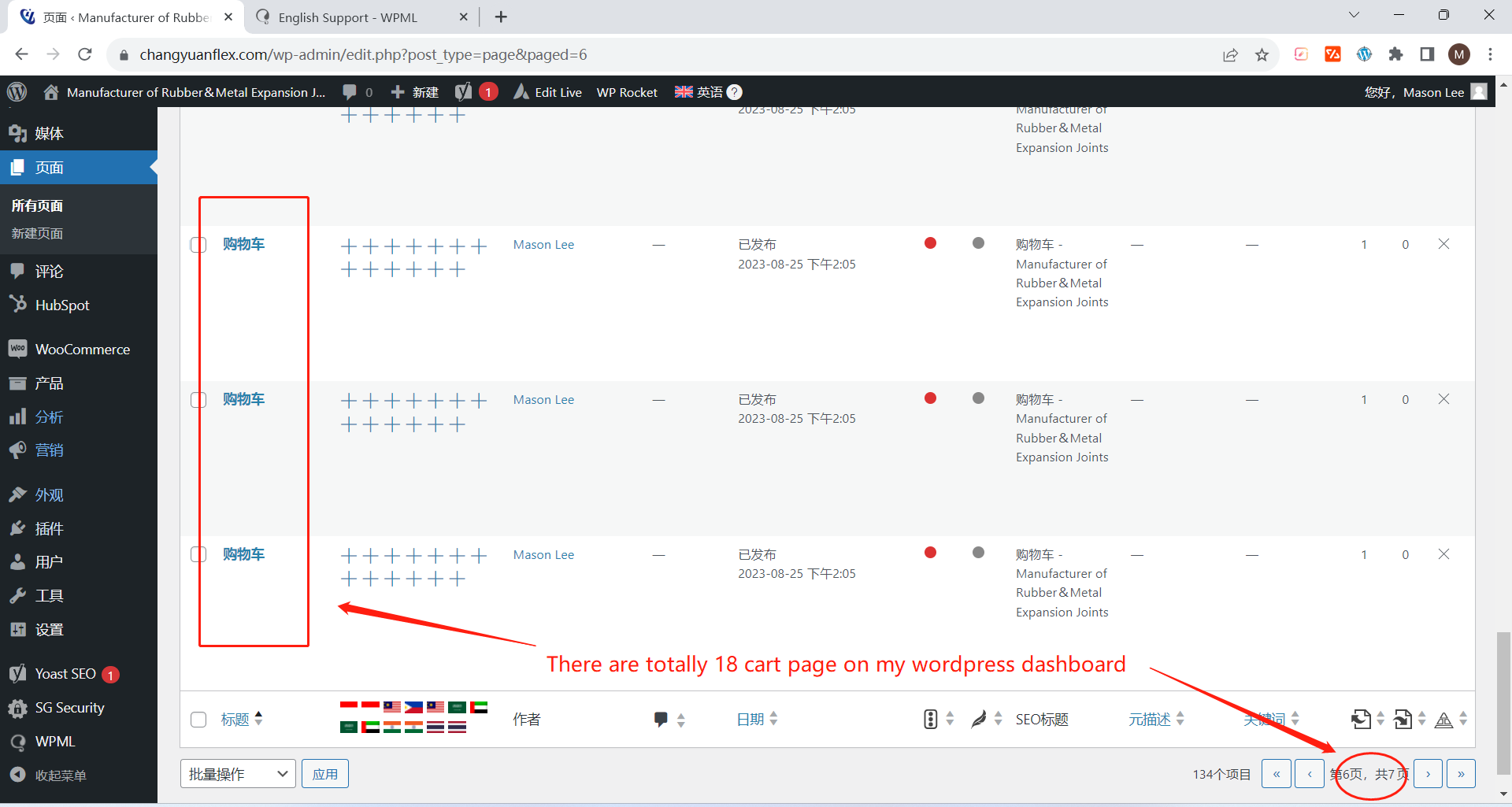

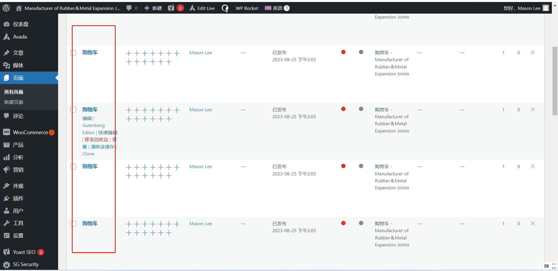

Please log in to my account and help me resolve these issues. My website has many duplicate pages, such as shop, my account, checkout and cart. Each page has five or six duplicate pages, all of which are identical. Please help me solve this problem, thank you!

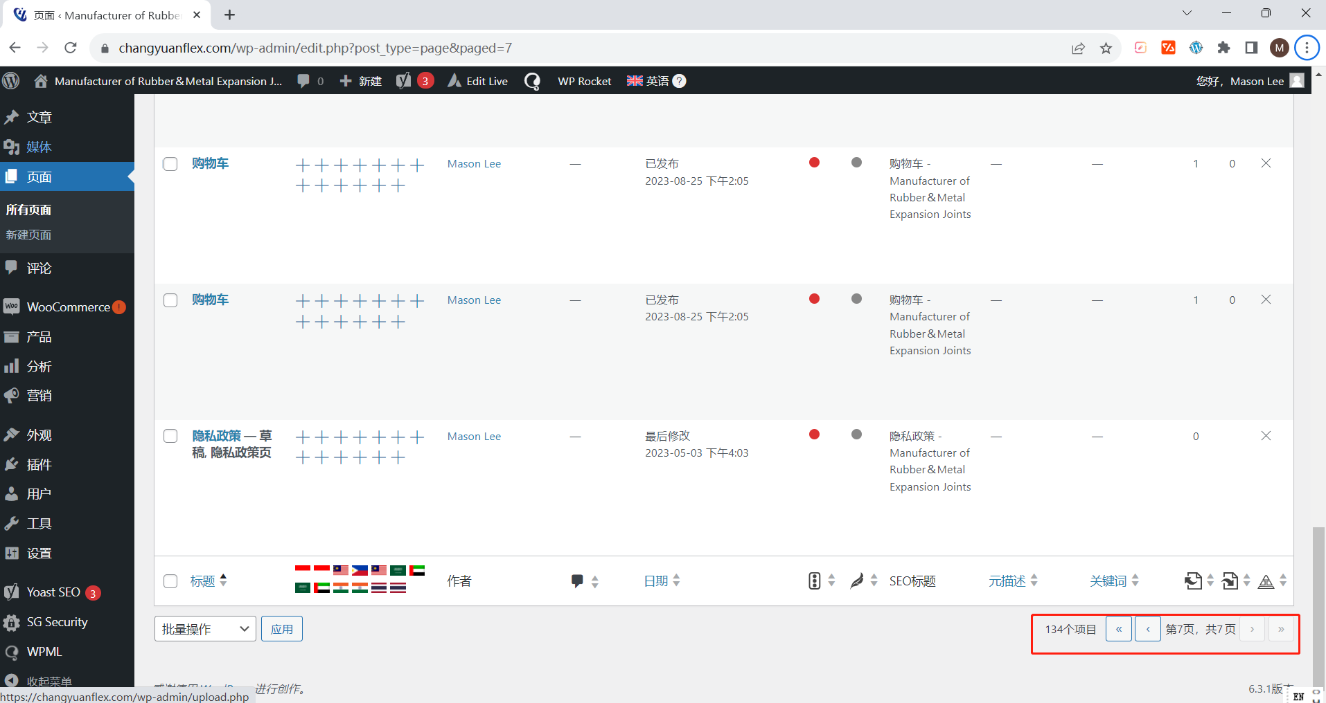

I can manually delete these duplicate pages, but I am very confused. I have a total of 14 languages in my language settings. I counted these duplicate pages, such as cart, which has a total of 18 duplicate pages. How many duplicate pages should I keep? Fourteen? Or one?
September 25, 2023 at 6:53 am #14454655
Dražen
you should have only 1 page in your default language and then a page in each language, which is also connected to your default language page. This means it should have a pencil icon, not a plus.
You should not have 14 or 18 same pages in your default language.
When it comes to WooCommerce pages, it may be best to delete them and re-translate them from WPML > Translation Management.
Hope this helps, let me know if any other questions.

September 26, 2023 at 6:32 am #14463099
leeM-17
Now, I have deleted all duplicate pages according to your instructions. I only left some default pages, shopping cart, my account, checkout, and similar types. Only one default page was left. May I ask if I am doing the right thing?
September 26, 2023 at 6:40 am #14463159
Dražen
yes, that is correct.
You should have only 1 instance of default WC pages in your default language.
