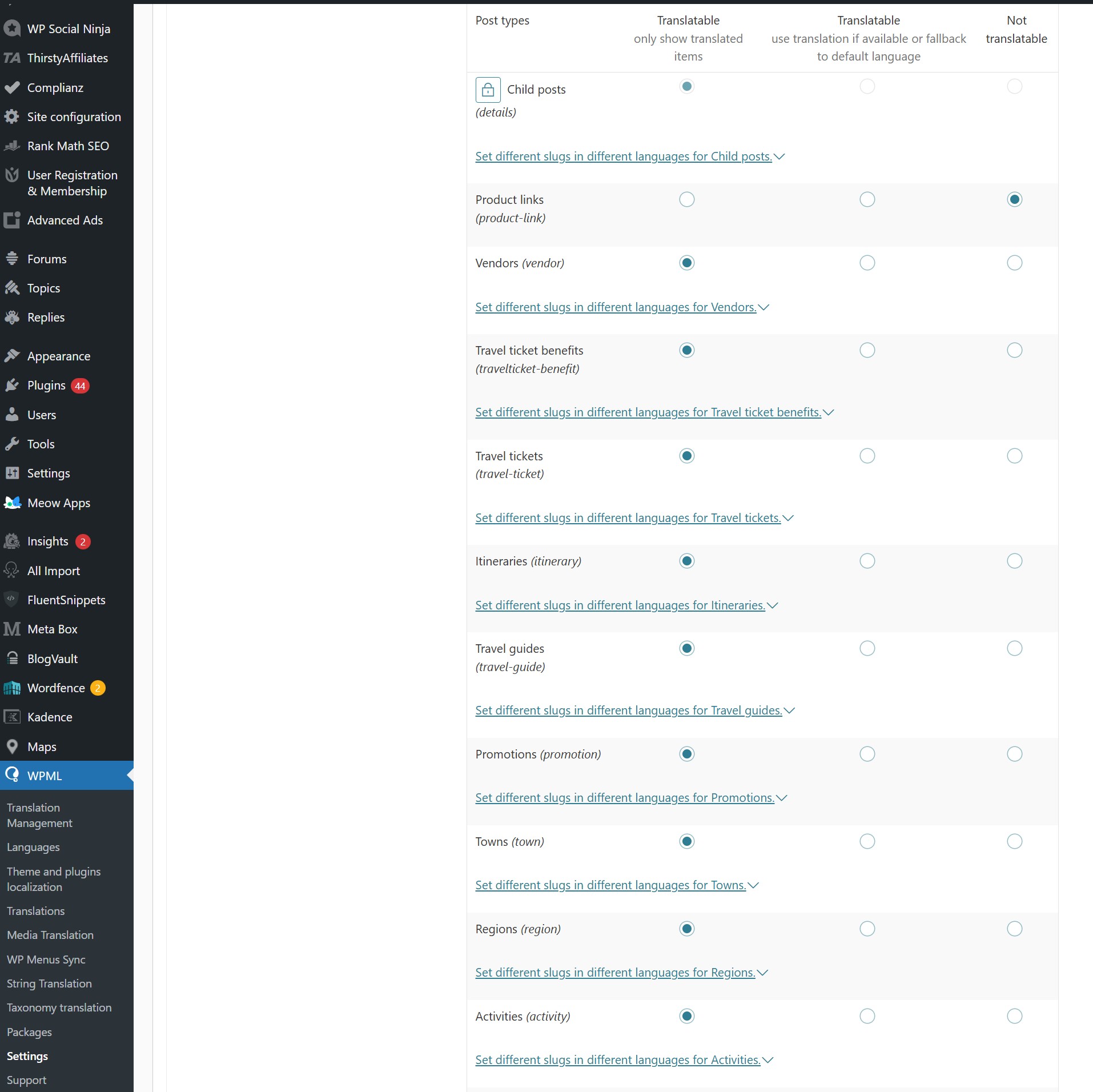

All languages of one of my custom post types are listed together in the backend: German and English, all in the same list, ignoring the WPML language filter in the top toolbar. I checked the settings, and it is still set to "Translatable" (although this setting is disabled and I cannot change it if I wanted to).
Also, the language switch is missing in the frontend, only for that post type.

Could you please upload a screenshot from the WordPress backend showing the issue? It would also be helpful to include a screenshot of the relevant settings showing that they are still set to “Translatable.”

January 27, 2026 at 5:47 am #17764881
arnoP-3
Hi Andrey,
I have attached everything you asked for.
Thanks,
Arno

Thank you for your feedback. That does sound unusual, especially since the post type is already set as Translatable, as you mentioned.
