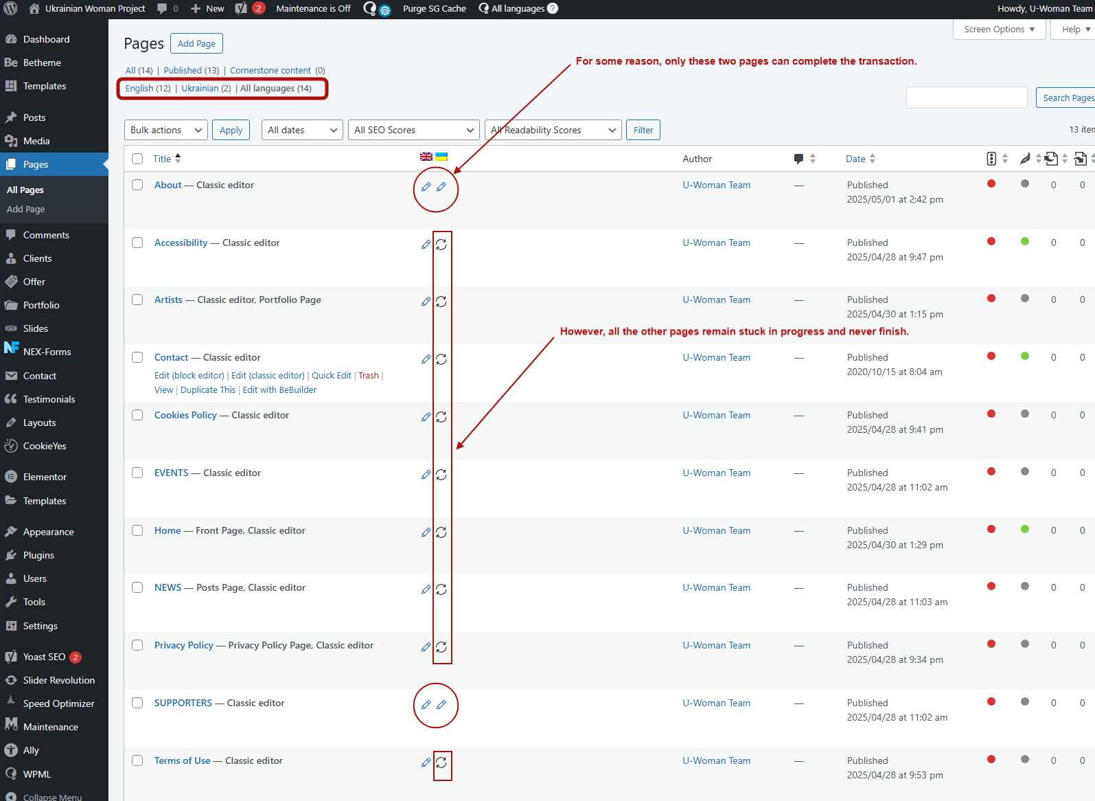

I am trying to complete translations for all pages, posts, and portfolio items on my site hidden link using WPML. I manually did all the translations using the + symbol, but only two pages and one portfolio item are fully completed.
Almost all pages and posts remain stuck in translation progress and never finish.
Why are almost all pages and posts stuck in translation progress and never finish?
How can I upload screenshots to provide more information?

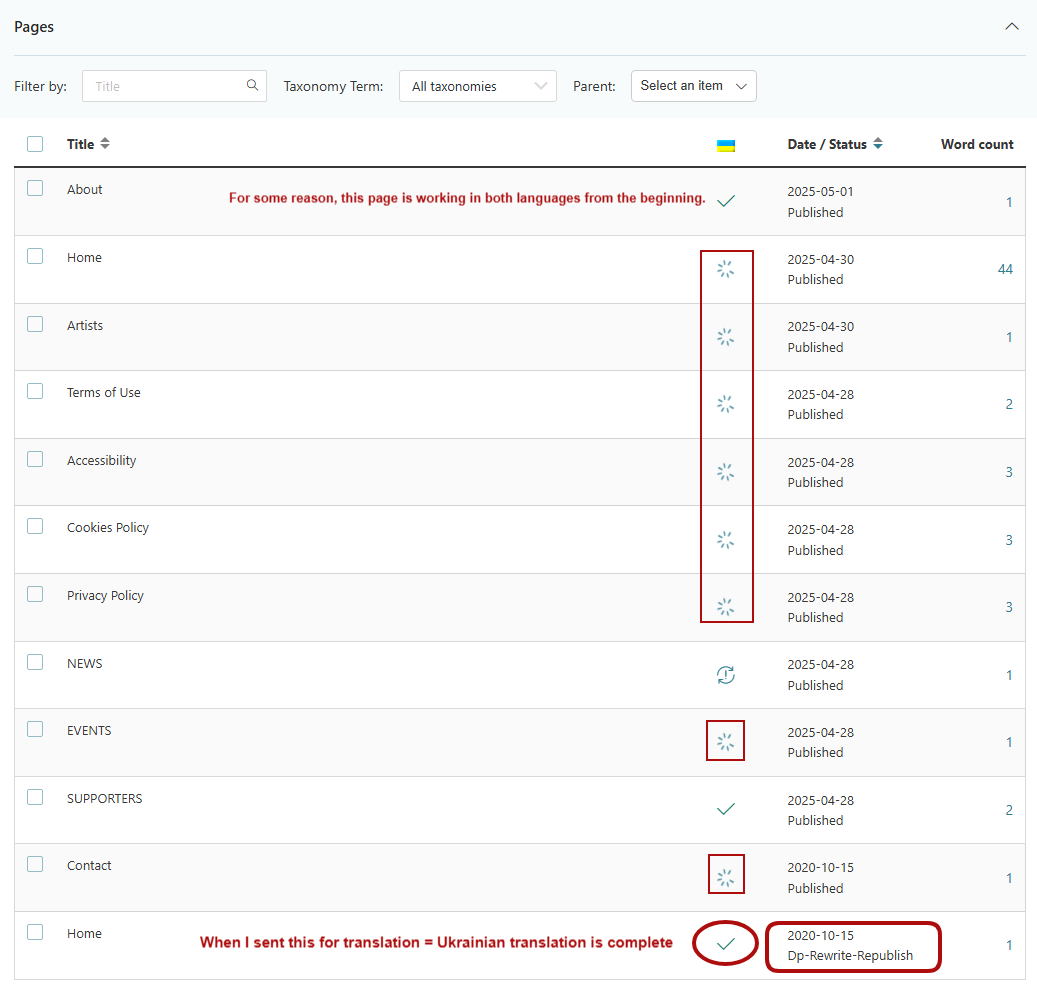

I was trying to resolve the problem and I found this:
"WPML cannot send some fo the content to translation
Some of the content that you selected for translation includes fields that are encoded. Translators will not be able to work on this kind of content, so we removed it from the job.
To fix this problem, please contact our support team and describe this issue.
Open support ticket"
Could you help me to resolve this problem?
Thank you
2025-05-06 09_53_07-Translation Management ‹ Ukrainian Woman Project — WordPress.png

When I send multiple pages for translation, the queue never end. When I send the homepage, a message alert about encoding fields appears.
Does it happen for all pages? How can I find these fields? Could you help me?

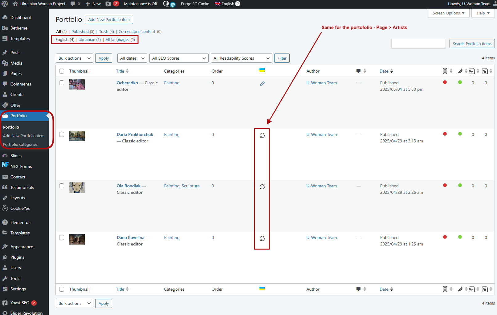

May 7, 2025 at 2:38 am #17004069
iliasP-6
Hello Otto,
I followed the steps you gave me one by one.On the Translation Management page, under the Pages section, I found two "Home" pages:
1) Home – Date: 2025-04-30, Status: Published
2) Home – Date: 2020-10-15, Status: dp-rewrite-republish
I believe the second one is your local copy. It had a red circular symbol. After I sent this page for translation, it now shows a checkmark with the note: Ukrainian: Complete.
All the other pages still show the spinning symbol (running non-stop) with the note: Ukrainian: In progress (unassigned).
What can we do next? Please advise.
