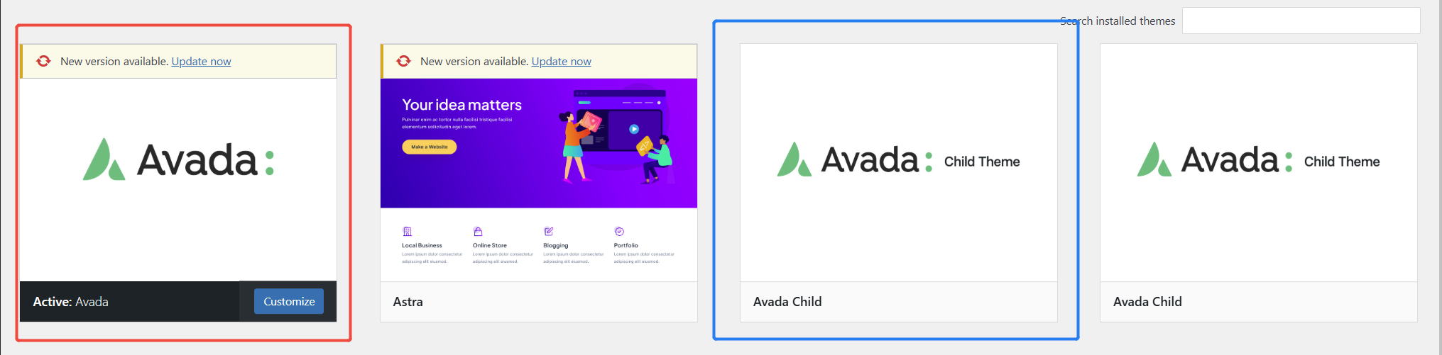

February 21, 2025 at 8:44 am #16732612
tianfangL
We think we can't update Avada because we hired an expert to do the code for us. If we update Avada, the added code will be lost. And this problem existed before the expert added the code, so it's not a problem with the newly added code.
If you can't verify it in the Avada we are currently using, how about trying it in the Avada we are not using?
And we are confused that when switching languages, the page jumps to the shop page instead of other pages. This directional page should have been accidentally added at some point? Otherwise, how could it jump to the shop page?
February 21, 2025 at 9:04 am #16732682
Shekhar Bhandari
WPML Supporter since 03/2015
Hello there,
The another Avada is just a child theme so it will not work.
In this case, the best possible way to debug this will be to replicate the site on my localhost and perform further debugging, is it okay, if I used duplicator plugin to create a backup of your site?
Look forward to your reply.
