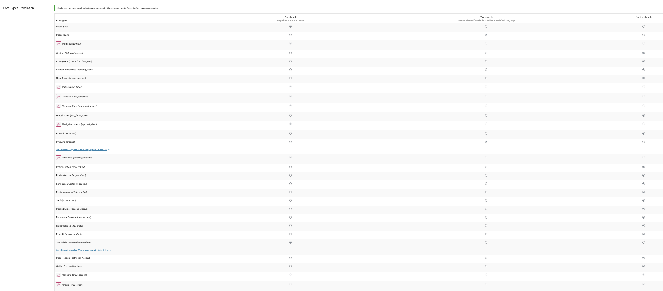

I cannot find 'Custom Layouts (astra advanced-hooks) in my 'Post Types Translation' section.
I don't have 'WPML Media Translation' installed. Could that be the reason?
Best, Klaus

The issue doesn't seem to stem from the Media translation plugin. It appears that WPML is unable to detect this post type for some reason. Could you please try these steps and see if the Post type then shows up in the settings?
- First, fully clear all caches from both your site and your browser.
- Next, head over to the "Avada > Custom layouts" section and create a new layout.
- After that, go to WPML > Support > Troubleshooting and click on the "Fix post type assignment for translations" button.
After these steps, please go back to WPML > Setting and check if you can see the post type in the list.
Let me know the update. I will be happy to help if you need further assistance in this matter.
