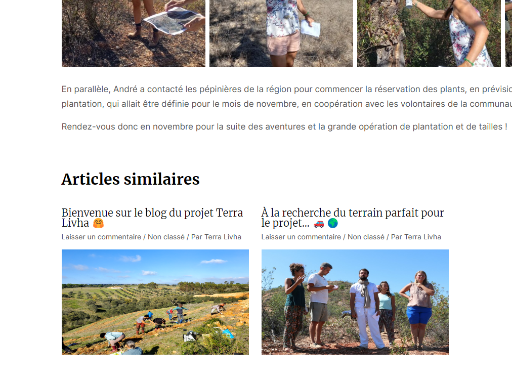

Posts are created in FR, while the site's default language is EN.
Tried to recreate it on a sandbox, but can not confirm the issue:
About to obtain Staging access
January 13, 2024 at 3:08 pm
January 13, 2024 at 3:12 pm #15181573
It seems that running the options at WPML > Support > Troubleshooting > Clean up solved the issue on the staging.
Please first test by only running the first option for "Synchronizing taxonomies" for "Posts". If this alone will not solve the issue please run further options until "Fix post type assignment for translations".
Only do not run "Reset language" in this section, please.
January 13, 2024 at 3:25 pm #15181589
cyrillek
It seems to have solved the issue on the live site 🙂

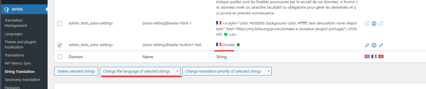

As a side question, do you know if i should do something similar in the troubleshooting section regarding the top menu (with the 2 green buttons), that keep on having the french erased and replaced by english ?
January 13, 2024 at 4:25 pm #15181640
In the case of those buttons, I would suggest that you set their source language to "English" first and then translate them.
See screenshot.
Guide:
https://wpml.org/documentation/getting-started-guide/string-translation/how-to-change-the-source-language-of-strings/
