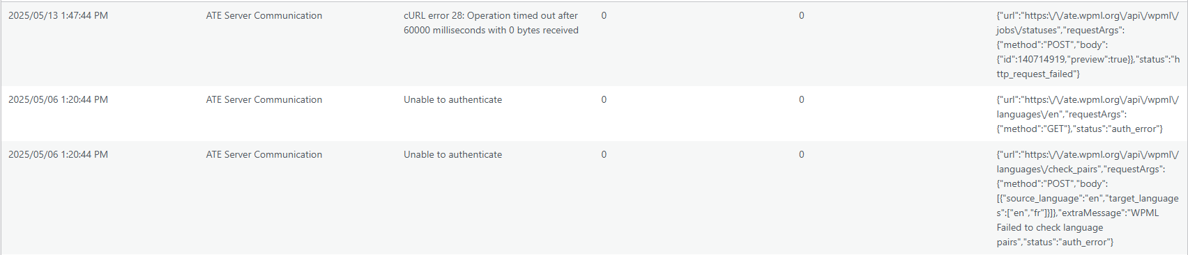

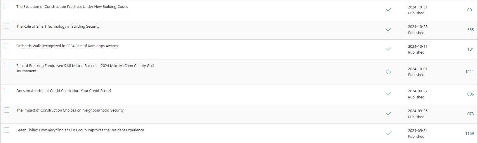

robertJ-35
Most of the statuses on the posts are "FR: complete", but a couple appear to be stuck in "FR: in progress (unassigned)". As for the error logs, most if not all of the errors below the few in the screenshot are the "WPML Failed to check language pairs" error.

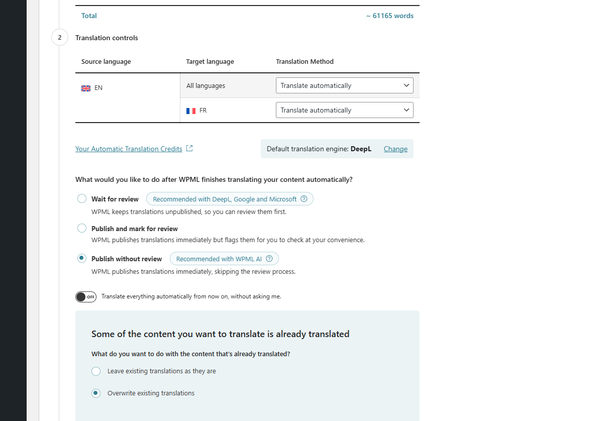

May 20, 2025 at 5:00 pm #17053927
robertJ-35
Okay thanks, I'll do that. To be clear I should be selecting "overwrite existing translations" here?
May 20, 2025 at 5:15 pm #17053993
WPML Supporter since 08/2022
Thanks for your reply. Please try the option "Overwrite Existing Translations" on a few posts that you're having issues with and see if it works fine. If all is good, you may proceed with all your posts.

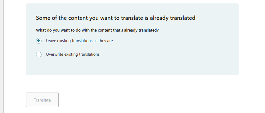

May 20, 2025 at 7:01 pm #17054360
robertJ-35
I'm not able to run the translations, the button is disabled and says "Selected content is already translated"
