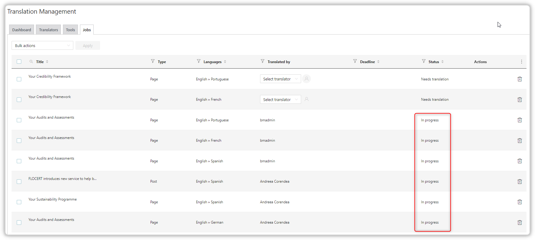

I am trying to use the ATE to translate 3 new pages from EN into 4 other languages.
I have been through the translations in the ATE and marked them all complete, however the jobs still show as "In progress".
As well as this, now when I try to start a new translation using the ATE, it takes me to the translation queue page instead of the ATE.

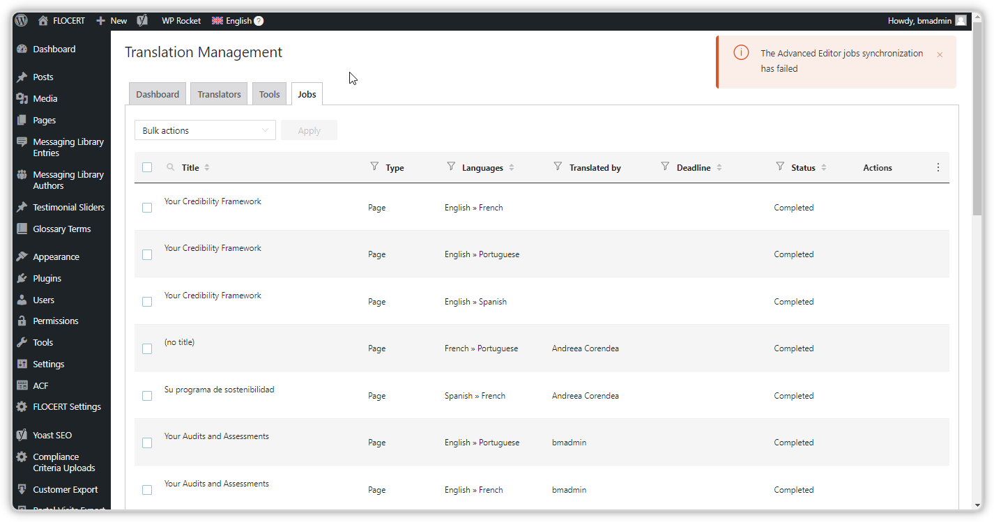

I followed your advice and updated WPML to the latest versions, and I was able to translate the pages again.
The only issue I see now is that when I visit the Translation Management -> Jobs tab I see the error message "The Advanced Editor jobs synchronization has failed" (see screenshot).

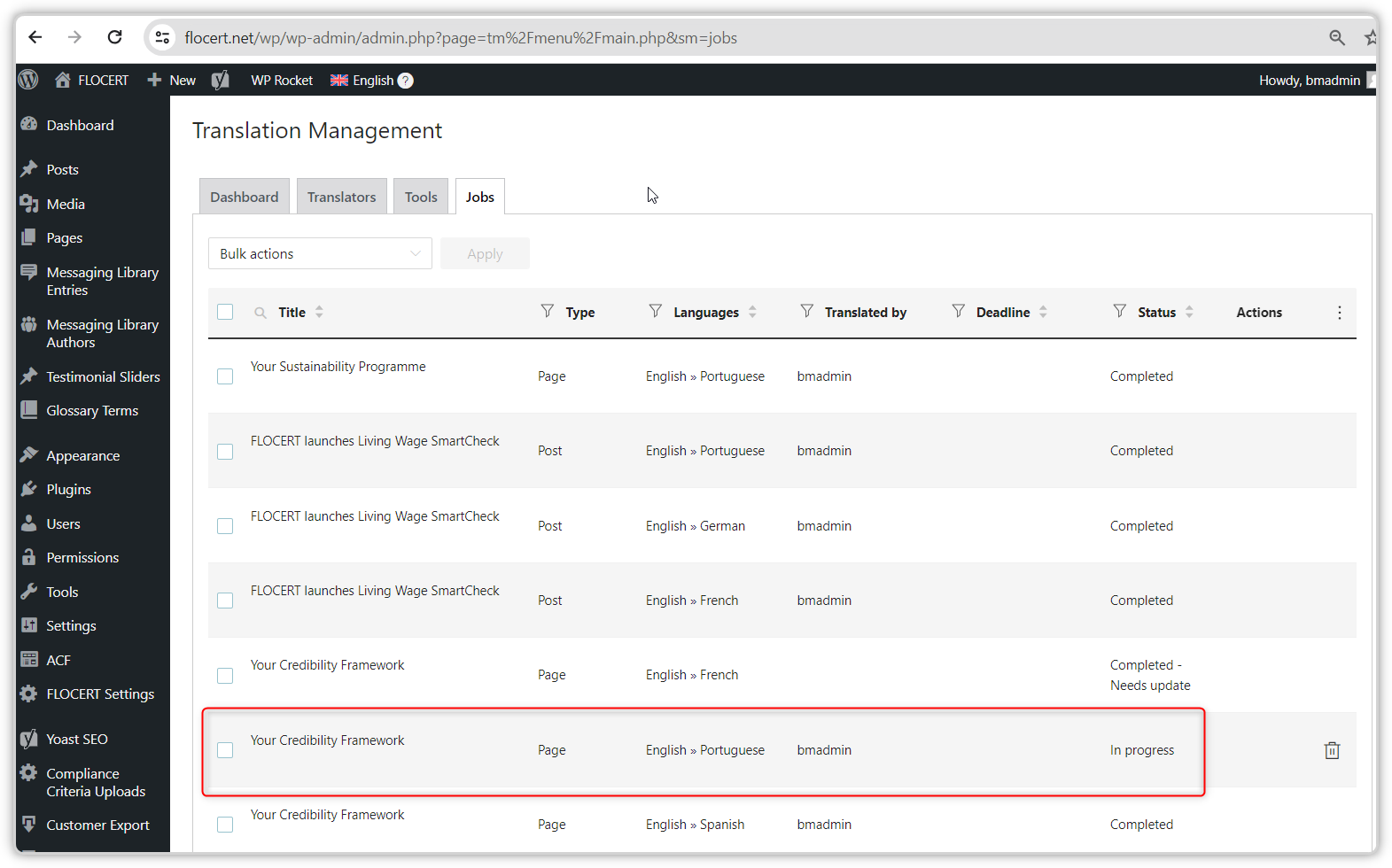

We now have the same problem again - one of the translation is jobs is stuck showing as "In progress", even though I have marked it complete in the ATE.

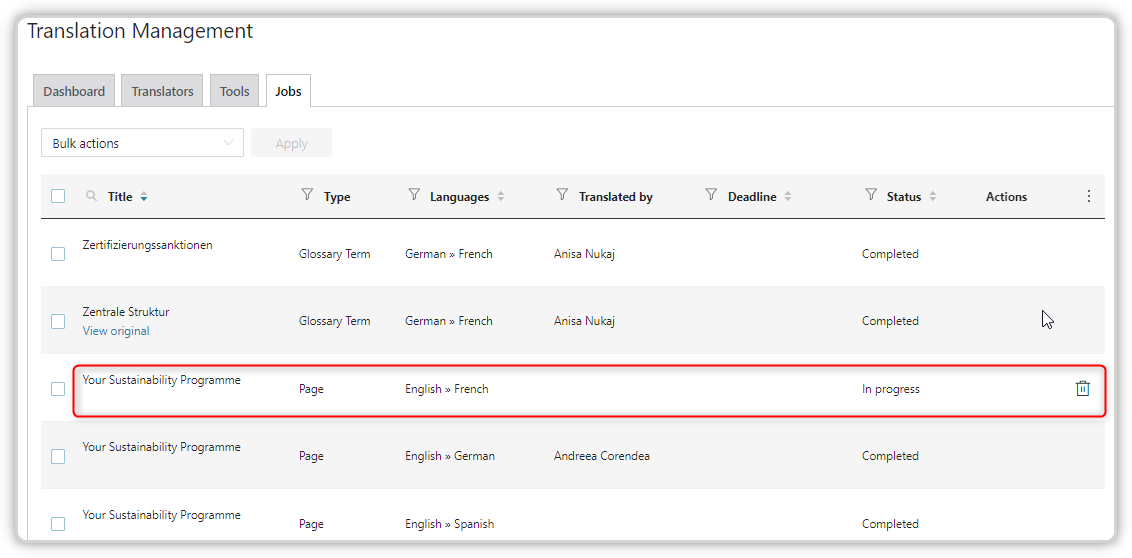

There is currently one job stuck "In progress" - see the attached upload.

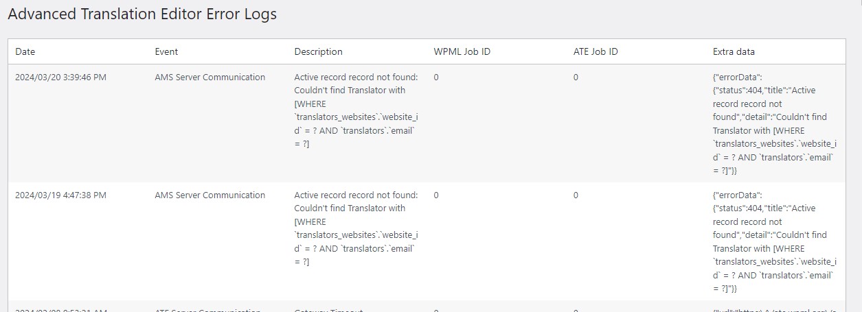

I observed the problem, although everything looks fine but there are a few things which may need attention:
- For example, in ATE logs there are errors about missing data about translators (see attached - ate.jpg).
- In jobs, I see that the one you mentioned had been completed already (see attached - jobs.png).
So, I could fix this but some needs your input, as well as, since it is a live site and its better if you try this out. Please check this thread https://wpml.org/forums/topic/the-advanced-editor-jobs-synchronization-has-failed-4/#post-12430543 for detailed steps and it should fix the problem.
