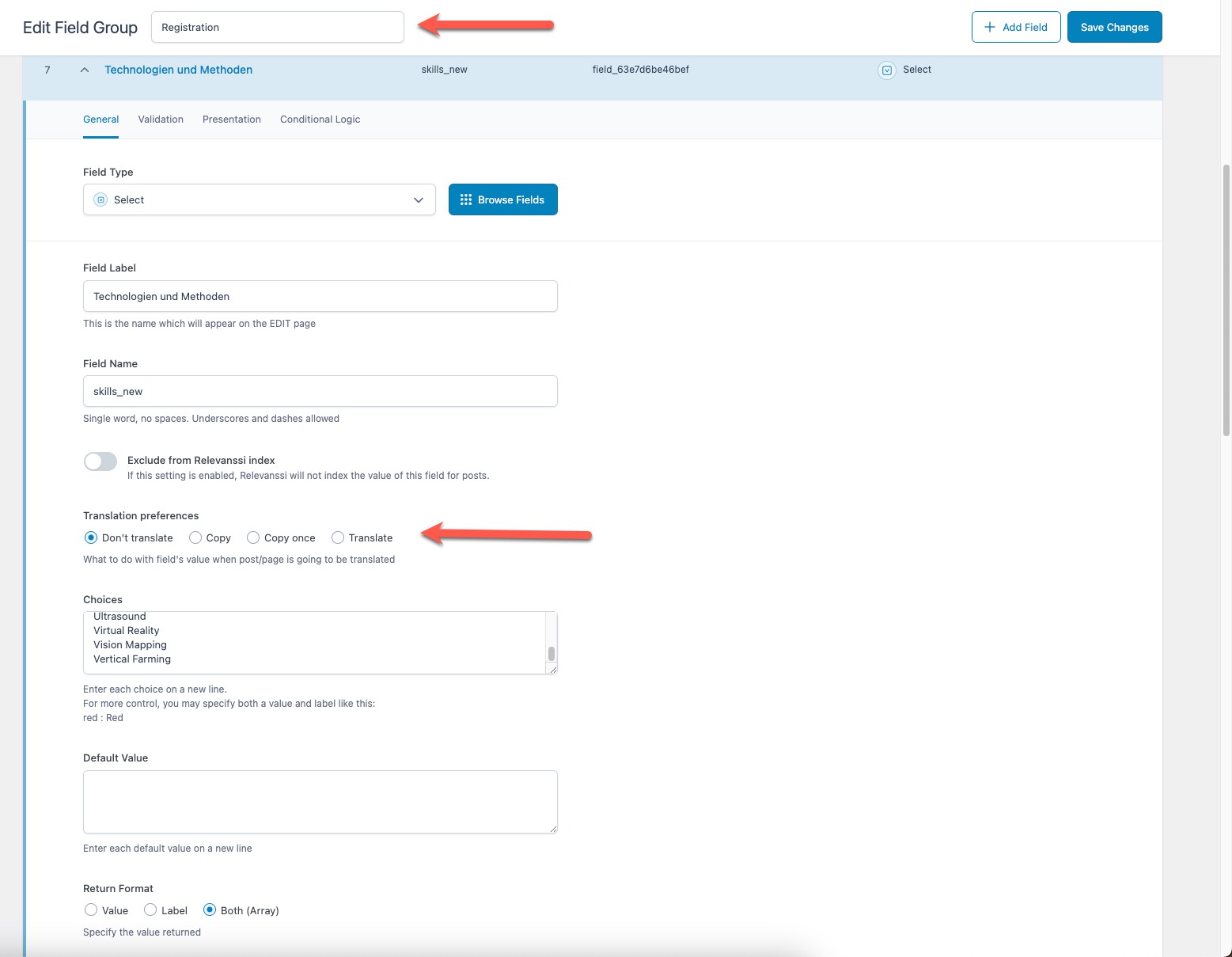

The client has a registration section on their website with 70 select buttons. When trying to translate the registration, 65 fields are translated correctly, but 5 fields do not appear on the English version of the website.
We checked the "Registration" field group and found that the fields were set to "Don't Translate". We recommend setting the translation mode to "Same Fields Across Languages" as on the staging site, or changing the field setting to "Copy" instead of "Don't Translate". Here are some guides to assist you:
After making these changes, please update the registration post in the default language and its translations.

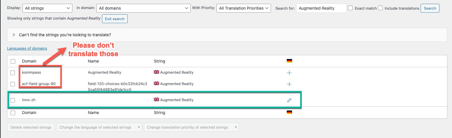

I've done everything the same as in video, but when I translate my registration no skills show up in the English language. I will try to give you the access but until then do you know how could I possibly fix this?
April 15, 2024 at 10:07 am #15518882
Osama Mersal
WPML Supporter since 02/2020
Please don't translate the strings in any domain other than the "inno-zh" domain.
Osama
April 15, 2024 at 10:15 am #15518946
sanjaP
I didn't make any other translations. Is there an example on dev website, so I can display the skills in english?
April 15, 2024 at 10:20 am #15519051
Osama Mersal
Please check the attached screenshot.

Thanks for the access details. I checked the "Registration" field group, and the field is set to "Don't Translate". (Kindly check the attached screenshot)
I recommend using the "Same Fields Across Languages" translation mode in this field group, the same as the staging site.
Or set the field to "Copy" instead of "Don't Translate". Kindly check the following guides:
1- https://wpml.org/documentation/related-projects/translate-sites-built-with-acf/
2- https://wpml.org/documentation/related-projects/translate-sites-built-with-acf/expert-translation-option/
3- https://wpml.org/documentation/related-projects/translate-sites-built-with-acf/recommended-custom-fields-translation-preferences-for-acf-and-wpml/
After changing the translation mode or translation preference for the field, please update the registration post in the default language and its translation.

I have the fields back, so that works, thank you! However, I did everything again the same as in the video you sent me, but I'm still missing the 5 fields when i translate the registration to English.
