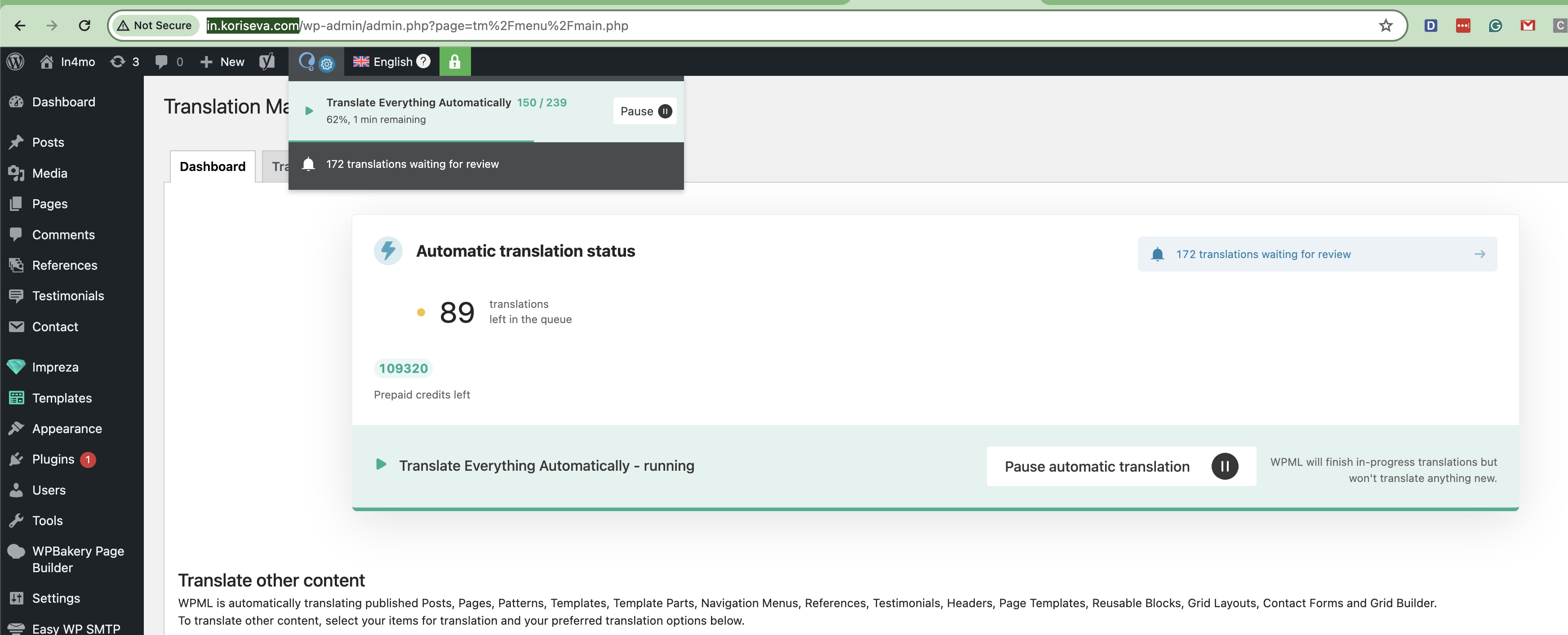

I have 5 additional languages. I selected automated translations as option and progress for translation started. I ran out of credits and they were added. I paused the translation progress and restarted it to get rid of the fixing box. Translation progress started spinning again.
After hours of waiting, I am still seeing the same.. translate progress running.
I still seem to have 113040 credits left (from 90000+200 000 ). I have 263 translations in queue. This has been so for several hours.
On the top, the spinner has all the time shown Translate everything automatically 0/263
0% 3min remaining.
I can see in WP dashboard on different pages that they do have translations.
Everything is still spinning and in all pages it says translation in progress, 1 hour remaining.
On frontend navigation has been translated. There is nothing in the content area: no text, no elements/layout, just emptiness.

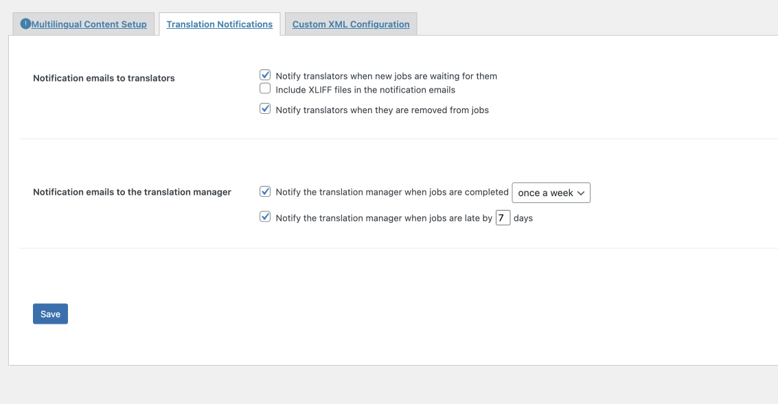

According to the Advanced Translation Editor error log in WPML > Support
Call to undefined function PHPMailer\PHPMailer\mail() /home/gsdgzbdzuw/domains/in.koriseva.com/public_html/wp-includes/PHPMailer/PHPMailer.php:881
there is an issue with the PHP mailer service on your site. So I go to WPML > Settings > Translation Notifications > Disable all notification options then the automatic translation works properly. Please check the attached screenshots.
I suggest you contact your hosting support to fix the issue with the PHP mailer service and you can re-enable the notification options again.
