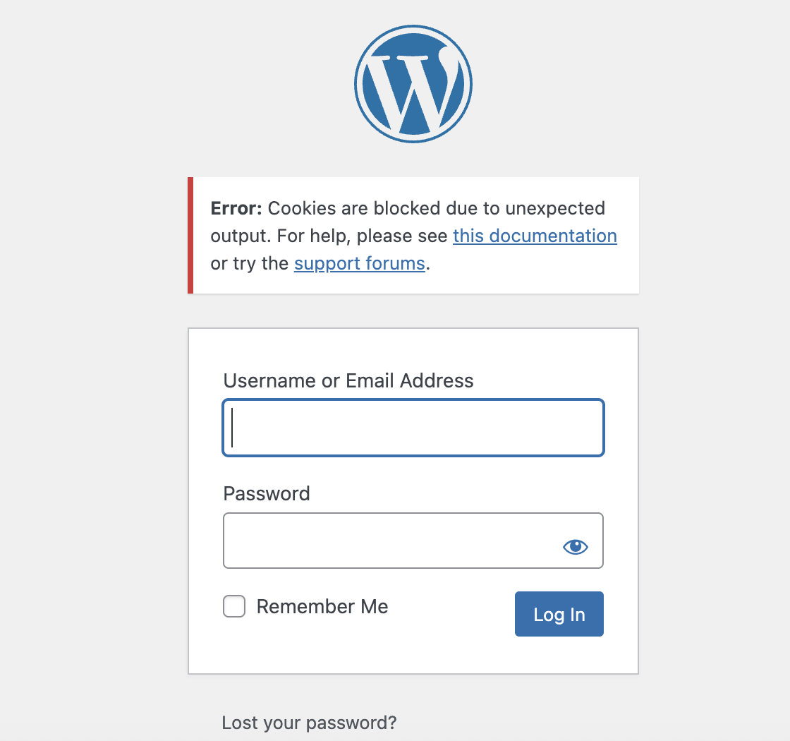

Thank you very much. I checked the other ticket and I am not sure if it is related as it is talking about review and not the translation itself.
I tried to login but I constantly get an error that I attached the screenshot.
Would you please help me to understand what might be the cause that I can not login?

This was because you asked me to set the 'WP_DEBUG_DISPLAY' to 'true'. Others experienced similar. I have disabled it but keep debug and logging true.

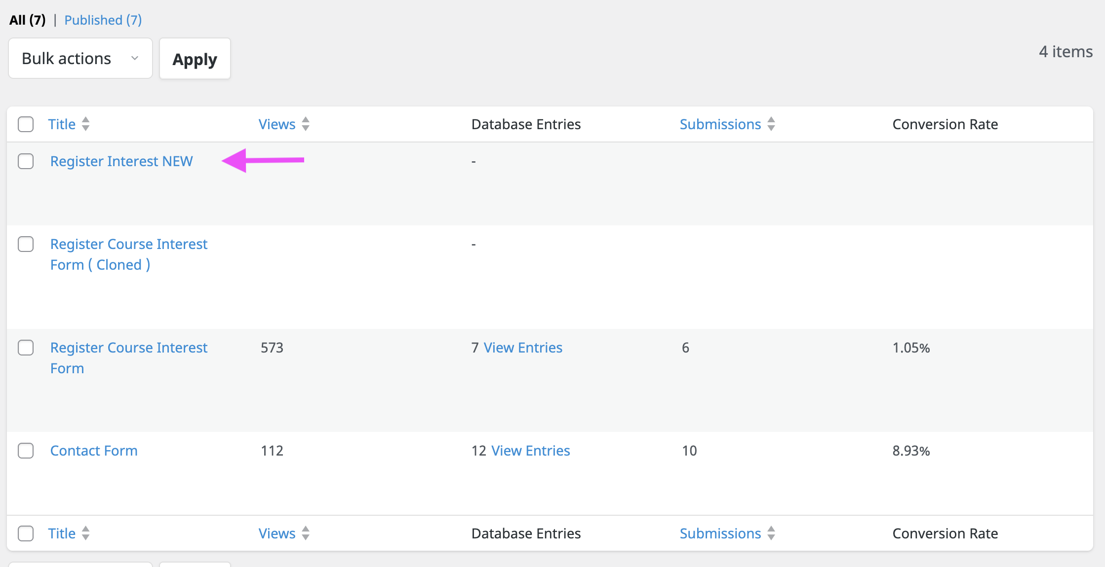

I have now created the register form from scratch and called it 'Register Interest NEW' - see grab attached. The only difference this time is that I haven't included the avada Honeypot or reCaptcha form elements.
Please have a go translating this one and the notifications and let me know the process you follow to translate it. If successful, how should I go about putting this in the existing or new global avada container?
