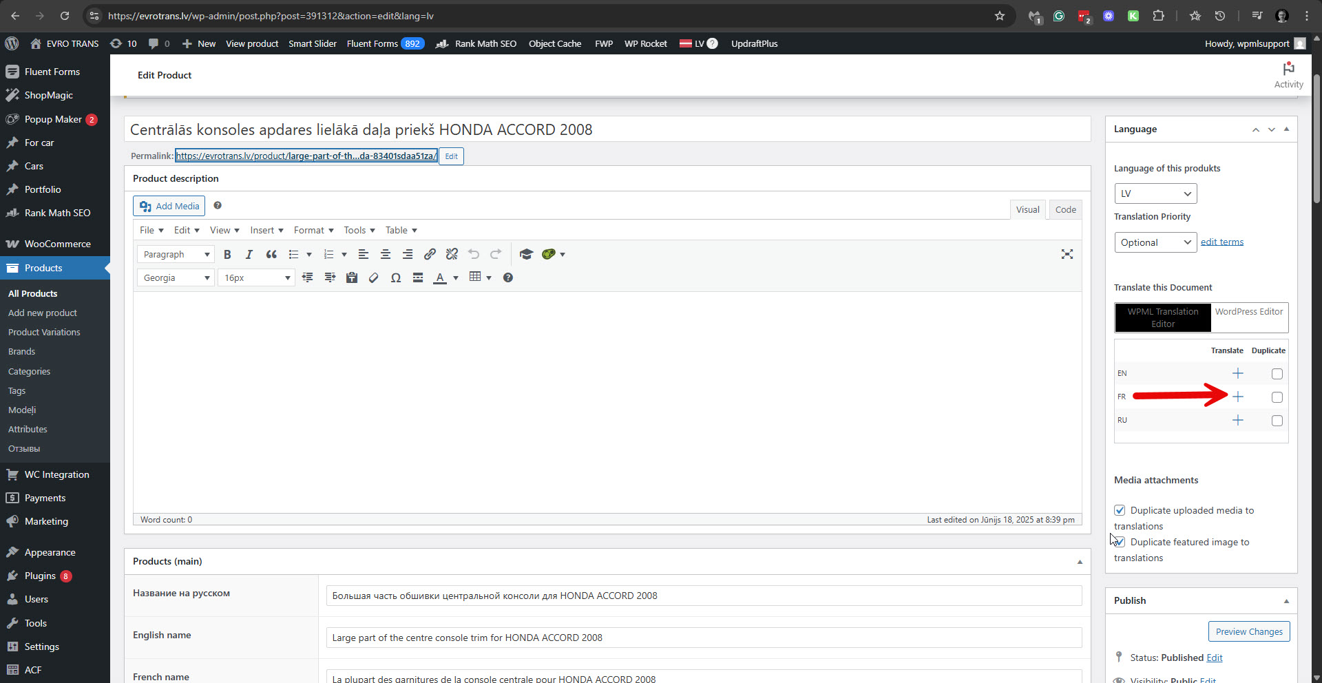

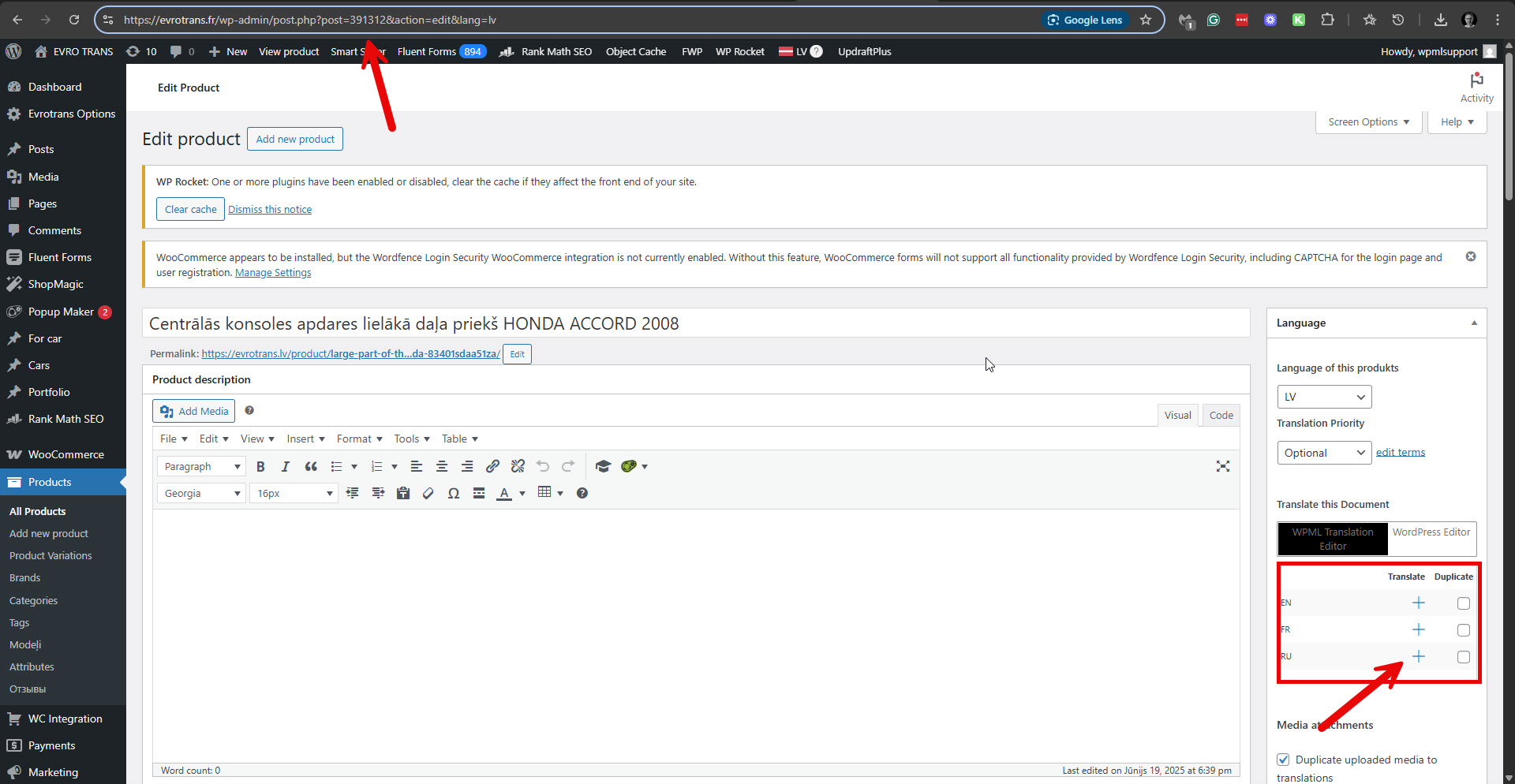

I checked this product hidden link and could see it has no translation into French (or any of the other languages. Please see the attached screenshot, no-fr-translation.jpg.Moreover, I can see that none of the products have translations into the different languages. It's possible that all the translations are in draft status. Please see the attached screenshot list-of-all-products.jpg. This typically occurs when you import products into your site but fail to complete the import process using the WPML Export and Import plugins.
https://wpml.org/documentation/related-projects/wpml-export-and-import/
In any case, the missing translations explain the redirection. WordPress is working to resolve this issue and therefore provides the product in the default language.
Itamar.

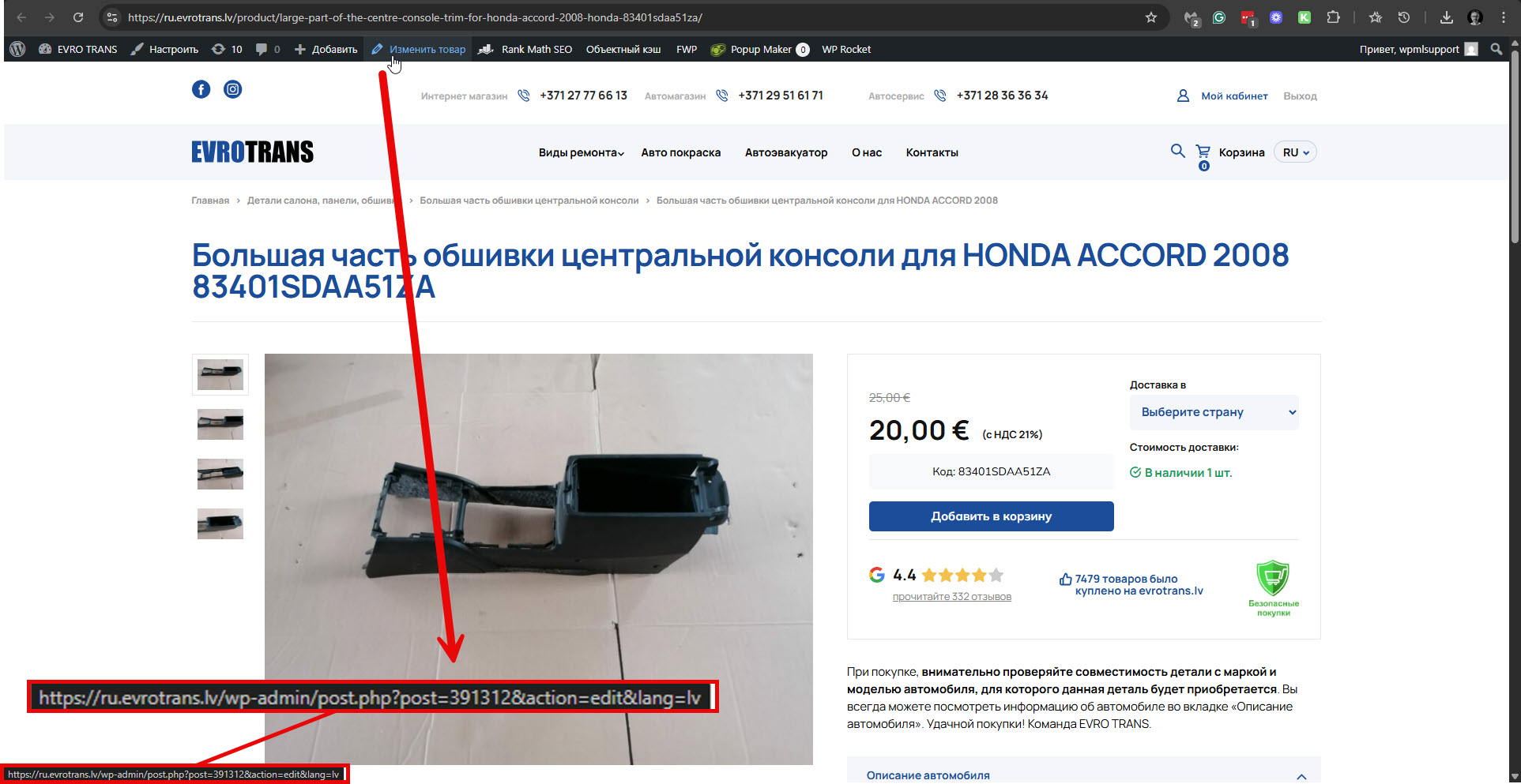

I see what you are saying, however all translations are in place. For example product that we discussed
Here are translations -
Latvian (original) - hidden link
French - hidden link
Russian - hidden link
English - hidden link
I assume this happens because all translations are done on the fly. Is there a workaround for our case?
