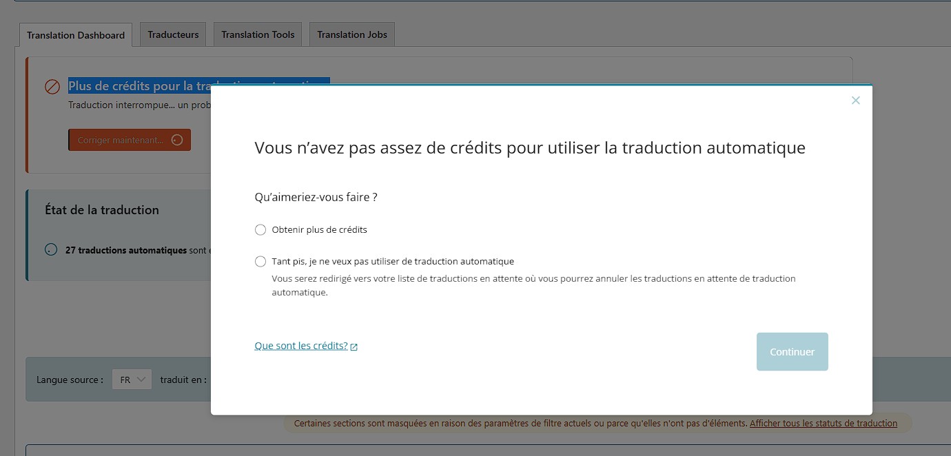

May 13, 2025 at 2:43 pm #17028592
About your example:
See the right sidebar of WordPress Editor on the original page.
The automatic translation could not be completed as you ran out of credits.
You can see further information about this at WPML > Translation Management:
"Plus de crédits pour la traduction automatique".
Click the dialog to correct the issue and choose that you would like to translate yourself or add more credits for automatic translation. See screenshot.
