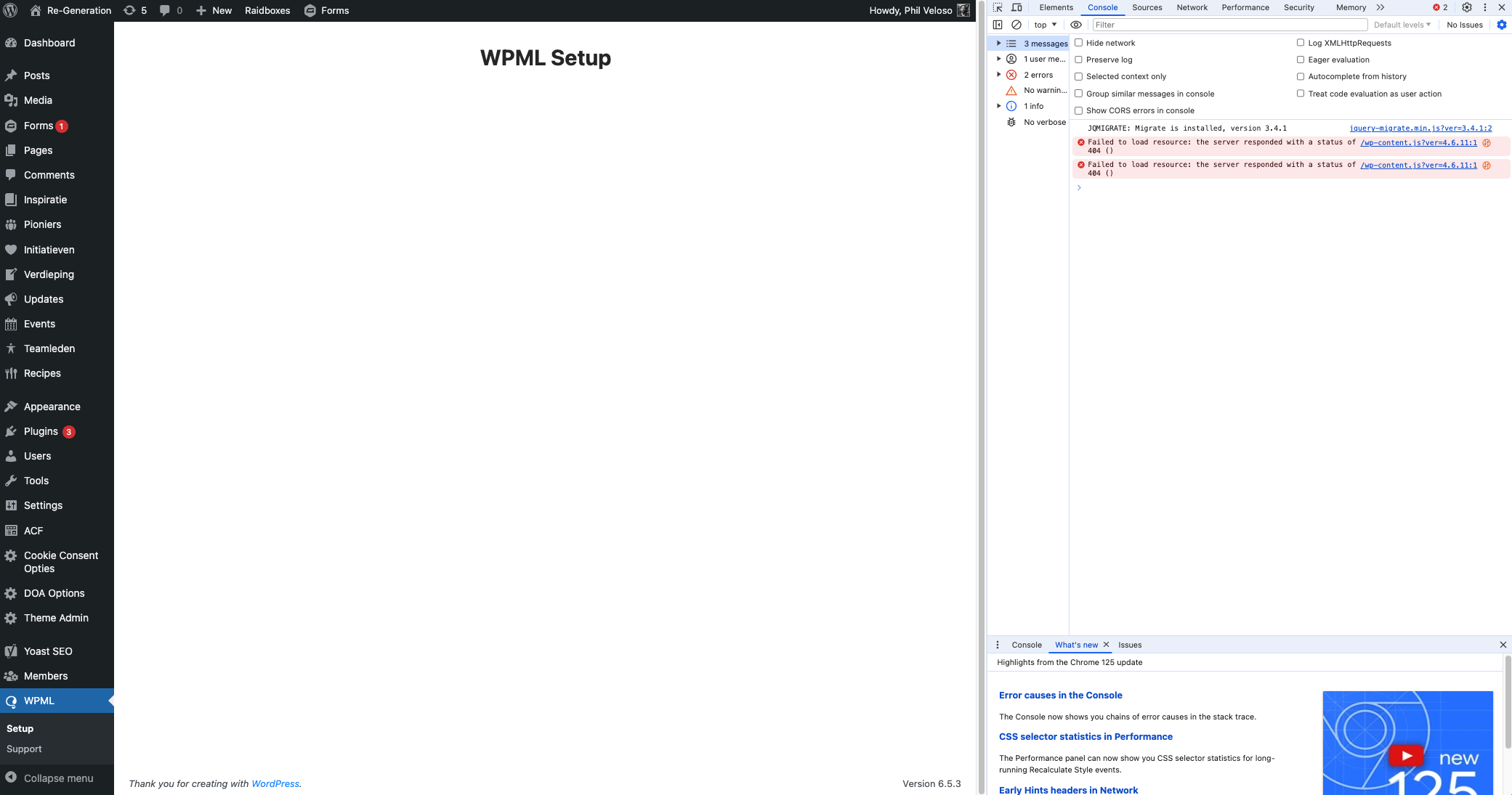

June 4, 2024 at 3:29 pm #15702869
philV-4
I have two errors:
/wp-content.js?ver=4.6.11:1
Failed to load resource: the server responded with a status of 404 ()

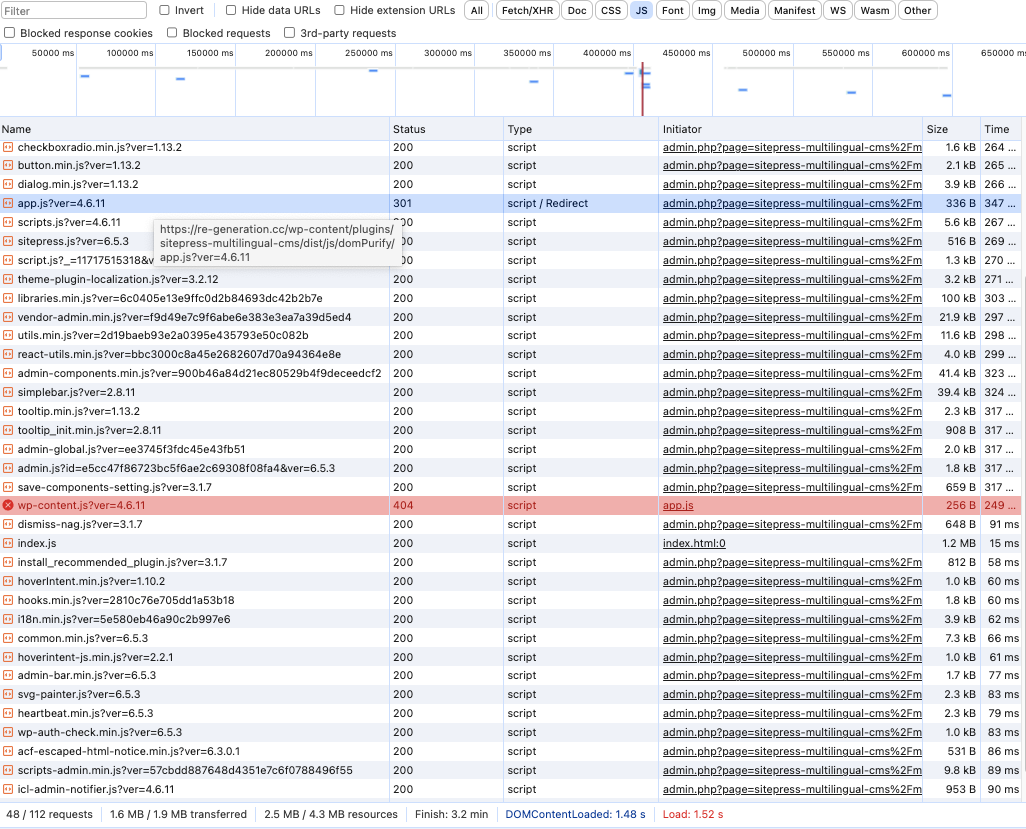

June 4, 2024 at 3:39 pm #15702945
philV-4
some additional context
