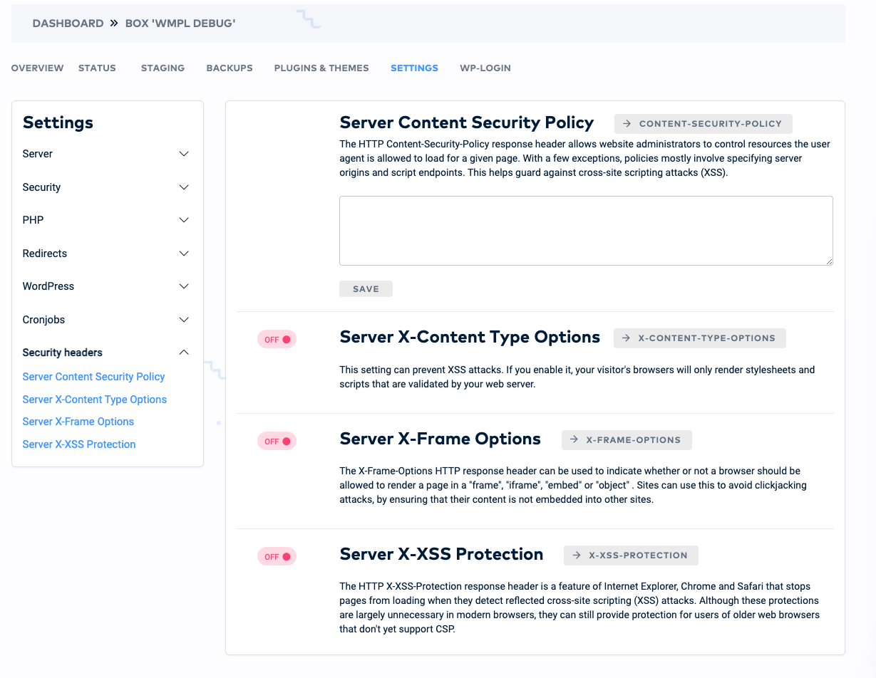

June 6, 2024 at 11:16 am #15710563
philV-4
Hiya,
Ihave spoken with the hosting and this was their reply:
Im having an issue setting up the WPML translation plugin on our site and their support team has suggested i set the header to: add_header X-Content-Type-Options nosniff; how can I do this?
Christian : You can only switch it on or off:
me -> what does that mean? what is the default
Christian : Default is on
me : have you expereinced issues with WPML plugin? it
Christian : No, we have many customers who use it.
I have disabled all Security headers

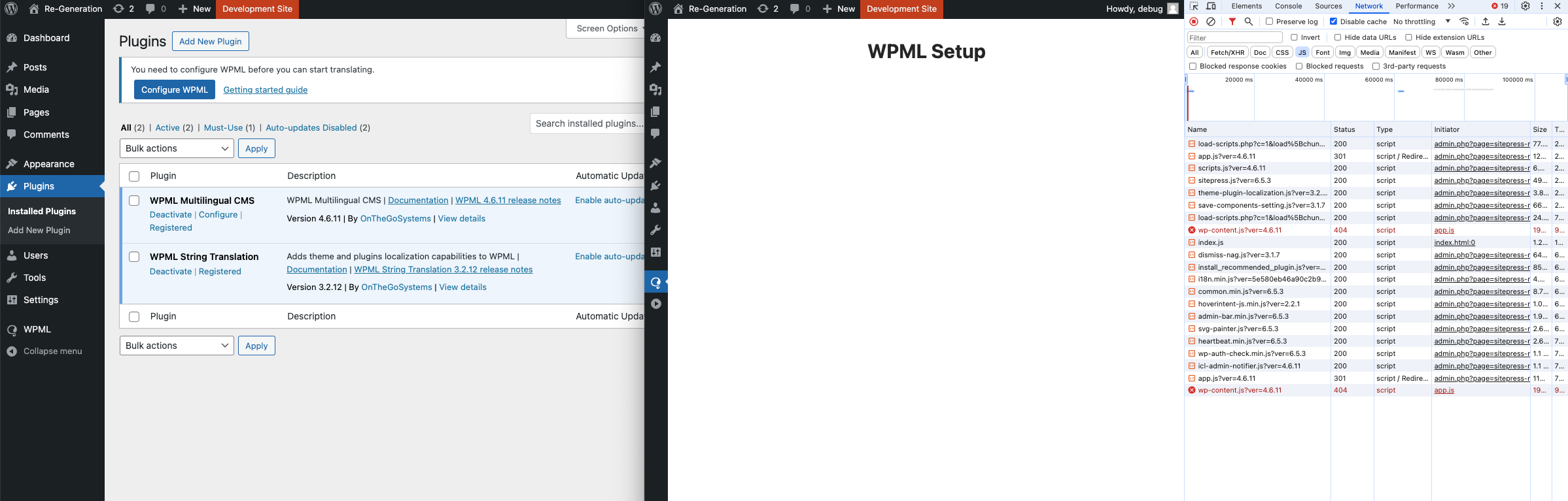

June 6, 2024 at 2:53 pm #15712145
philV-4
I have deleted all the other plugins except WPML and the setup page does not initialize.
June 6, 2024 at 2:56 pm #15712190
philV-4
I have also tried the Rest and Clean up operations in the Troubleshooting section and neither option fixed the issue.
Could this be a firewall issue on you side?
