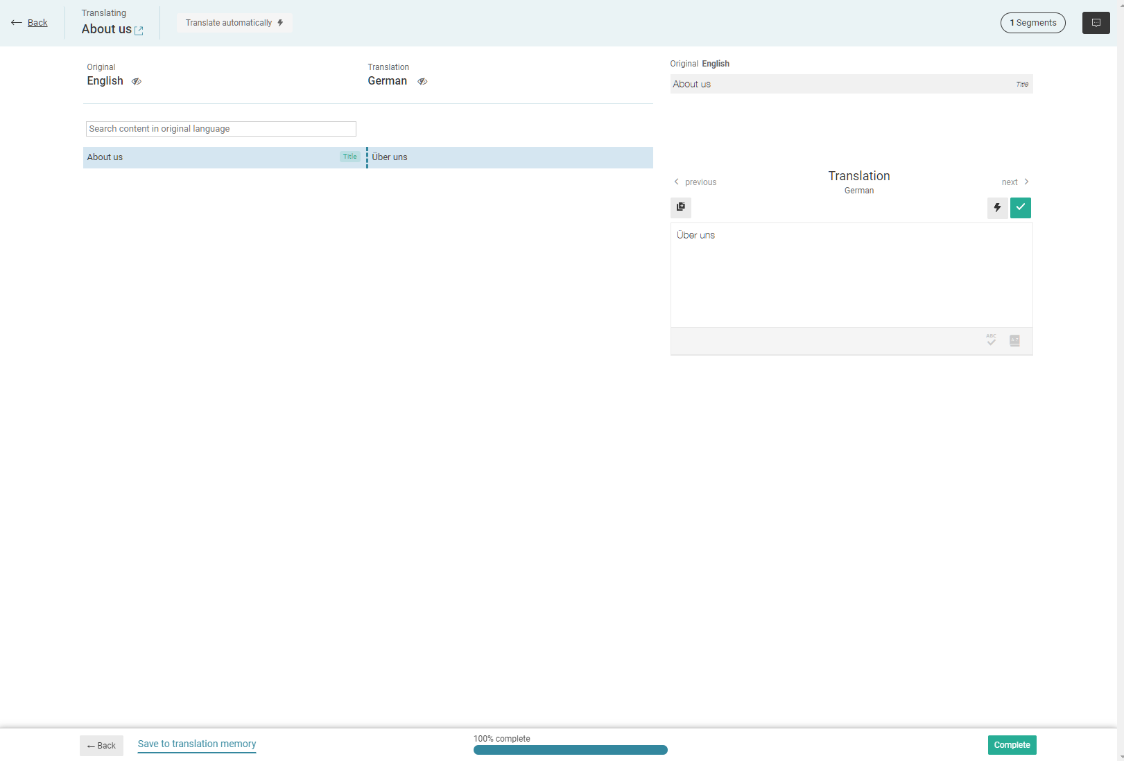

I am trying to translate my Site. I wish to use automatic translation, and I entered all neccessary information for Pay-as-you-go service. However, when I add the page to Translation management, I gow just a title of that page. So, I can't translate anything but the title. You can see the screenshot attached.

Please enable the WPML String Translation plugin (https://wpml.org/download/wpml-string-translation/?section=changelog) then the issue will be fixed. The plugin was not activated on the sandbox and doesn't exist in the list of your plugins.
After activating the plugin then updating the About Us Page on the sandbox, all the content was available in the translation editor as you see in the attached screenshot.
For the pages that are already exist, please update them with the following steps:
1. Edit the page in the default language
2. Make a small change and update it
3. Send the page again for translation
