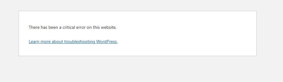

Hello, for weeks now, we are getting a "critical error" if we try to access this link in English hidden link
It works in French and on all other action taxonomies.
Your assistance would be much appreciated.

Thanks for your permission. I investigated the issue in detail, and here’s what I found so far:
Summary of Findings
  • The fatal error is caused by memory exhaustion during a database operation (wpdb).
    This is why the server returns a 500 error, and WordPress displays the “critical error” page.
  • The issue is not caused by WPML alone:
    • The page remains very slow even when WPML is deactivated, which indicates that the root cause lies in the theme or query logic.
    • WPML may add some overhead (such as additional joins for language filtering), but it is not responsible for creating the heavy query that exhausts memory.
  • The issue appears to be specific to the first page of the archive:
    • /action/phuket-villa-for-rent/page/2/ loads correctly.
    • /action/phuket-villa-for-rent/ (page 1) fails with a memory error.
    This strongly suggests that additional logic is executed only on page 1 (for example: map pin generation, featured listings logic, advanced search initialization, etc.).
  • The issue was successfully reproduced locally after importing the theme settings (WpResidence / WpEstate options).<br> This confirms that the trigger is very likely related to a specific theme setting (or a combination of settings), rather than the number of listings (the archive shows only 18 listings with pagination).
Most Likely Causes
Based on comparing the working and failing theme configurations, the differences point to features that can generate heavy queries on taxonomy/archive pages, especially:
  • Custom URL rewrites (including the
    action
    rewrite slug)
  • Custom advanced search and large custom fields configuration
  • Map / half-map related behavior (pin generation, clustering, etc.)
  • Theme cache / minify settings
