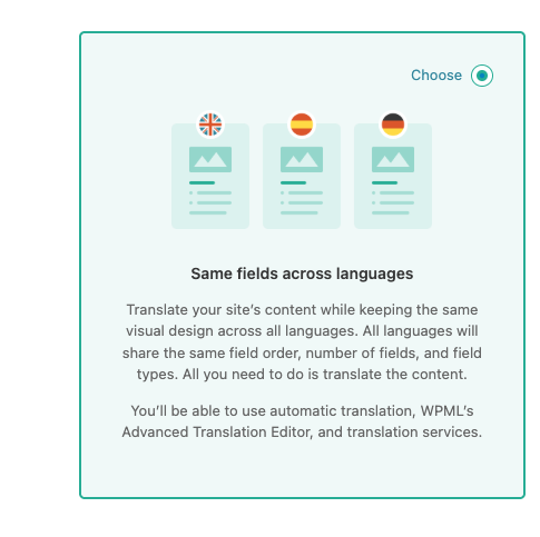

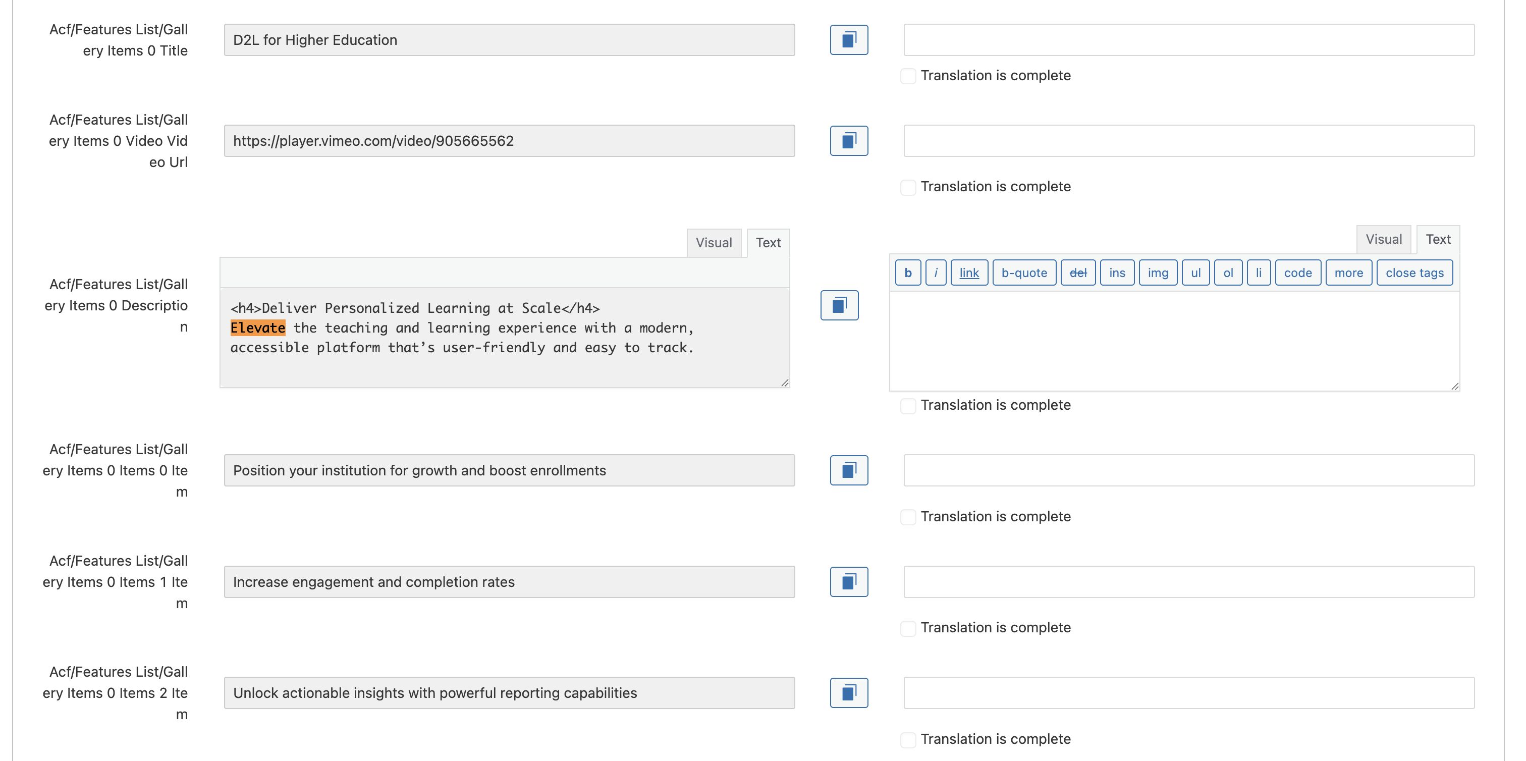

I am trying to send pages for translation to a translation service using WPML. We are using ACF, and the button in our blocks are using the Link field type. Our blocks are using 'same fields across languages' but I have also tried 'different fields across languages'.
The buttons/links are not being sent for translation, while all other fields are being sent correctly.
Why are the buttons/links not being sent for translation?
Is there a specific setting in WPML or ACF that needs to be adjusted for button/link translation?

Thanks for contacting us. Based on your screenshot, I can see that you've configured this correctly.

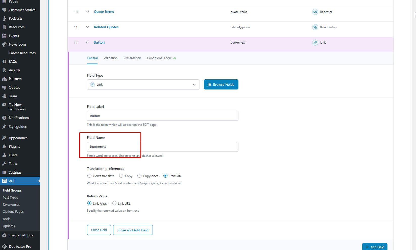

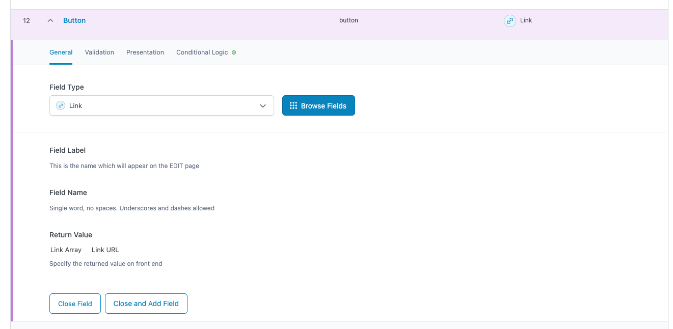

Thanks for your patience. I have some feedback from our 2nd Tier Support, and they found out that the issue is caused by the button field name conflicting with another button field name. Please use a unique name for all your fields to avoid conflicts. I've attached a screenshot for our reference. Let me know how it goes.

Thanks for your reply. Our 2nd Tier Support also mentioned the below. Could you try the solution we shared above and let me know if this works for you?
As this is a repeater field, I suggest checking for other instances of the button subfield - as this can conflict.
