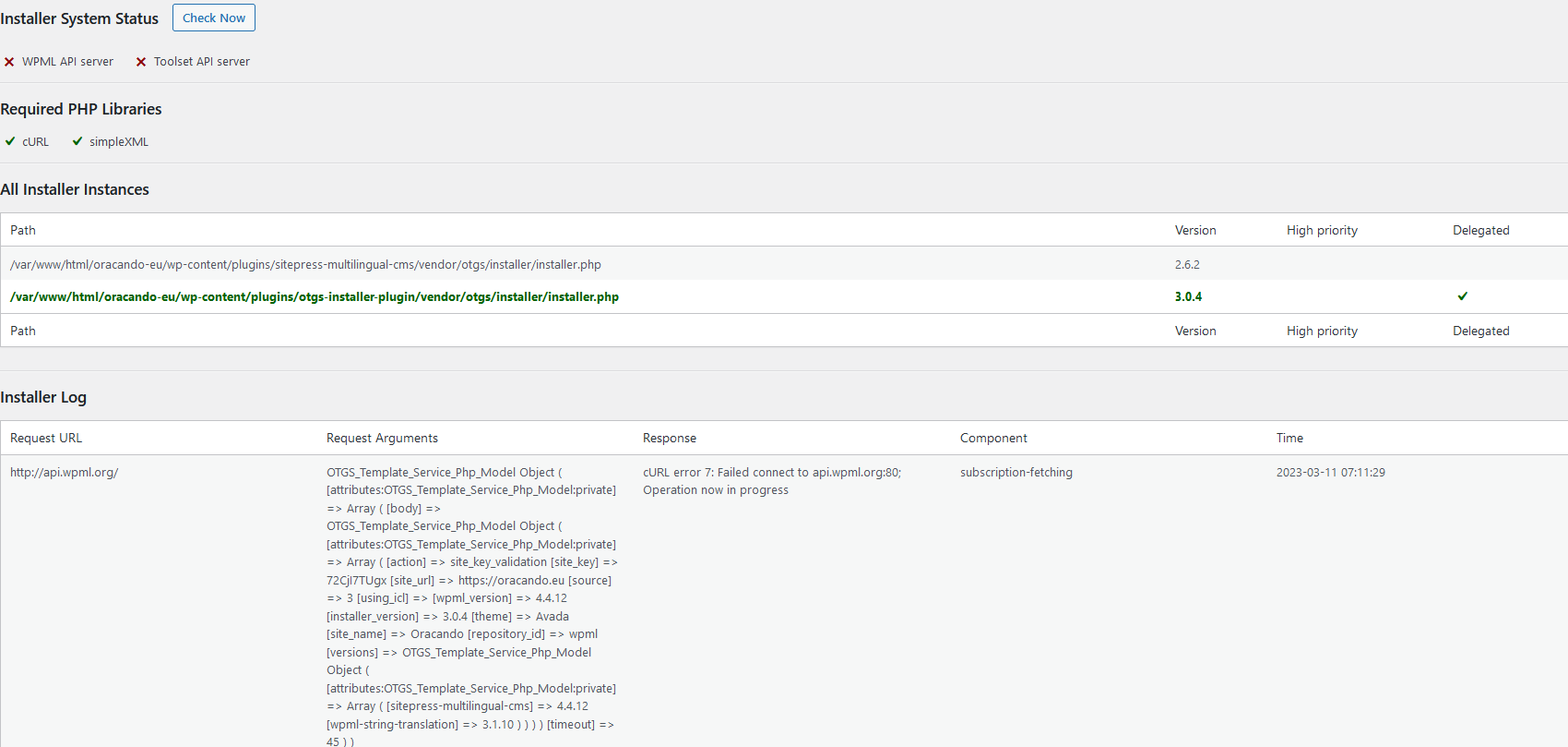

Hello! Thank you very much for your assistance! The ssl is automatically generated and renewed, it' s letsEncrypt. I attach the screenshot you asked. Thank you once again.
November 6, 2023 at 6:10 pm #14740969
Ilyes
Thank you for the screenshot,

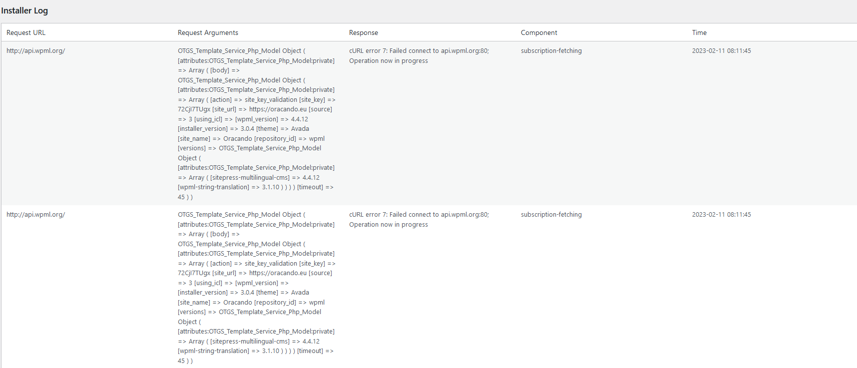

As you can see here : hidden link , both our API's are not working properly, and after verifying with our systems team to check if we got anything about your site on our servers,
The problem seems to be on your site itself. Your host is probably blocking the outgoing connection to our API. Please re-contact your host to check if they are indeed blocking api.wpml.org.
From our side, we are not seeing any connection coming in from both your sites :
That means the request wasn't sent from your server yet or it is blocked. (You could ask for the log file of all requests sent to api.wpml.org)
Other things you could consider is to update your WPML plugins to latest version (current version your are using is outdated) and to re-generate and register another key.
Best,
