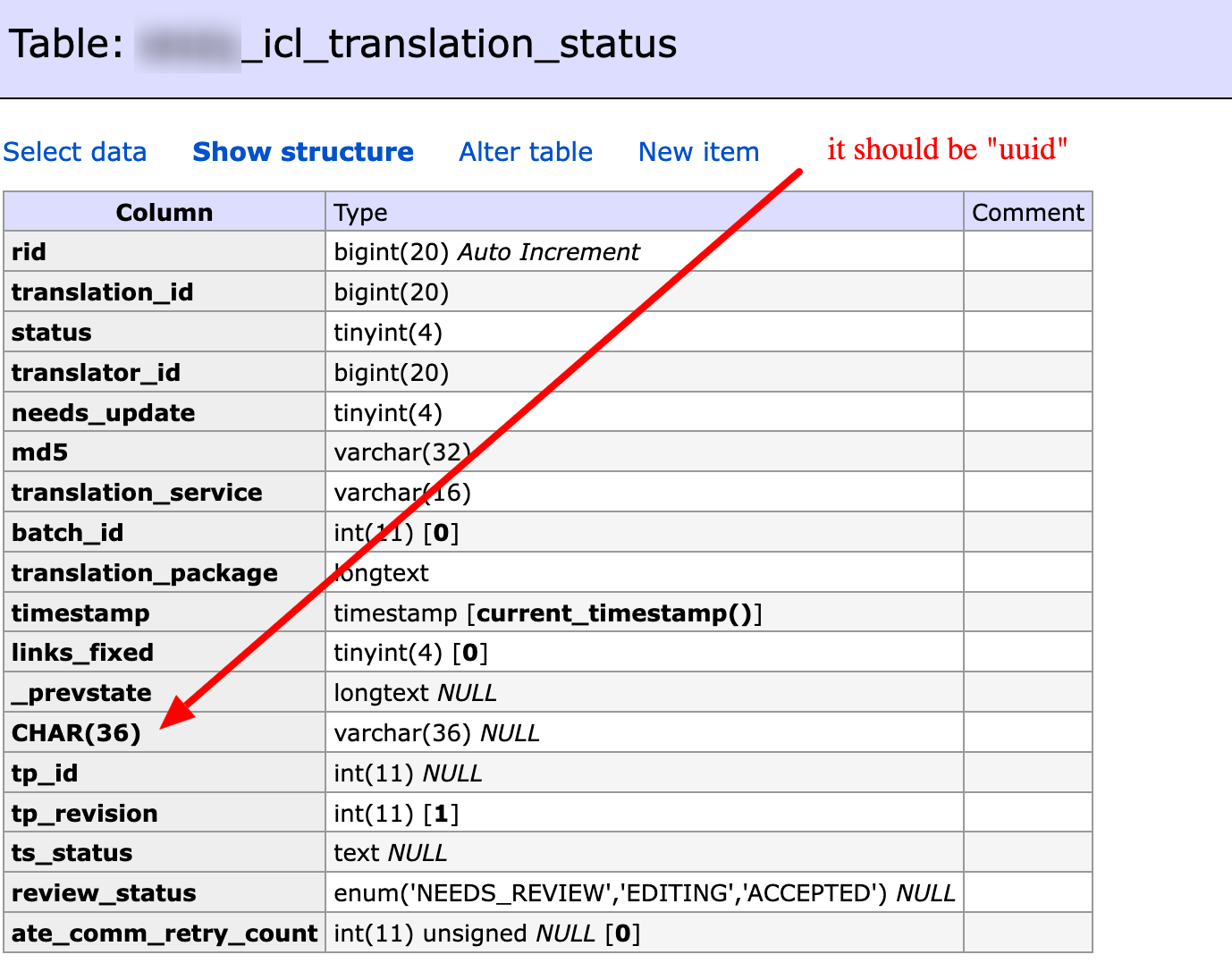

We discovered that the 'uuid' column was incorrectly named in your database. To resolve this, we temporarily installed the Adminer plugin to access and modify your database. We renamed the incorrect column to 'uuid', which fixed the issue. After verifying that the problem was resolved, we removed the Adminer plugin and the copy of your site.

I appreciate your patience. I have investigated this further on the local enviroment and found out that the following errors exist when attempting to translate the page:
[30-Mar-2026 14:07:21 UTC] WordPress database error Unknown column 's.uuid' in 'field list' for query SELECT j.rid,

			            LIMIT 1 made by set_current_screen, WP_Screen->set_current_screen, do_action('current_screen'), WP_Hook->do_action, WP_Hook->apply_filters, WPML_Translations_Queue->load, WPML\TM\Editor\Editor->open, WPML\FP\Right->map, WPML\TM\Jobs\Manual->createOrReuse, WPML\TM\Jobs\Manual->createLocalJob, WPML\FP\Just->map, WPML_Translation_Job_Factory->get_translation_job_as_active_record, WPML_Translation_Job_Factory->get_translation_job, WPML_Translation_Job_Factory->retrieve_job_data
The database table was missing the required column "uuid". So, I went ahead and temporarily installed the Adminer plugin to access the database.
The column itself was present, but it had an incorrect name. I renamed it to "uuid", which resolved the issue. After completing the fix, I removed the plugin and the copy of your site.
I’ve attached screenshots for your reference.
