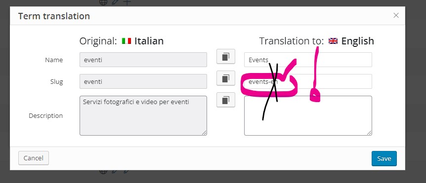

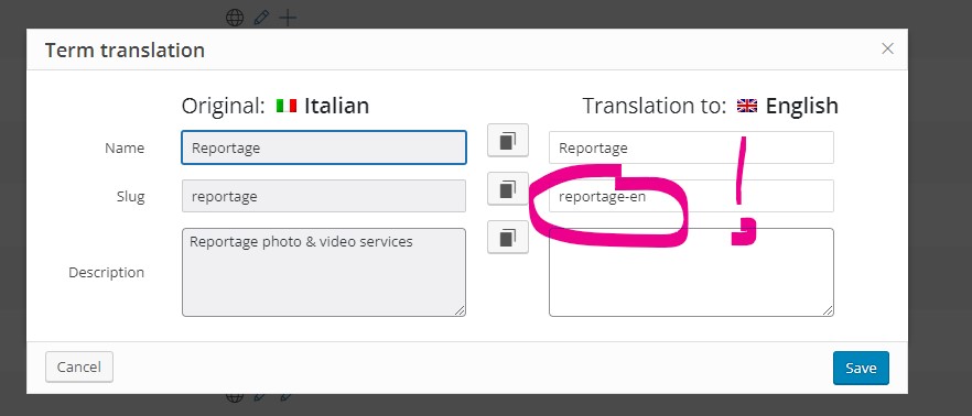

But in the "category translation" settings, the category should be translated as "reportage" and ""events" therefore the first url should be correct.
There apparently be an issue wiht WPML settings, were I cannot set correctly the taxonomy of the few CATEGORIES present in this website.
As you can see in the attached screenshot, slugs are added with the "-en" at the end of each catergory but this shoudn't be done, is should just translate the category as in the link pasted above. but the page is not created therefore it does not exist.

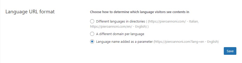

In the "Language URL format" tab is set as you can see on the attached image, is this correct?

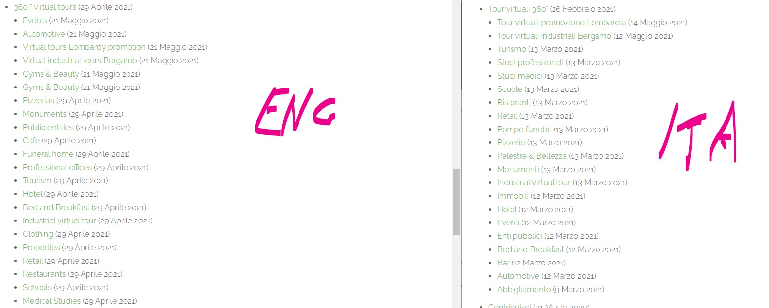

If you take a look at the html sitemap, it appears clear that the SLUG of the english version of the pages is not correctly translated, just the name of the page but not the other parts of the SLUG.
See attached image and look at the html sitemap for details.
Why the slug is not translated ?
So this is a WPML issue or not?

I try to copy the Italian setting but when saving it reverts to category-en format-.
By default, WordPress doesn't allow to have two identical term slugs. You can follow the documentation below to have the same term slug in different languages.
https://wpml.org/errata/translated-term-slug-identical-to-the-original-term-slug/
