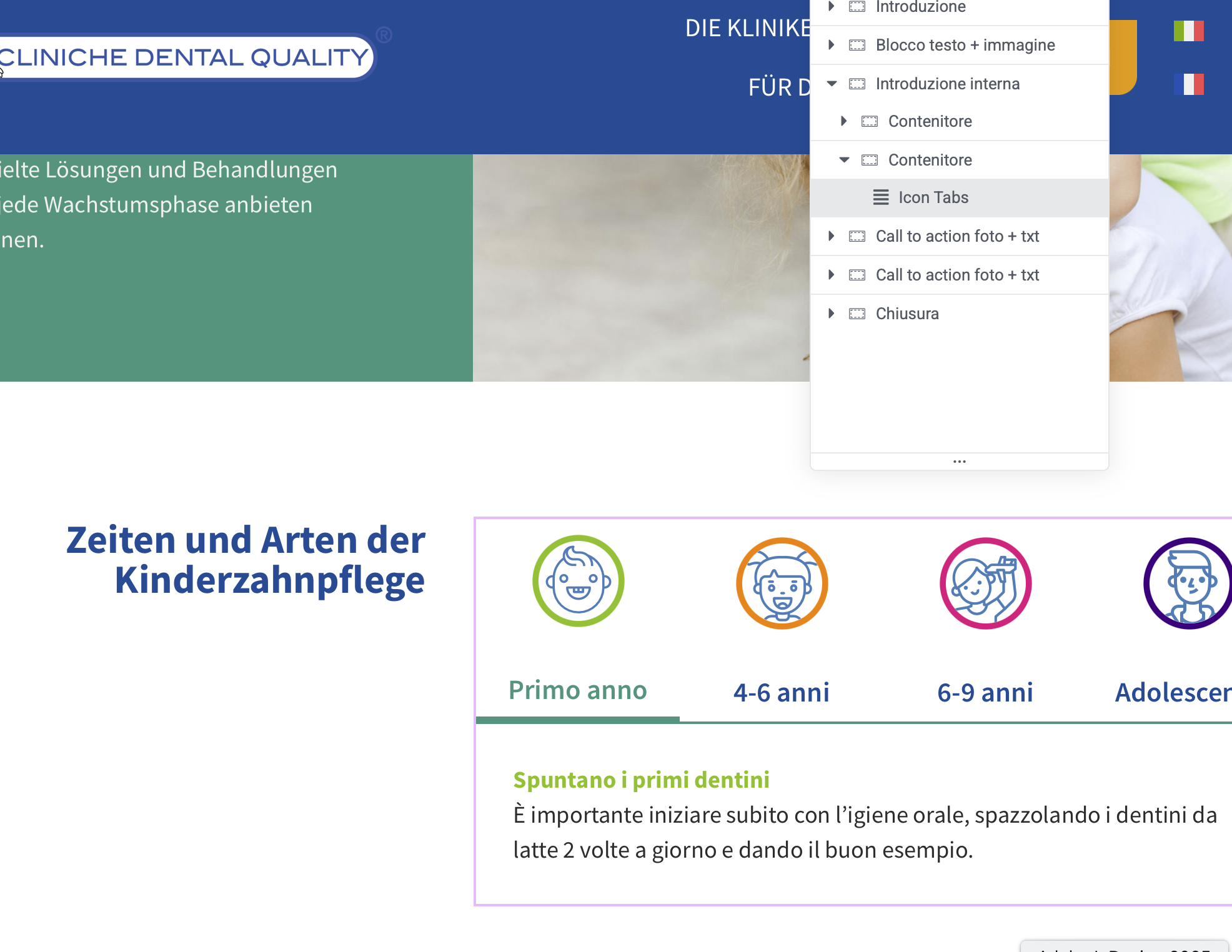

I can't find where to translate text from widgets used within the Elementor page. For example, on the page hidden link, there is a widget with icons that is still in Italian.
How can I find and translate text from widgets used in Elementor with WPML?

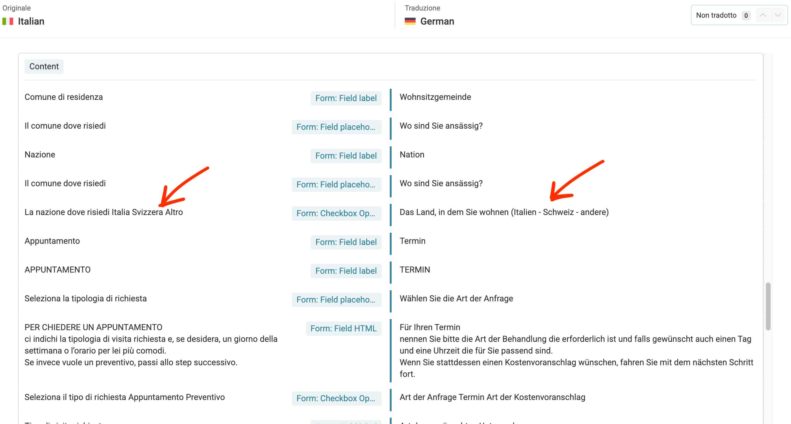

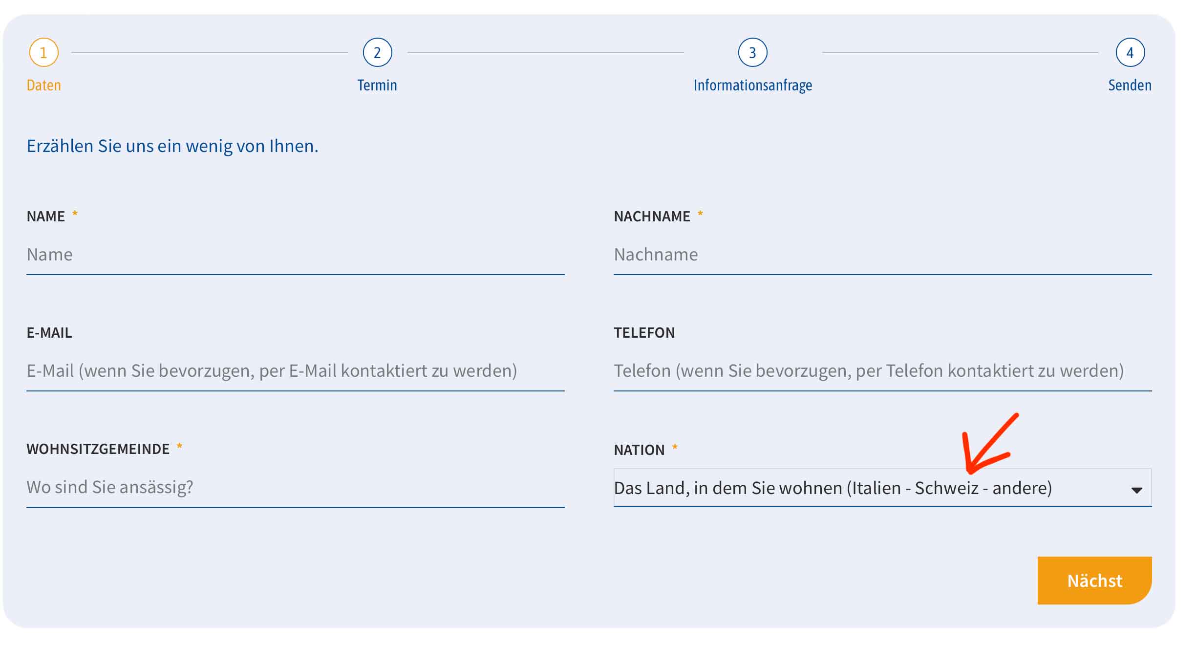

Hi Christopher, I am going on checking everything and I found out another problem. We have a form in the website (you can see it at the following address: hidden link) and some fields have multiple choices. In your plugin, I find the multiple answers as one line. Once I translate it I do find the translation in the form but as a single line, with no multiple choices. How can I fix this? I am sending you a couple screenshots that maybe can help explaining the problem. If you need more info I can specifcy more or give you access to our WordPRess dashboard. Please let me know. Thanks.
