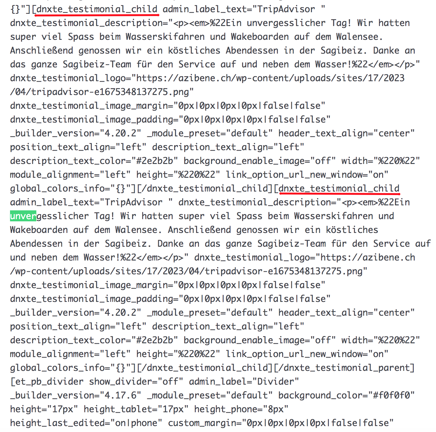

I'm working with the Divi Theme and WPML. With the mentioned site I encounter the problem that when using a module from the plugin "Divi Next" that has repeat items, they all have the same name. (See attached image). So I register the shortcode accordingy like this:
<shortcode>
<tag>dnxte_testimonial_child</tag>
<attributes>
<attribute>dnxte_testimonial_description</attribute>
</attributes>
</shortcode>
The problem is I will get only the first of these items to show in the WMPL translation page. How can i get the other items within that module to show up as well?
Thank you for your help.

The compatibility team managed to find a solution for the Testimonial element. Please add the code below to WordPress Dashboard > WPML > Settings > Custom XML Configuration.
<wpml-config>
  <shortcodes>
    <shortcode>
      <attributes>
        <attribute>dnxte_testimonial_name</attribute>
        <attribute>dnxte_testimonial_position</attribute>
        <attribute>company_name</attribute>
        <attribute encoding="allow_html_tags">dnxte_testimonial_description</attribute>
      </attributes>
    </shortcode>
  </shortcodes>
</wpml-config>
But please consider that we can not handle other elements as it seems the plugin does not have proper code to make its elements compatible with WPML.
Please contact the support of the plugin and ask them to contact us to get help make their plugin compatible via the form below:
https://wpml.org/documentation/support/go-global-program/
Thanks.
