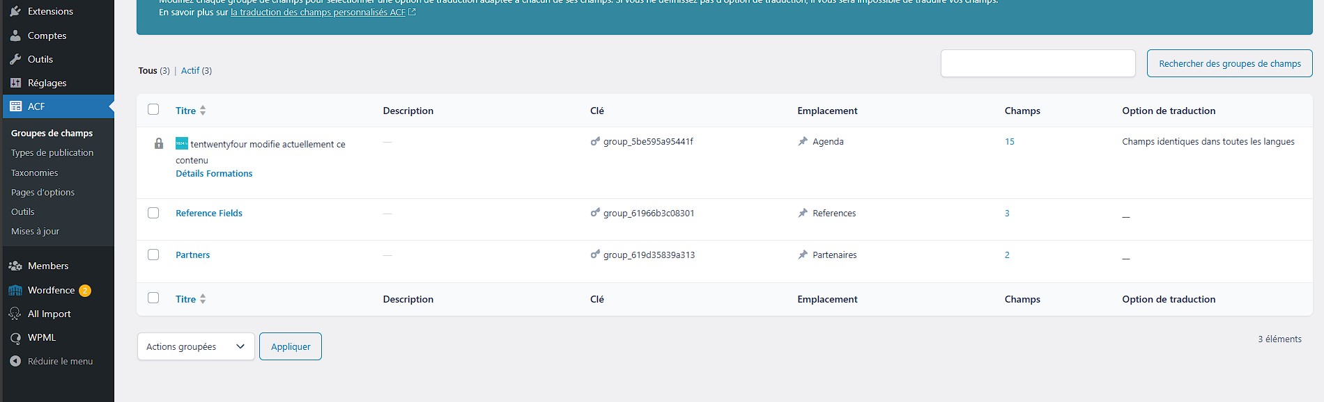

October 24, 2024 at 2:01 pm #16326765
At the moment I can not view the field group "Détails Formations" as a user is editing it.
Please make sure to set the translation preference for each field group, as seen on the screenshot. If you have any question about the options, please let me know.

October 24, 2024 at 2:44 pm #16326995
Please take a look on the screenshot.
Shall I try to overtake the editing?
