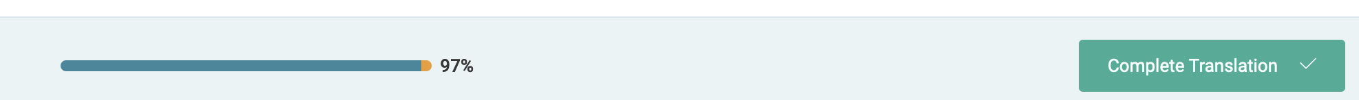

I'm translating the text in the classic editor on hidden link. All fields have been translated (all bars are blue, no orange indicating missing translations). In between saving translations, the level of completion goes to 100%, then drops down to 97% or 94%. No translation has been removed. All formatting markers have been applied. I have triple checked all translation fields. "php_value max_input_vars 10000" has been added to .htaccess.
The level of completion goes to 100%, then drops down to 97% or 94% after saving translations. I can't save the translated page.

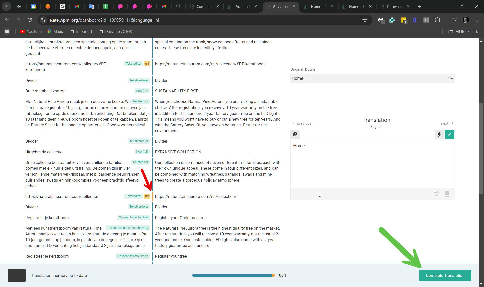

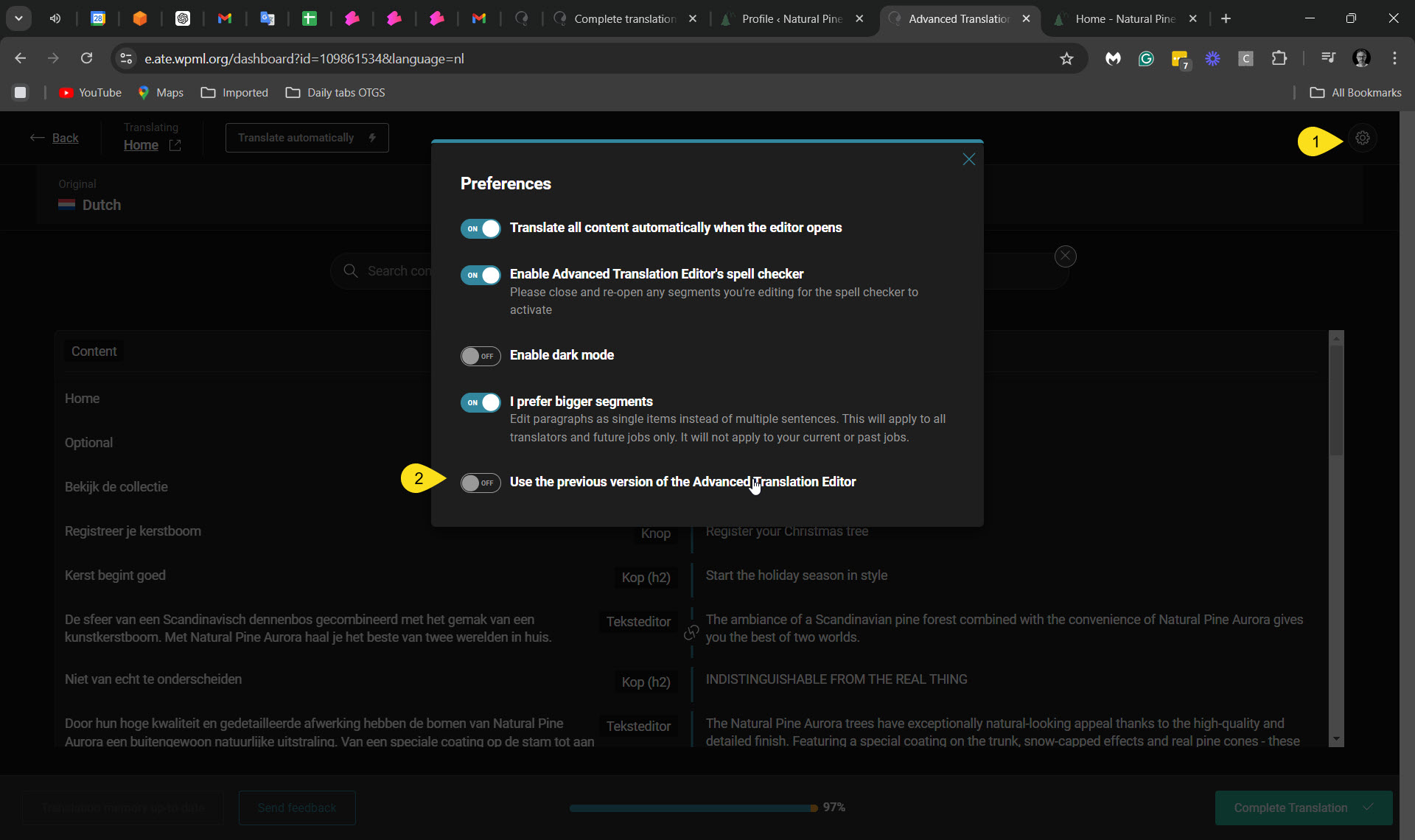

I could solve this issue by switching to the previous version of the Advanced Translation Editor. You can do that by clicking the gear icon at the top right corner. Please see the attached screenshot switch-to-previous-ate.jpg. After switching to the previous version of the Advanced Translation Editor, I could see that one link was marked as untranslated. However, this was an internal link, and WPML knows how to handle internal links in translation without marking them as complete. So, only clicking on the Complete Translation solved the problem. Please see the attached screenshot complete-trans.jpg. Now, the English page is published.
And its translation is complete. Please see the attached screenshot en-comlpete.jpg.

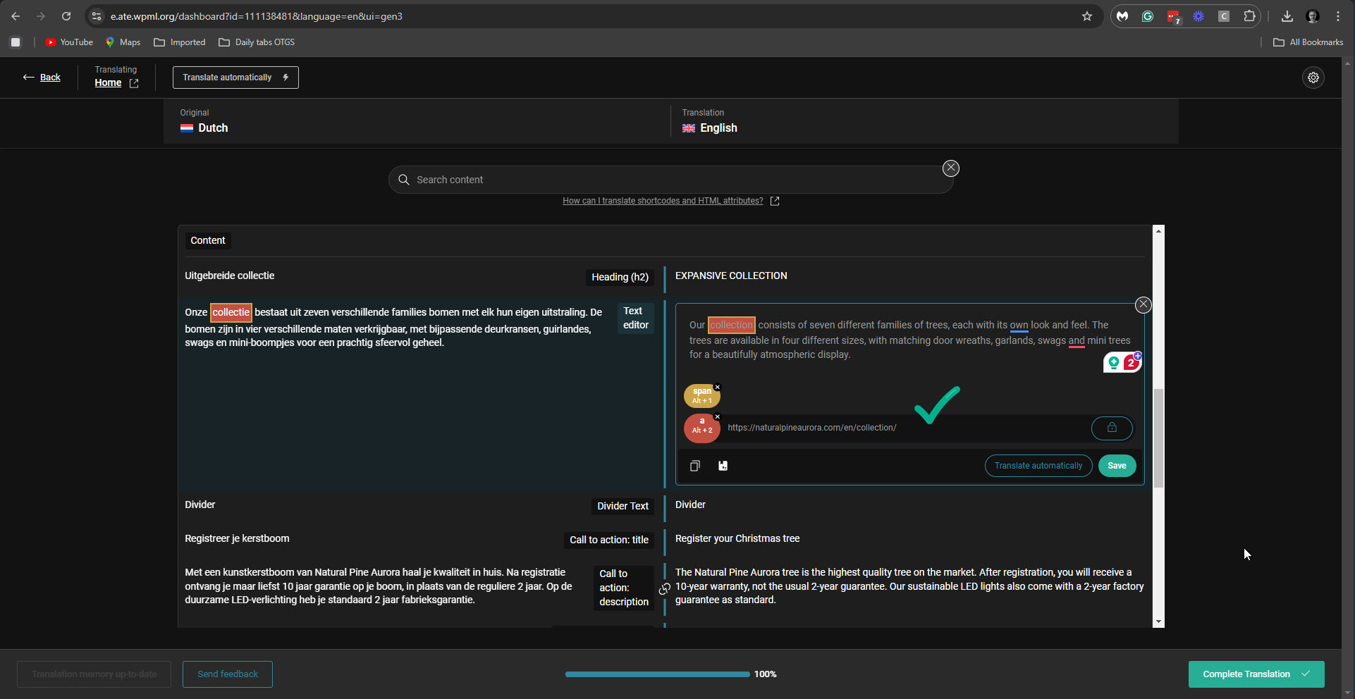

With the new version of the Advanced Translation Editor, the option to edit the link is also shown when editing a segment with links. Please see the attached screenshot. If you miss inserting the link in the field, a problem like the one you are facing can occur. The issue has been escalated to our developers. They will improve usability, and in the next version of the Advanced Translation Editor, users will be able to see if they missed a translation of a link. We will update you when the version with the fix is released.
