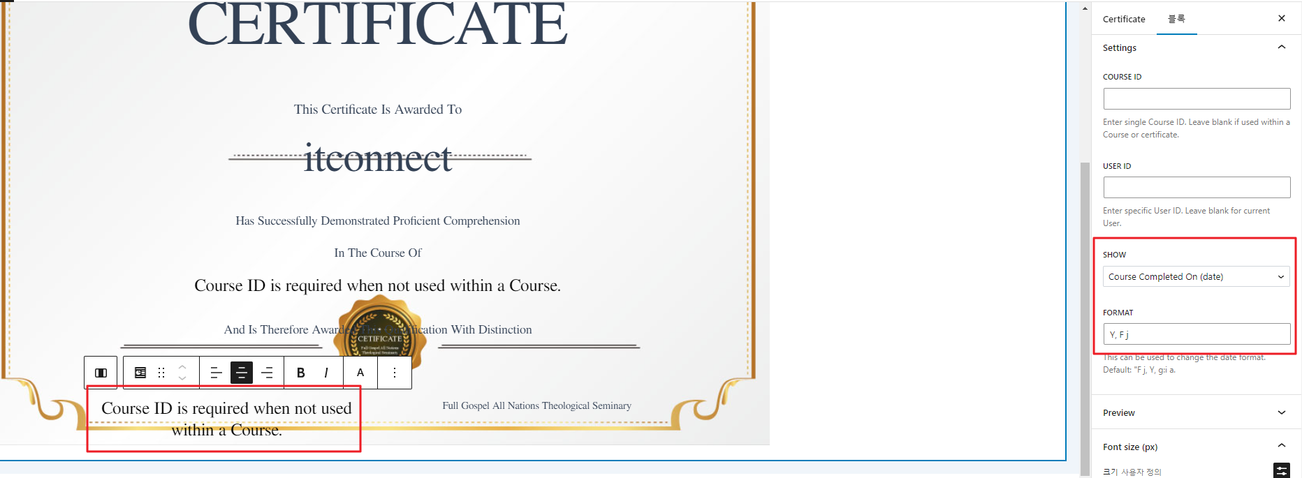

I made a certificate using LearnDash LMS - Certificate Builder.
A block of the certificate builder was created and set to the completion date of the course (Y, F j).
However, there was an error in displaying the course completion date data.
Leardash wants the month marked in English,
When WPML is activated, the space is displayed as a question mark as the month is changed to a number rather than English.
Disabling the 'WPML Multilingual CMS' plug-in makes it look good as 'February'.
When I activate the plug-in, it seems to change to a number and cause a display error.
I want to prevent the error of automatically displaying the date in numbers.
I have attached an image for each description.
Please check.
Thank you.
