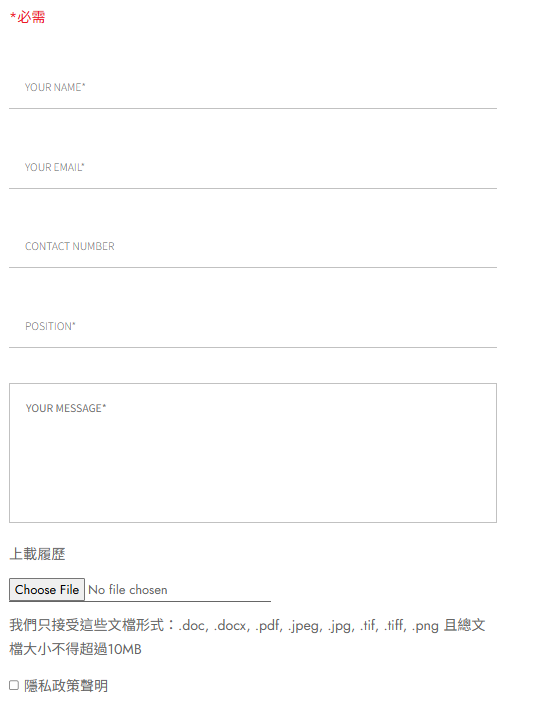

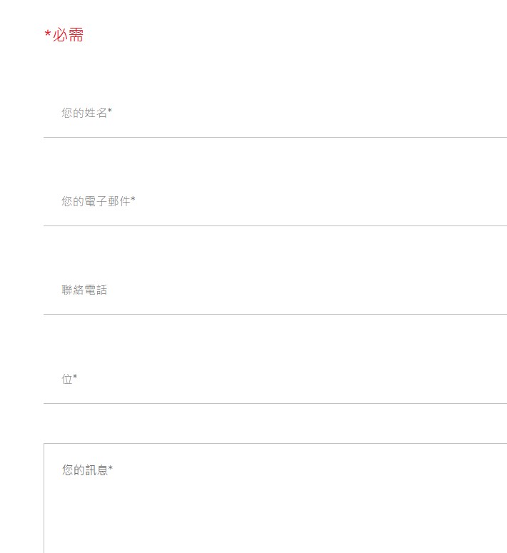

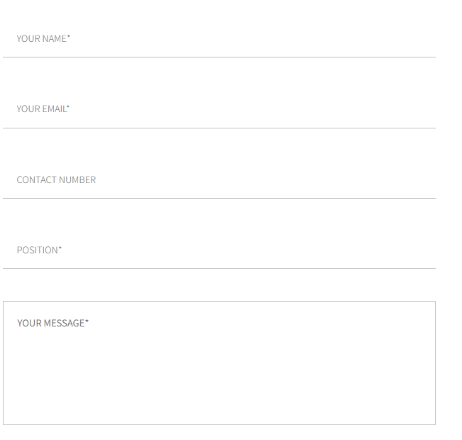

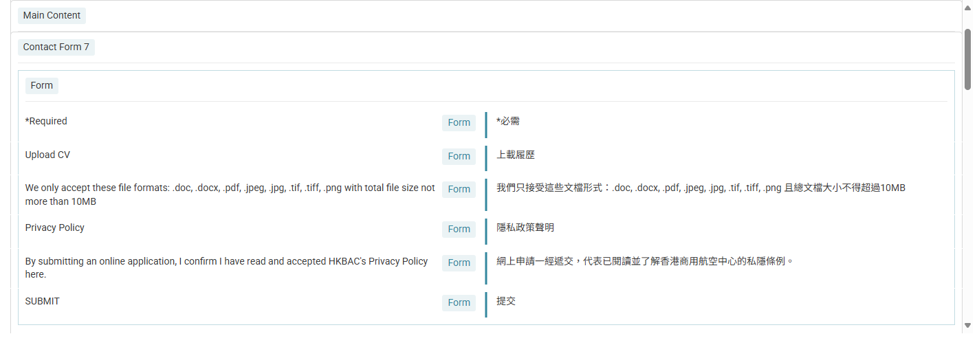

August 28, 2025 at 6:15 am #17353337
itH-7
no placeholder text is show in the translation page (eg: Your Name / Your Email / Contact Number / Position / Message)

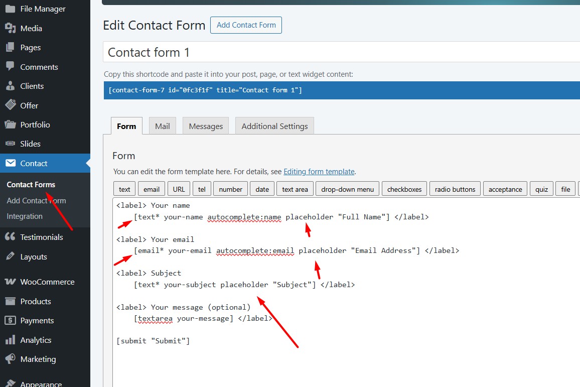

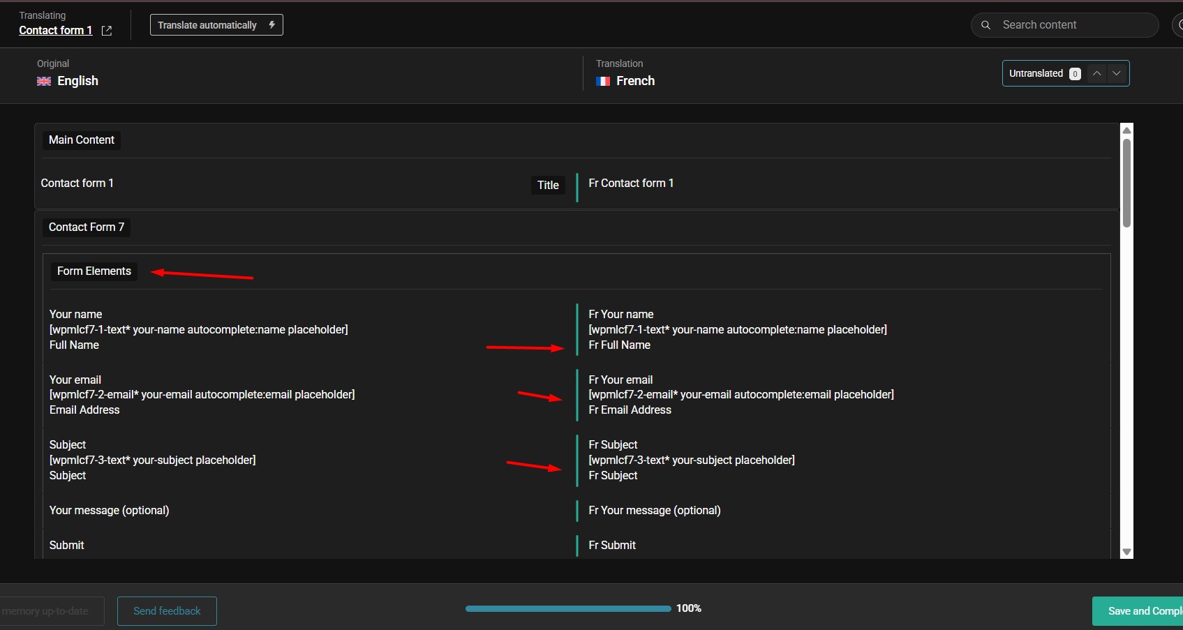

Thanks for providing the debug info and additional details. I can see the issue on this page: hidden link
I tried to replicate this issue at my test site but it works correctly there as you can see in the attached screenshots. To take a closer look at this issue, please provide temporary access (WP-Admin and FTP Login info) to your site (preferably staging site), so that I can look into your setup and debug the issue.
