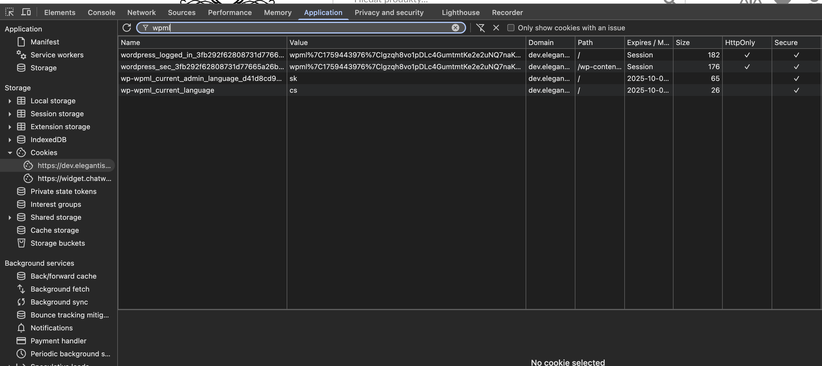

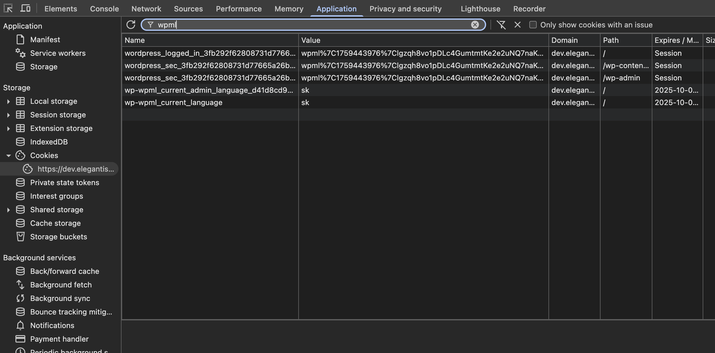

I am trying to use the WPML plugin, but I have found that cookies related to country, currency, and language aren't being set as expected. I deactivated all plugins except WooCommerce and WPML, and switched to the default Twenty-Twenty-Five theme, but the issue persists. I suspect the problem might be related to a new staging site created by copying the production site.

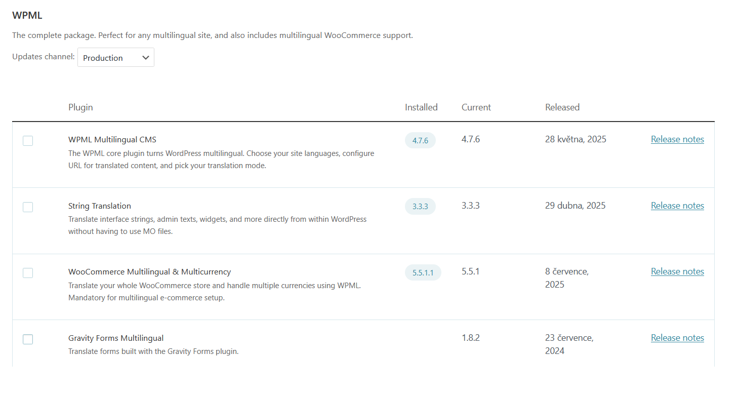

Also I am not able to update WPML plugins even in the Commercial tab. It shows me, that they are up to date, but they aren't - as you can see in the attached printscreen.
Cookies from WPML (country, currency, language) aren't set, even though they should be. I expected the cookies to be set on the first visit and then stored, but they aren't.
Why aren't the WPML cookies being set?
How can I fix the issue with cookies not being set on the staging site?

Please go to https://wpml.org/account/downloads/ , download the latest versions and update the plugins manually.
Once that is done, test the cookies one more time as it will help us to know that we are testing using the latest versions of WPML.

As I wrote to your AI, at the end I was able to update it from the dashboard, but unfortunately it doesn't solve the problem with cookies.

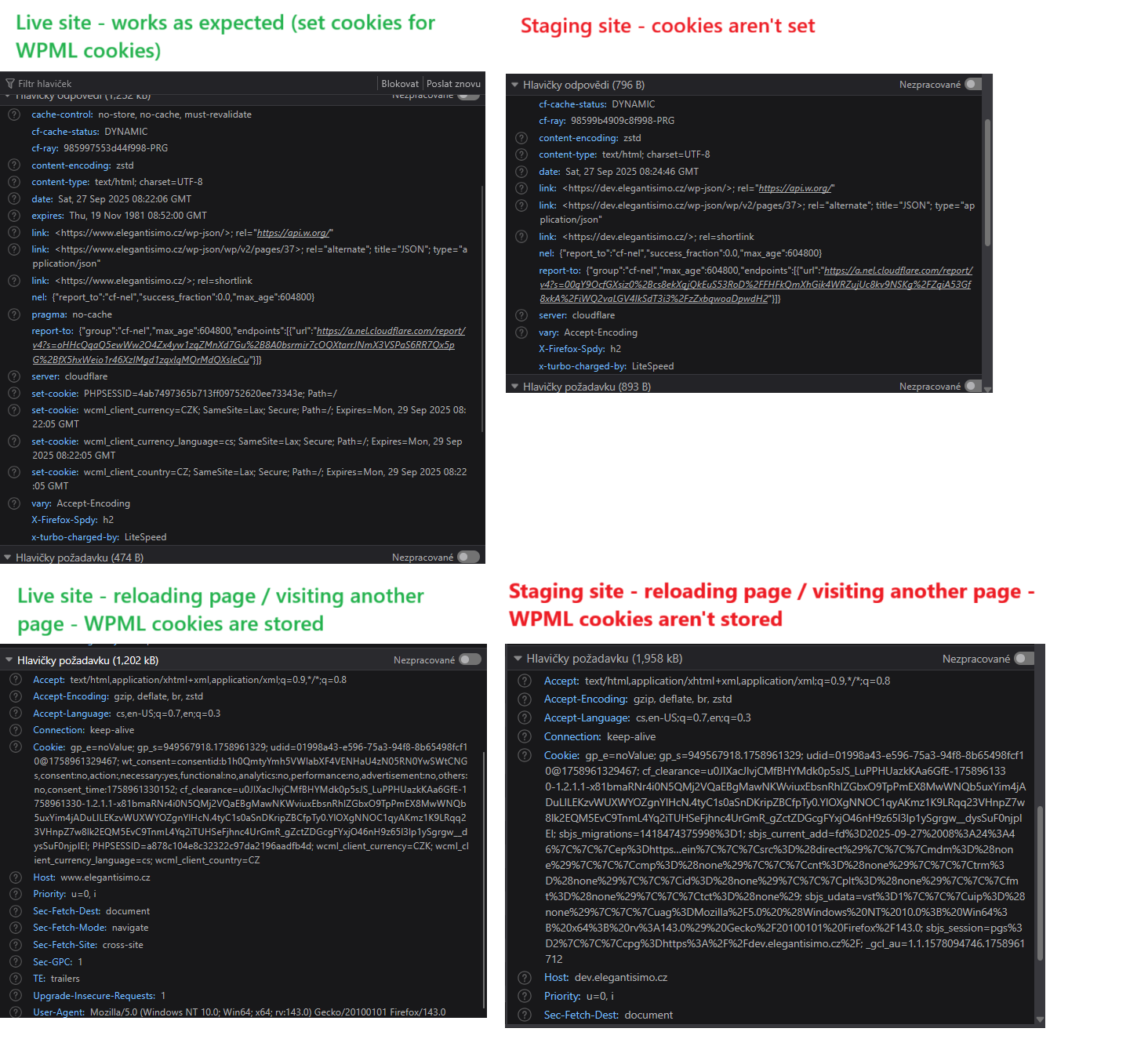

How I am testing it:
Anonymous mode → F12 → Network → visit page → Response headers
On the live site (where it works as expected) when I visit the first page WPML cookies are set and when I reload page / visit another page, the cookies are stored
On the staging site the cookies aren't set, so they can't be stored
You can see that in the attached printscreen and you can try it by yourself - live site - hidden link and staging site - dev.elegantisimo.cz
Can you help me, please?

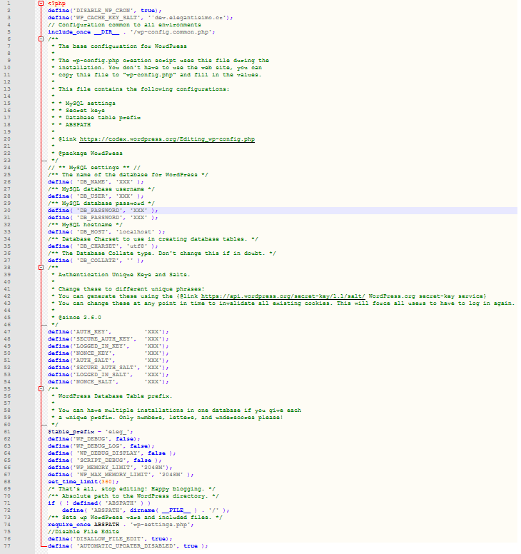

If possible, please review the wp-config.php of your live VS the staging site.
Do you notice any differences between them in regards to cookies?
Also, can you send me a copy of your wp-config.php (from staging) file but remove the sensitive data like salts and DB data?
Please leave the rest as it is and if you want you can check for
define('COOKIEPATH', '/');
or at least for the "COOKIEPATH" value.
Please let me know what your value is.

Except differences in db there are no other differences.
Cookiepath isn't there, so it should be ok.
I am sending you the wp-config - there are changed everything about db and salt to XXX, but nothing is deleted. I can't upload the php file, so I made a screenshot - I hope it's fine - there are just usuall things I think.
I can create you credentials to the staging and also create FTP access to staging (or global - so you can compare the live site and staging), so you can check it by yourself. Just let me know.

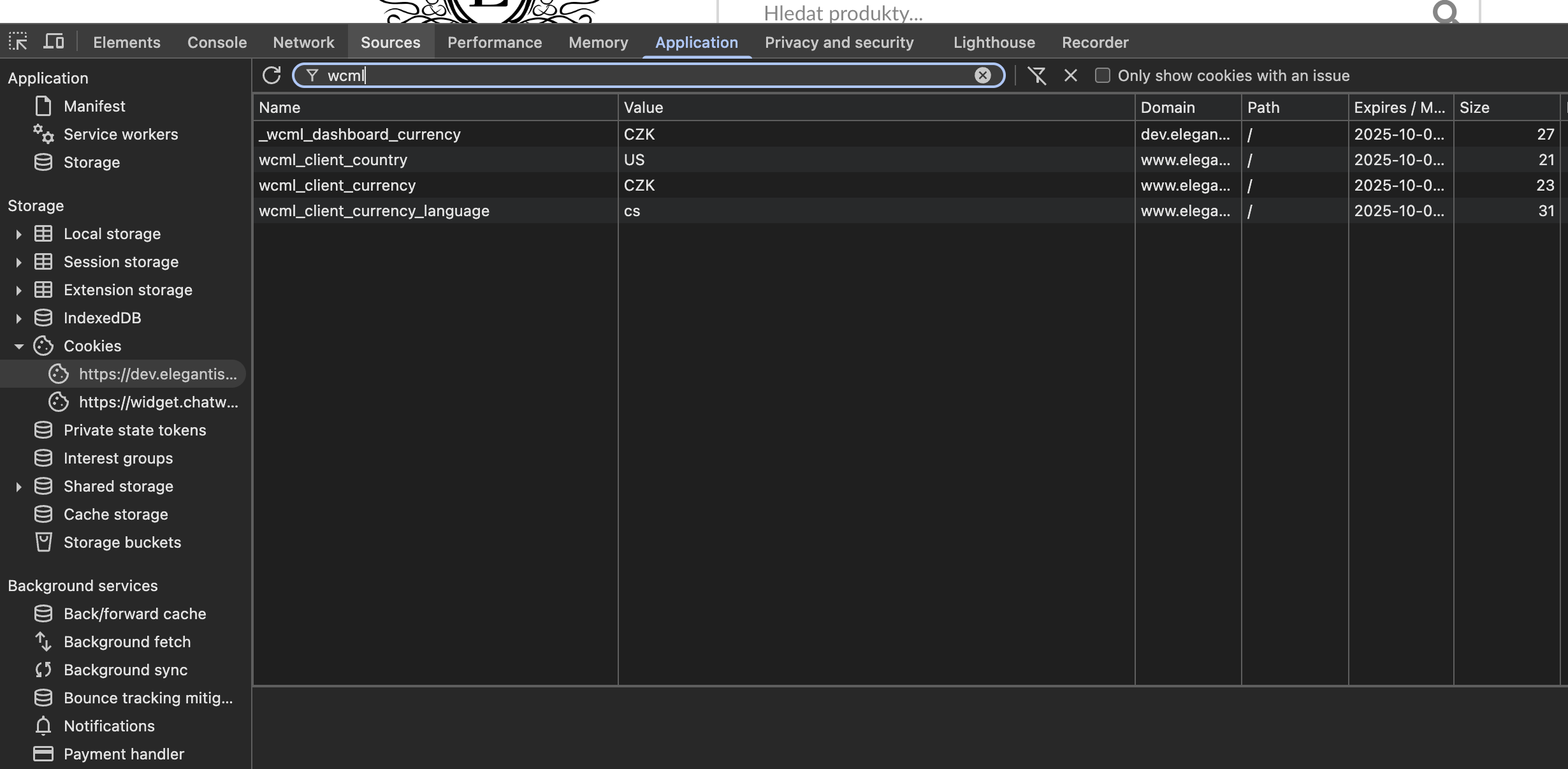

I made some tests and found out where is the „difference“ between live site and staging site and it is WP Rocket cache plugin.
With WP Rocket your plugin set cookies
wcml_client_currency
wcml_client_currency_language
wcml_client_country
in the first visit and then store them.
wcml_client_country is set according to location (because of geolocation settings).
wcml_client_currency is set according to geolocation and settings in your WPML currency plugin.
wcml_client_currency_language is set by deffault to „cs“, because on the live site the „sk“ language is hidden (as it was on the staging site) - I never understand, why this cookie is used, when there is only one language, but WP Rocket creates cache with this cookie automatically so I accepted it.
I thought, that this behaviour is deffault for your plugin, but as I can see, I was wrong.
