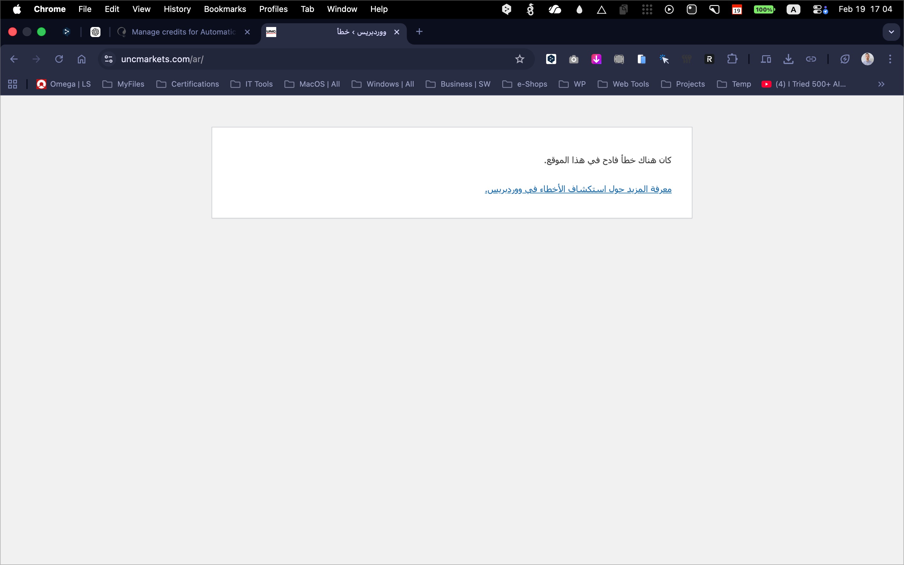

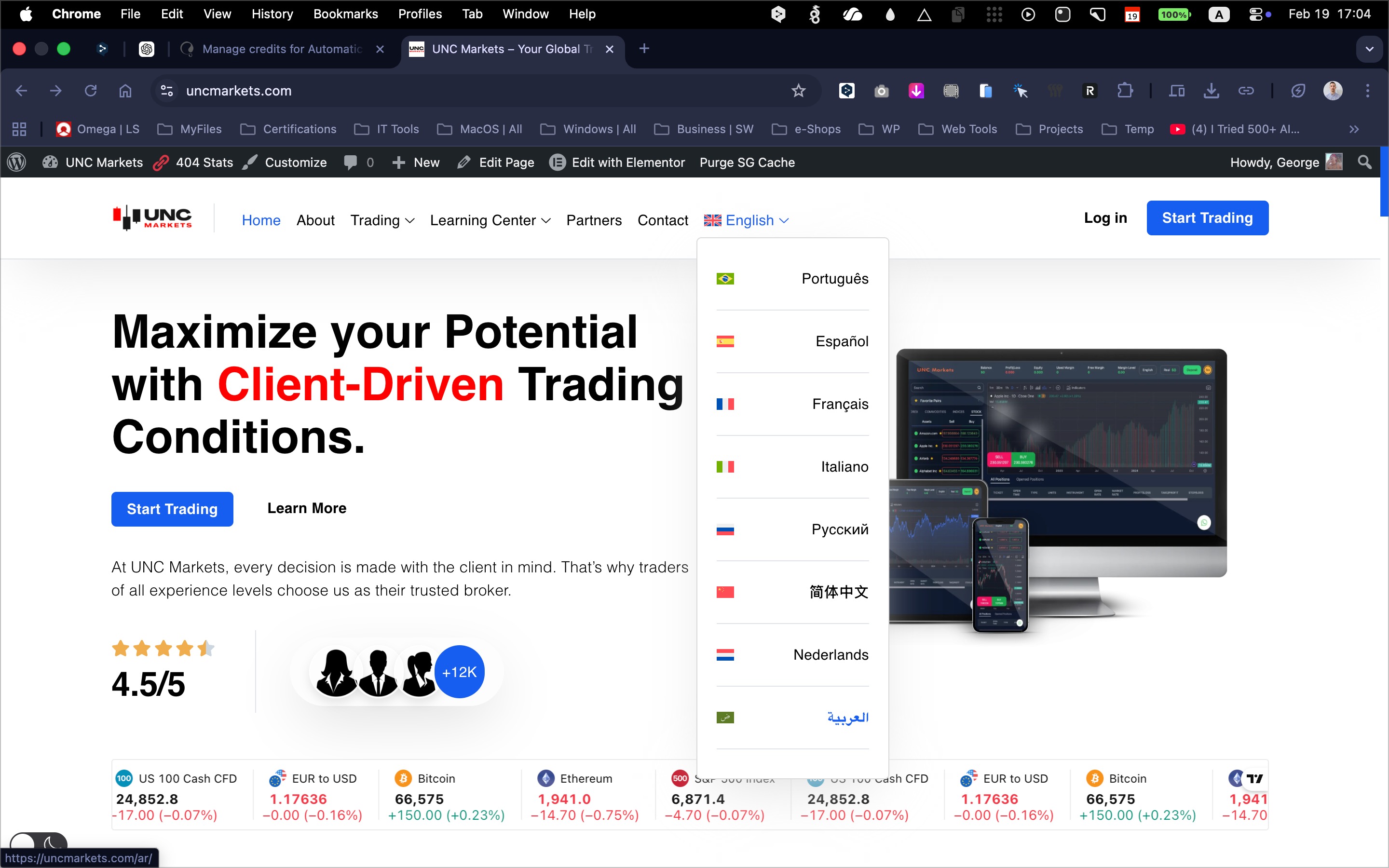

I am facing an issue while trying to add the Arabic language to my website:
When I enable Arabic in WPML, the website returns a critical error on the /ar/ URL.
To troubleshoot, I attempted to add Dutch instead, and it was added successfully without any issues. This suggests the problem may be specifically related to the Arabic language configuration.
Please note that the website is already running 7 other active languages without any problems.

I was able to identify the exact cause of the crash.
The issue was related to the Elementor string:
All %s
In WPML → String Translation (domain: elementor), the Arabic translation had been saved as:
الكل %س
The %س (Arabic letter) replaced the correct %s placeholder, which caused PHP 8.2 to throw a fatal error:
ValueError: Unknown format specifier
After correcting the translation to:
الكل %s
(using a Latin “s”), the issue was fully resolved and the Arabic version loads correctly.
