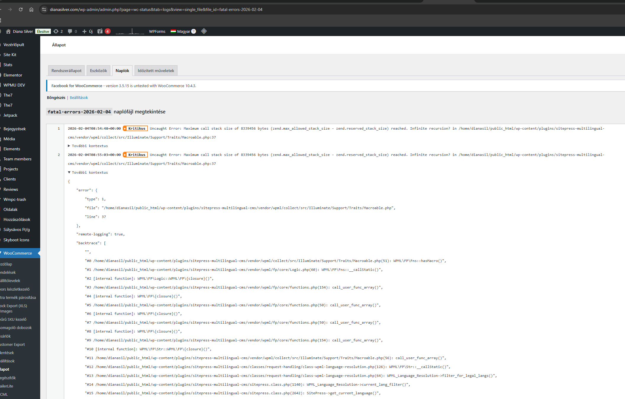

I have added and saved the required PHP 8.3 settings on both websites via cPanel (MultiPHP INI Editor):
zend.max_allowed_stack_size = 256K
zend.reserved_stack_size = 48K
After applying the changes, I cleared all caches and retested, but the critical fatal error / infinite recursion issue still persists.
Could you please advise on the next troubleshooting step (e.g., what logs or debug information you would like me to provide)?
Best regards, Balazs
