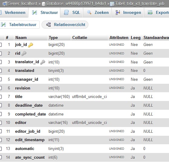

this is the ticket. I checked the debug log and seems your database is corrupted and missing some columns.
Can you please check and compare and make sure it has all columns as in the image share? If you can create them, if not let us know and I will check further with our 2nd tier.

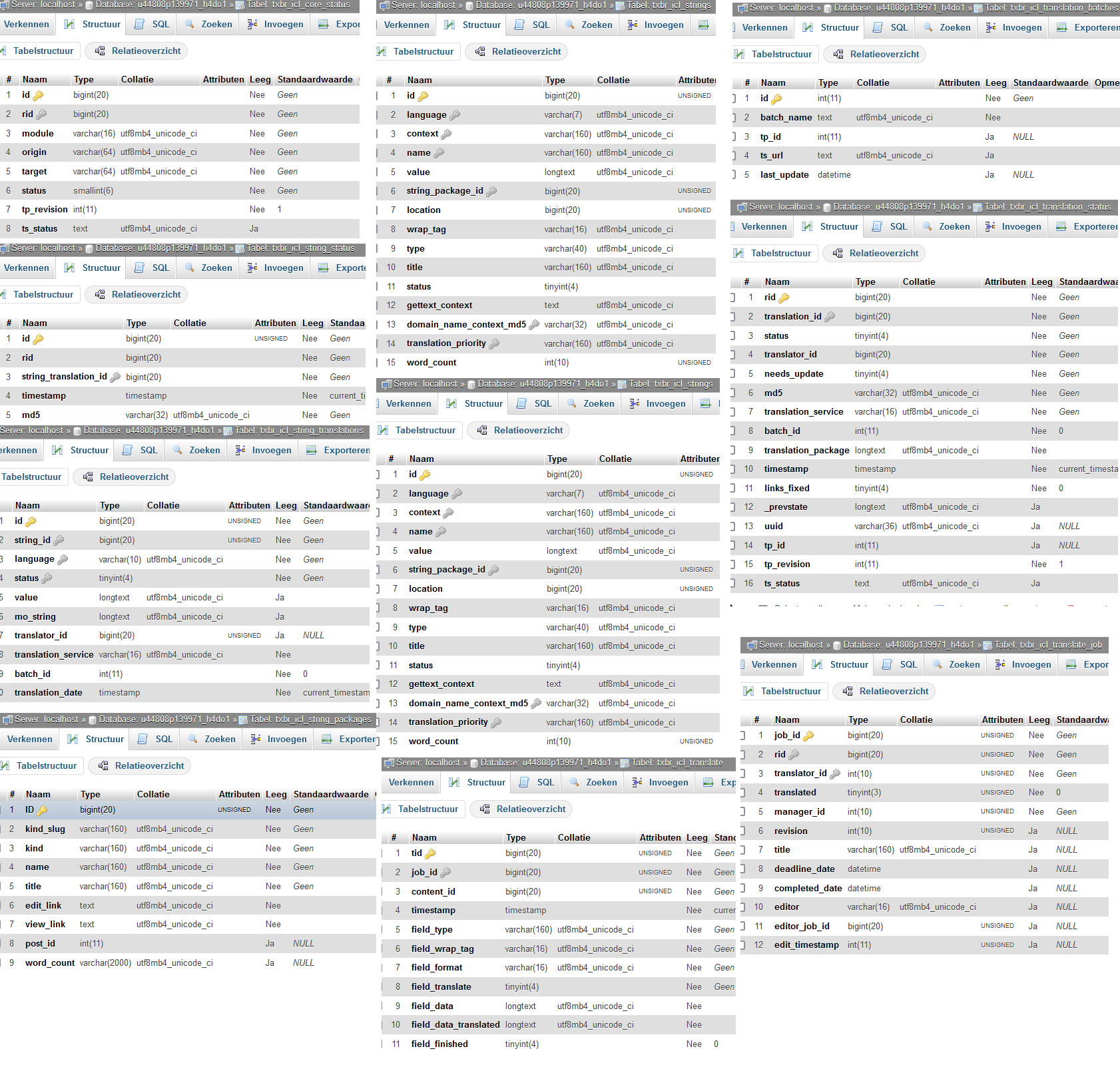

ingeS-3
I checked the database, both the live site and the staging copy. As far as i was able to see all table values are present with correct name and type. I made screenshots and collected them in a picture, added as a attachment to this message.

December 17, 2024 at 1:08 pm #16521868
Dražen
thanks, I have escalated this ticket to our 2nd tier to further check.

Some are still missing tables, this SQL should do the job:
ALTER TABLE txbr_icl_translate_job
ADD COLUMN automatic tinyint(3) unsigned DEFAULT 0,
ADD COLUMN ate_sync_count int(6) unsigned DEFAULT 0;
You can apply yourself or let us know if you have a backup and is okay for us to apply the same.

ingeS-3
Goodmorning,
I've added them to the table. But unfortunately i still get the same crit error when trying to start a new translation.

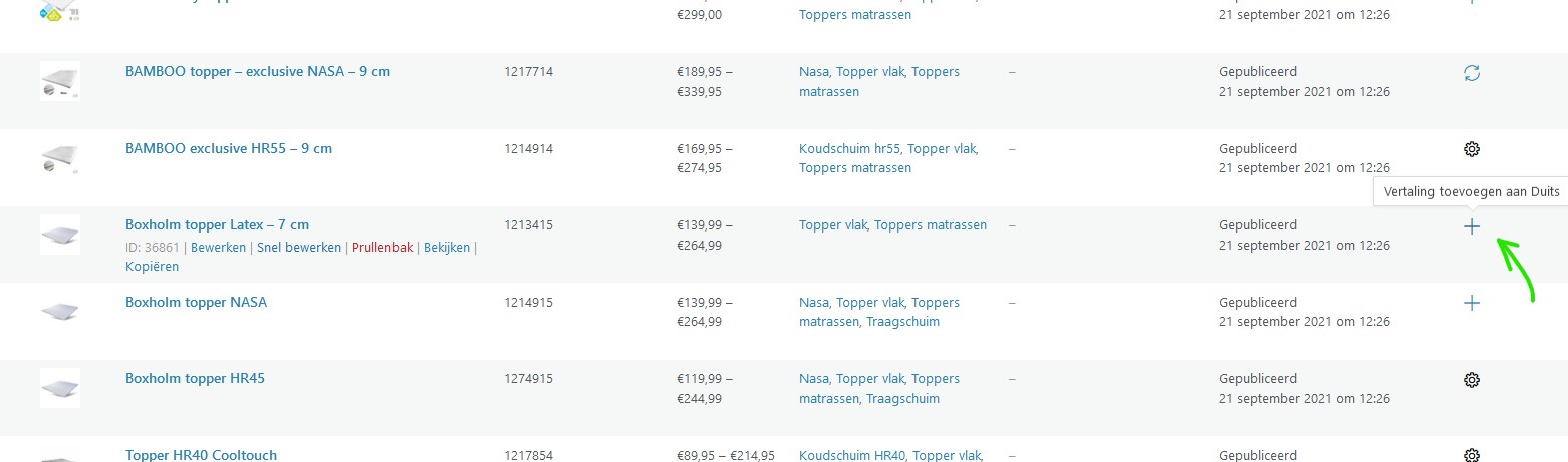

December 18, 2024 at 9:19 am #16524833
ingeS-3
When i hit the + i still get a crit error (i added screenshot attachment). When i hit a product with the two round arrows i go to the "translations in queue" page thats empty.

December 18, 2024 at 9:34 am #16524903

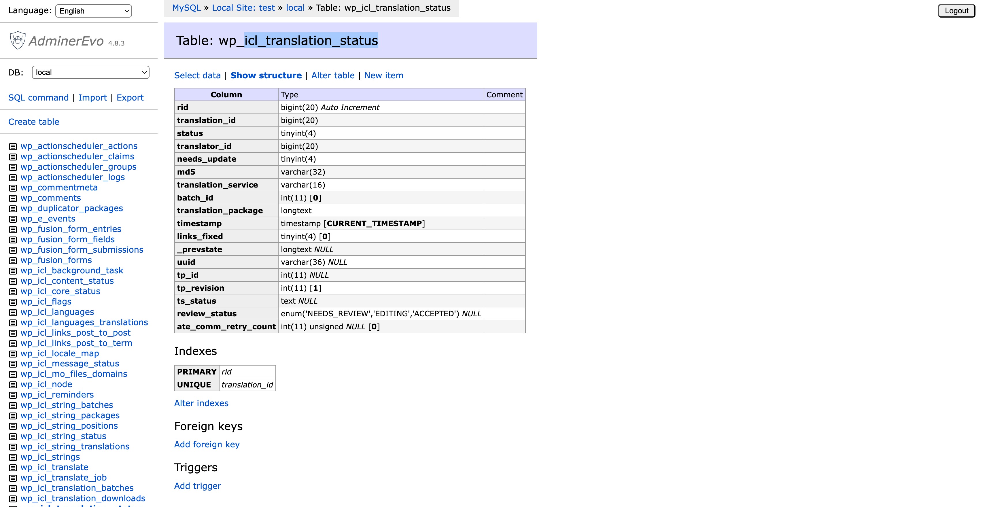

Dražen
I just tested and it works fine for pages that use WP editor. Make sure your user is a translator and you make a small change to the default language page and then click.
For others that are not working I see still missing tables from error, please check the debug log and create them, or let us know if it is okay for us to adjust it for you.
For example, icl_translation_status is missing some tables.
Let us know how it goes.

December 18, 2024 at 9:47 am #16524975
ingeS-3
It's ok for you to add the missing tables if you can, thank you.

December 18, 2024 at 11:05 am #16525346
Dražen
thanks, please check now it should work fine, I was able to open the WPML editor.
