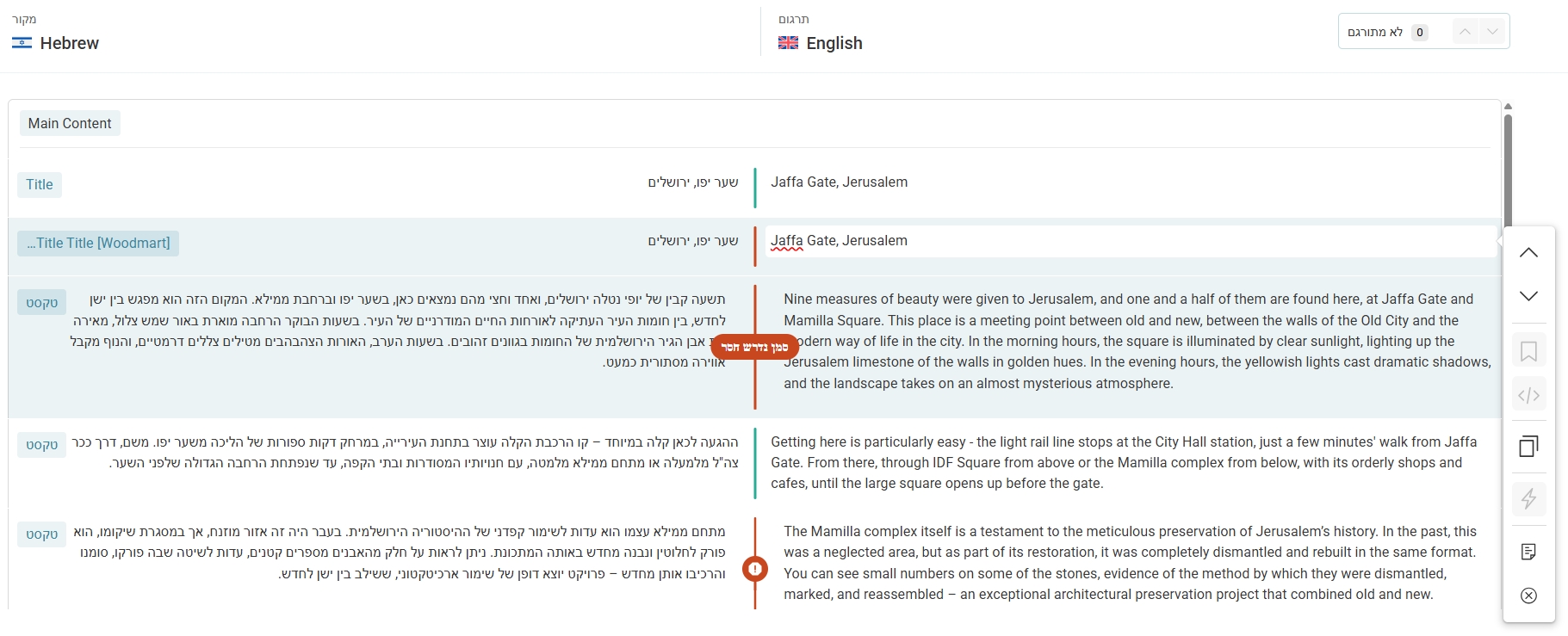

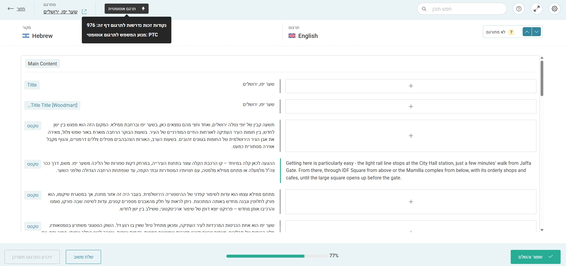

Hello WPML Support,
I’m experiencing a critical issue with WPML after making a very small update (just a few words) to existing pages.
The issue occurs on the following pages:
Immediately after the update, several paragraphs disappeared from the translated version. This is not a content change on my side – the translated content already existed in the system and was previously complete.
In addition, WPML now requires automatic translation credits for content that has already been translated previously. This appears to be incorrect, since no new content was added that should require new credits. I also want to clarify that I do not use bulk automatic translation.

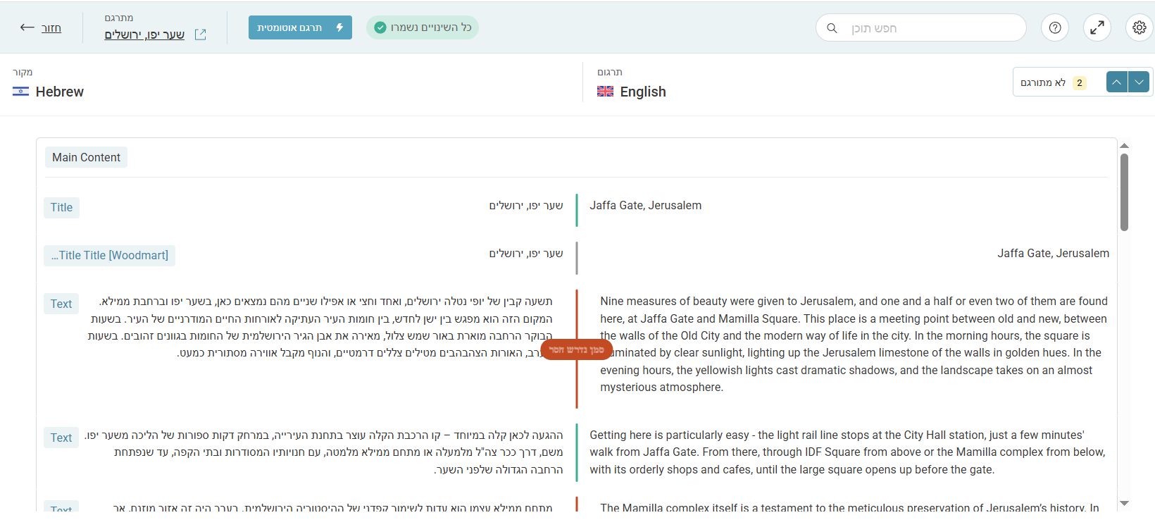

When I try to fix this manually in the Advanced Translation Editor, I encounter blocking errors:
* I am unable to insert markers due to an error.
* Even in paragraphs where I do not use markers, the system shows an error stating that a required marker is missing.
* Because of this, I cannot save the translation at all.
This leaves the pages in a broken state, with missing translated content and no way to restore or edit them.

Hello there,
I made a small change on the original language and I couldn't see the market issue. Please check and confirm.
Regarding the translations loss, I see there has been changes to content two days ago here: hidden link
Lets take one example, previously you translated
תשעה קבין של יופי נטלה ירושלים, ואחד וחצי מהם נמצאים כאן, בשער יפו וברחבת ממילא. המקום הזה הוא מפגש בין ישן לחדש, בין חומות העיר העתיקה לאורחות החיים המודרניים של העיר. בשעות הבוקר הרחבה מוארת באור שמש צלול, מאירה את אבן הגיר הירושלמית של החומות בגוונים זהובים. בשעות הערב, האורות הצהבהבים מטילים צללים דרמטיים, והנוף מקבל אווירה מסתורית כמעט.
To
Nine measures of beauty were given to Jerusalem, and one and a half of them are found here, at Jaffa Gate and Mamilla Square. This place is a meeting point between old and new, between the walls of the Old City and the modern way of life in the city. In the morning hours, the square is illuminated by clear sunlight, lighting up the Jerusalem limestone of the walls in golden hues. In the evening hours, the yellowish lights cast dramatic shadows, and the landscape takes on an almost mysterious atmosphere.
The original text is modified as a reason the translation memory is not applied, I hope this make sense, if you feel there are other texts that was translated but showing untranslated, can you provide an example so I can check?
Look forward to your reply.

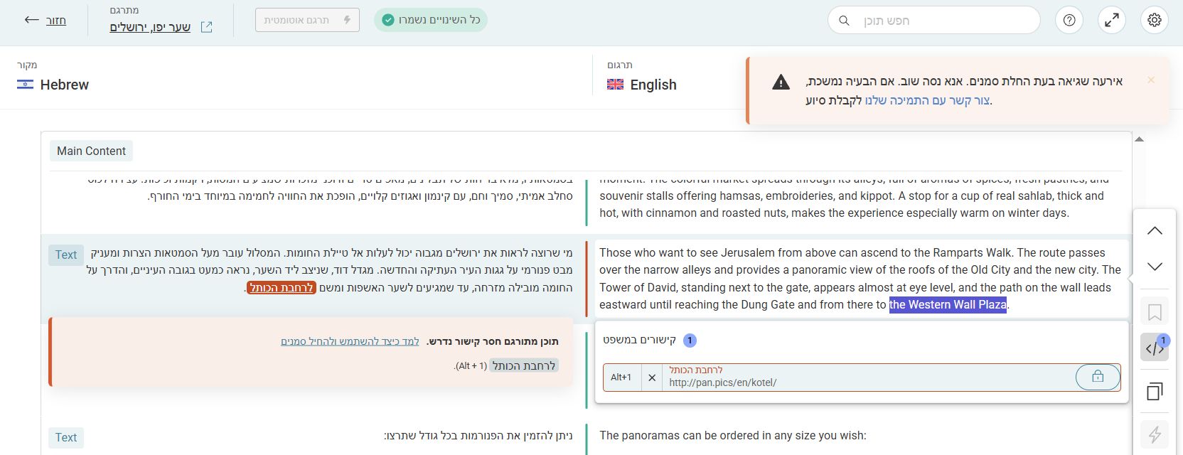

April 20, 2026 at 7:02 am #17979477
motiP
Hi, the marker problem REMAINS. See image.
Also, the missing paragraphs DOES NOT make sense at all. If I change a word I do not expect the whole paragraph to disappear and definitely not other paragraphs.

April 20, 2026 at 8:15 am #17979790
Shekhar Bhandari
WPML Supporter since 03/2015
It looks like when you’re copying the content, multiple markers are being included. Try pasting the content into the browser’s address bar first, then copy it again—this should help clean it up.
Regarding translation memory, it doesn’t work on a per-word basis but per segment. When you translate content, each segment is saved in the translation memory. If the same segment is used again, the stored translation is applied. Hope this clarifies things.
Thanks.

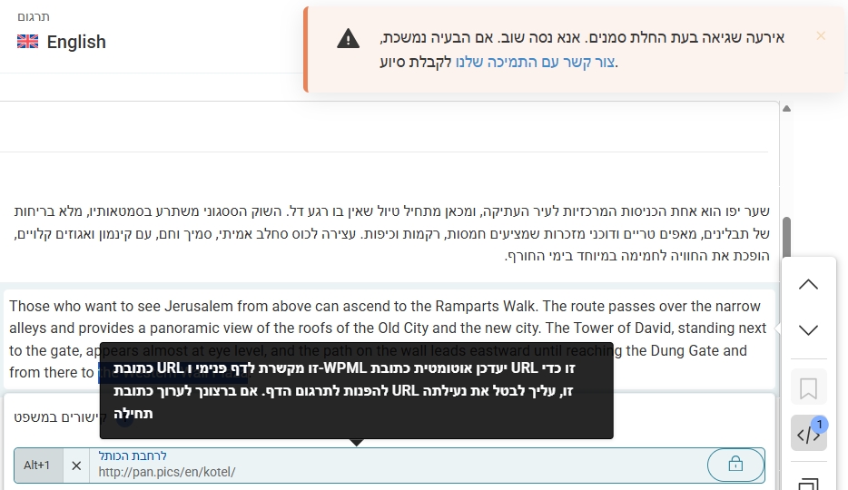

April 20, 2026 at 8:43 am #17979862
motiP
Yes, the missing markers are probably because of copied stuff, once it went through notepad it was fixed.
However when I do want to enter a marker, it still encounters the same error. see image.
April 20, 2026 at 8:48 am #17979898
Shekhar Bhandari
Looks like the translated texts has wrong markers again, I copied and paste it now I can apply markers easily.
