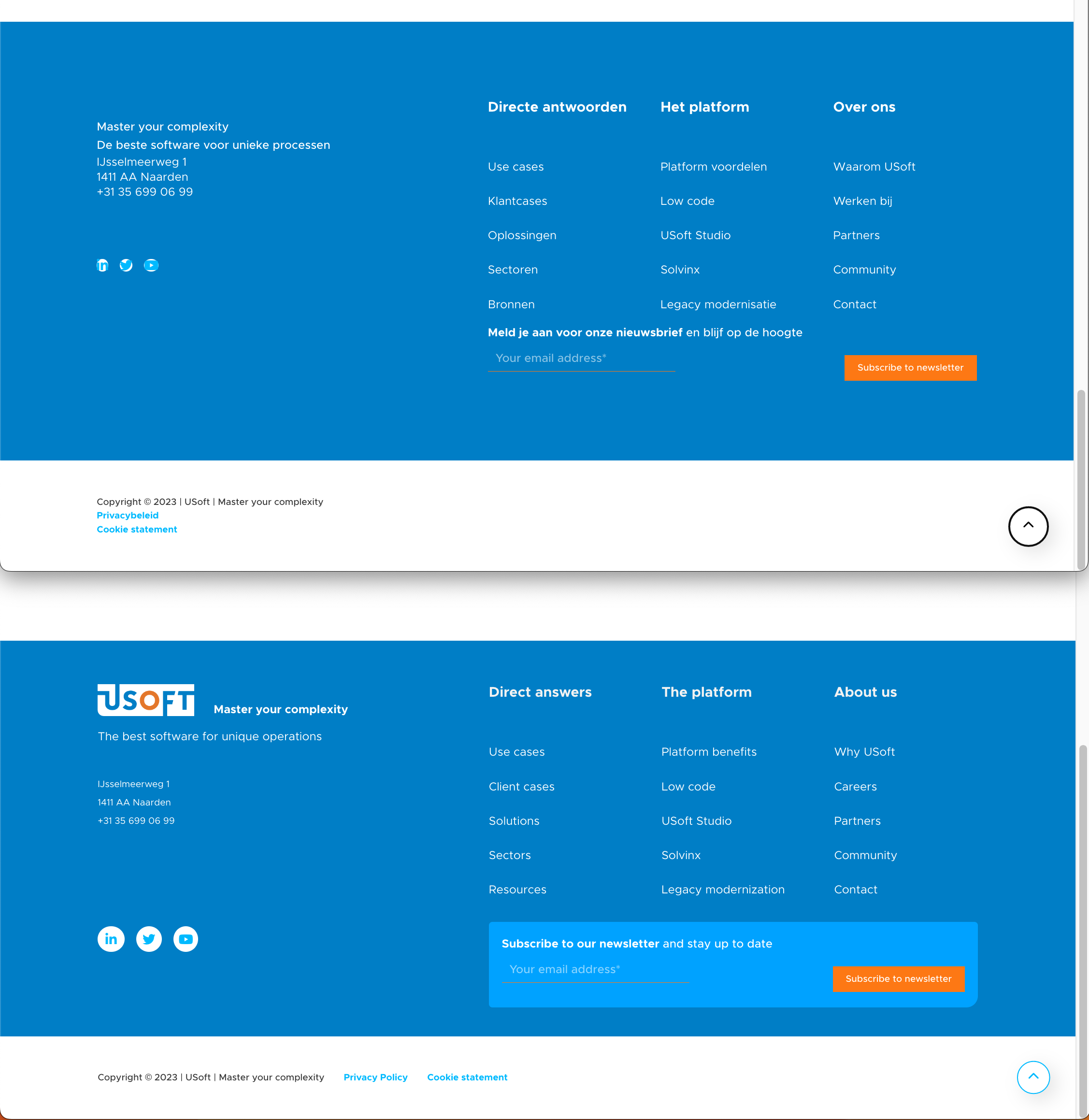

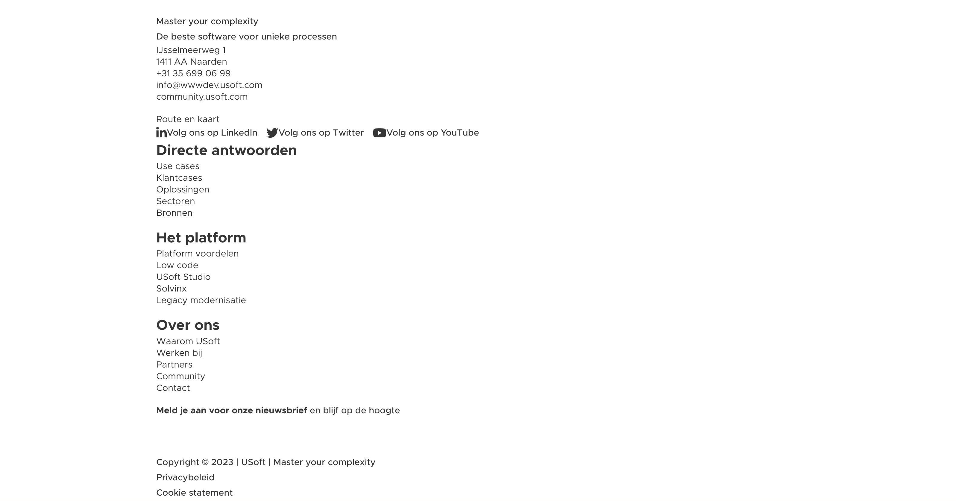

I’m currently translating a website from English to Dutch, and see a lot of css related issues, especially on templates like the header and footer. See the pictures of the footer. I translated the template where I was careful to only translate the actual text.
1. Picture of front end: bottom the original English version, top the translated Dutch version

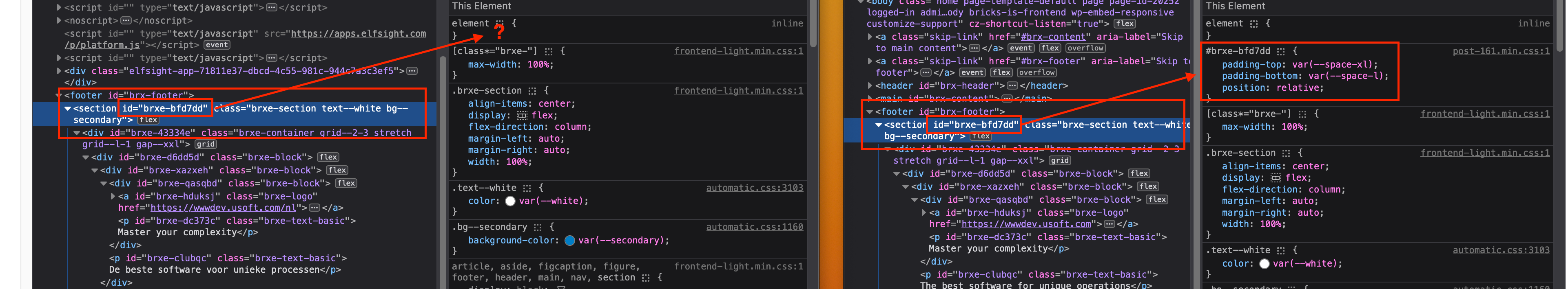

2. Picture of source: left the Dutch version, right original English, where you can see that a piece of css is missing.

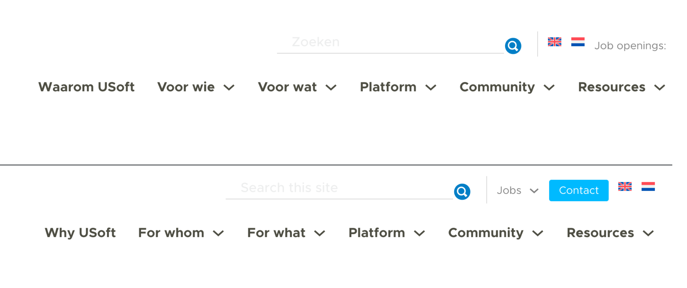

3. Picture of the header, where in the Dutch version (top) a piece of the global menu is missing
The issue is pretty random: most of the css is OK, but some is off because there are changes in the HTML-structure and some css is simply gone.
It seems random, but possibly we are overlooking something.
We’re using Bricks as page builder.

November 2, 2023 at 2:50 pm #14718029
Marsel Nikolli
Thank you for contacting WPML Support.
It would be helpful if you can help me out with some more information related to:
1- How are you creating the header for example and how are you translating it
2- Does this issue happen randomly on the same page or just randomly in different pages
I also noticed from the picture of source you sent that on the English version there is a CSS file created (post-161.min.css), do you know how this file is being created (is there any custom CSS code being applied somewhere)?
It would appreciate if you can you send me 1/2 links were the issue happens so I can check.
Looking forward to your reply,
Marsel
November 3, 2023 at 3:26 pm #14726933
vincentG-26
Hi Marsel,
Thanks for your reply.

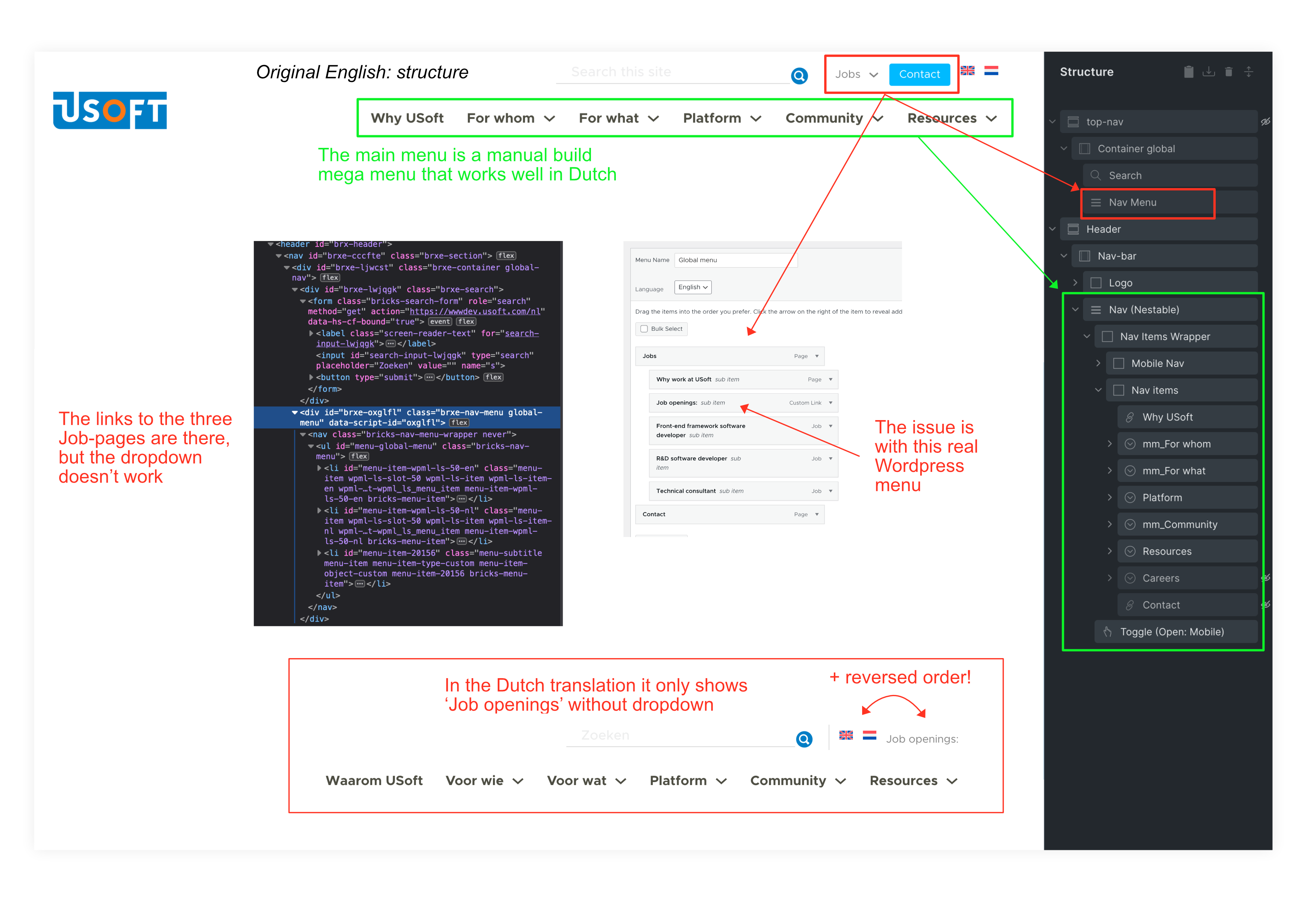

Enclosed a picture with some screenshots and explanation of the header. I hope is isn’t to complicated.
As you can see, the header has 2 menu’s. The problem occurs with the top-menu, which contains a classic WP menu. The main menu is hand build and works fine.
Because it’s a header, the problem occurs on all pages. The same applies to the footer.
The website I’m translating isn’t on a live website, so I'm not sure if i can give you access.
I'll have a look at that css-file, but the source code shows that it might be also html-related. See also the first screen I send you of the footer.
I hope this helps to clarify something.

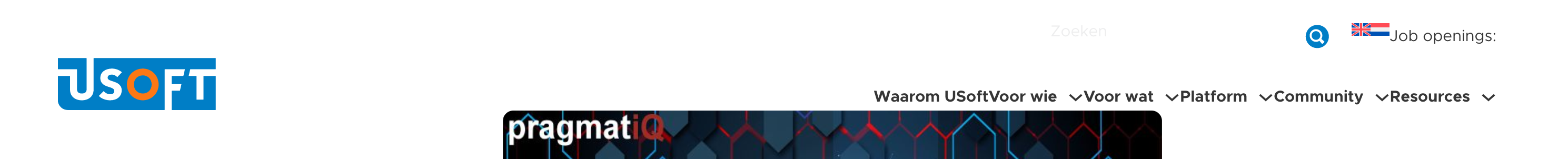

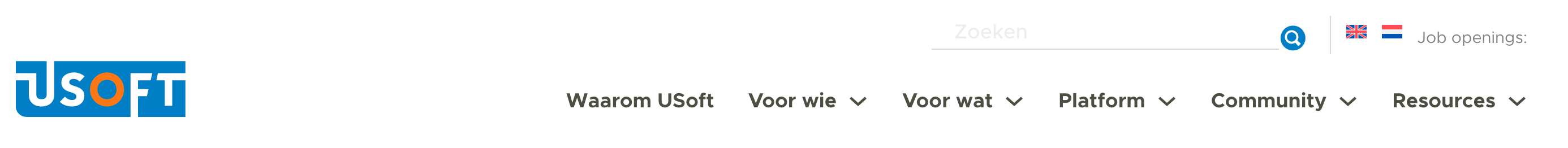

I disabled all plugins except (obviously) the WPML ones, and this is what I got. I took a screenshot of the header and footer, where you see that most of the css is gone (because I use ACSS) but the effect on the menu for example is the same. I then re-activated only ACSS, and that fixes the global menu for the most part.
But compare that to the screens I sent you, and the effect is till the same. Which suggests that it is not a plugin incompatibility.
