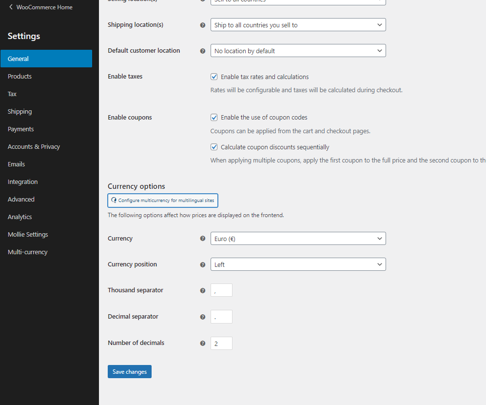

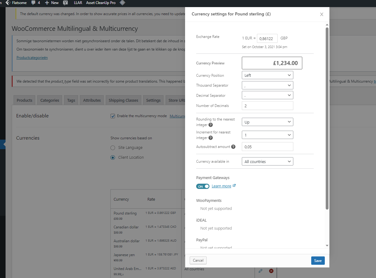

I'm experiencing some difficulties with my Multi Currency set-up. When I switch currencies, the currency sign stays on €, euro. Even though the prices do change, but customers still see the Euro sign.
If the shop is in Euro, the euro sign is on the left, when I switch to USD or CAD, the euro sign goes to the right.
I've already consulted multiple posts on this forum, from where I've changed the position to the left in Multi Currency as you can see in the picture. I've also gone to WooCommerce - Settings - General and such, but it's still not functioning correct.
